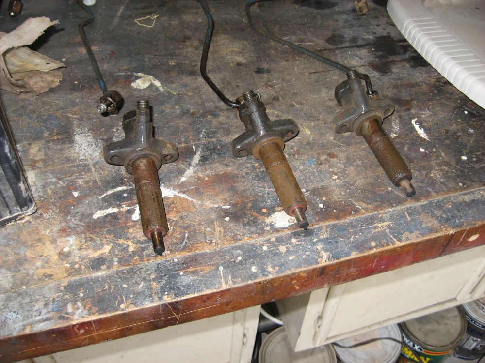

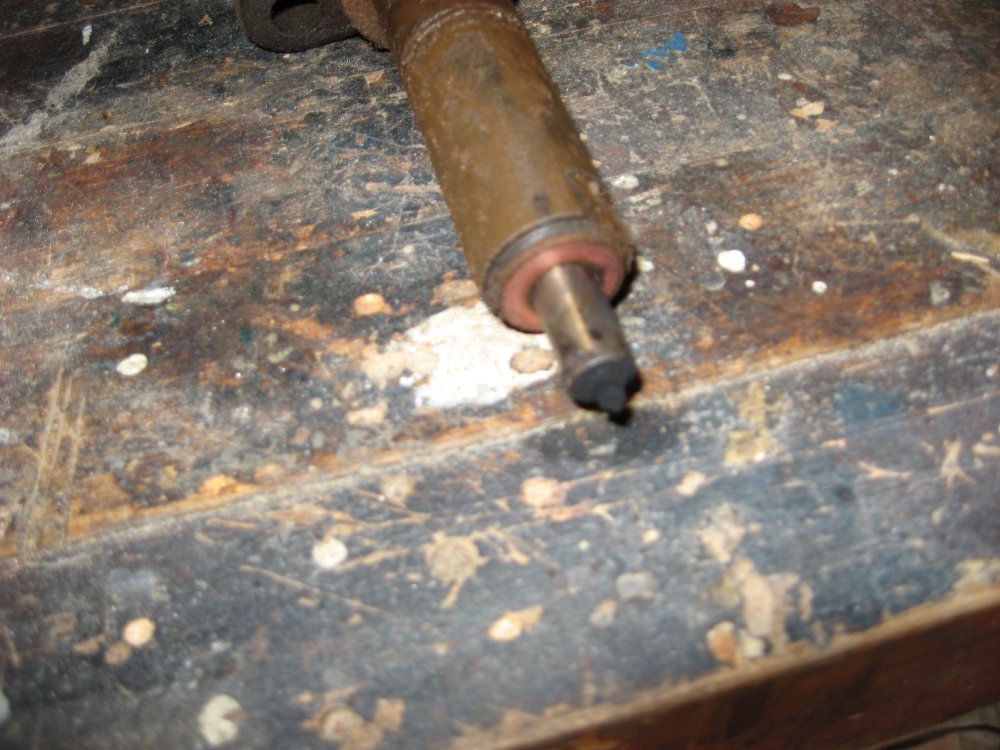

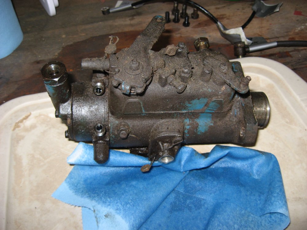

I set the lash yesterday. One exhaust valve was set at .0030 when it should have been at .0017. Several other valves had no clearance at all. I am taking the injectors and pump off today to have them checked tomorrow. I don't have much confidence that this is going to fix the starting and smoking problem, but it can't hurt.
   / Ford 3000 Cylinder Sleeves?
#26
I took the injectors and pump off today. Q: dooes one need to keep track of which injector came from which cylinder? The tip of the injectors were carbon fouled. Is this typical? I'll take everything into the shop Monday for inspection. Can anyone tell me how to check the compression on a diesel. I have a pressure guage that I use on my cars and boat, but it maxes at 300 psi while the tractor calls for 420-510 psi. Also, my guage screws in and the injector port has no threads.
Thanks.
