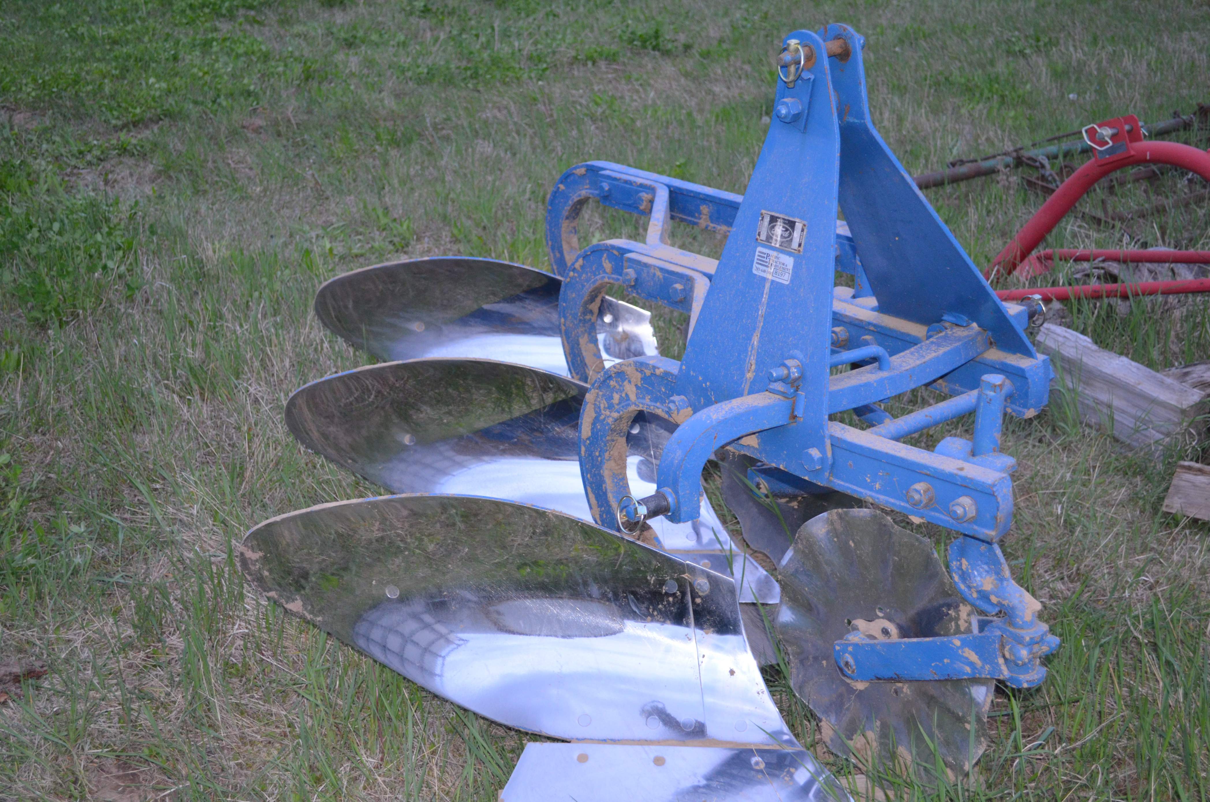

Per your own measurements, 14 inches center to center of the beams, you have a 14 inch plow. You do NOT measure the length of the shear (or share) to determine the size of your plow.

I have owned a three bottom 101 and it will be a good match for your tractor. Sure looks a 14" and you would measure between the beams as you have done or measure the width of the cut. I might have a parts book and an owner's manual for the 101 if interested. It will take a little while to set up but once that's done you're good forever.

I have a operators manual. A parts book would be a great help. I am not sure if I will like the Big RED Beast with narrow tires. I will have to go from max width...........the most narrow width. Something like 15 inches total. Which means swapping the rims and wheels around.

You probably don't have to swap the wheels. Maybe first try swinging the plow offset a bit. This plow is very versatile and at worst maybe wheels in the middle range. I pulled one on an 85 HP tractor with 18.4 x 34 tires and I also pulled it on a 42 HP Ford 2110 compact tractor with no wheel adjustments to either. I'll look for the book.

I just measured my rear tire center to center and also inside to inside. My rear tire might ride wide in the furrow, but according to the Ops Manual...............I am within 2-3 inches. So swinging the plow a little off of center, with the stabilzers, just might work. I'll play with it after I finish my fencing project. Worse case is to sale the plow and get 4 bottom that would pull with the drawbar.
