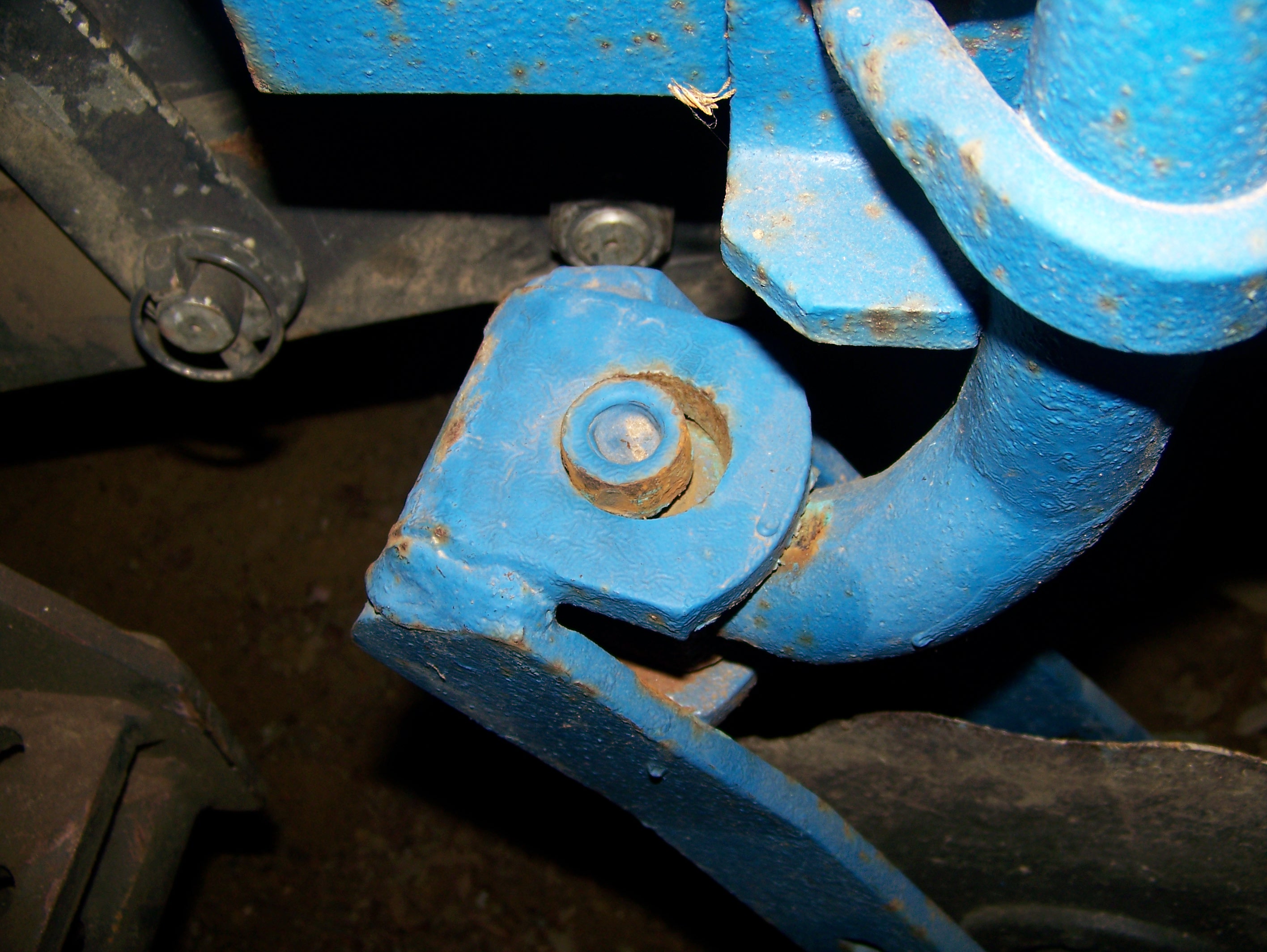

The right coulter's shaft pivot looks like it needs at least, a new spacer/bearing under the bolt. I haven't pulled that off yet.

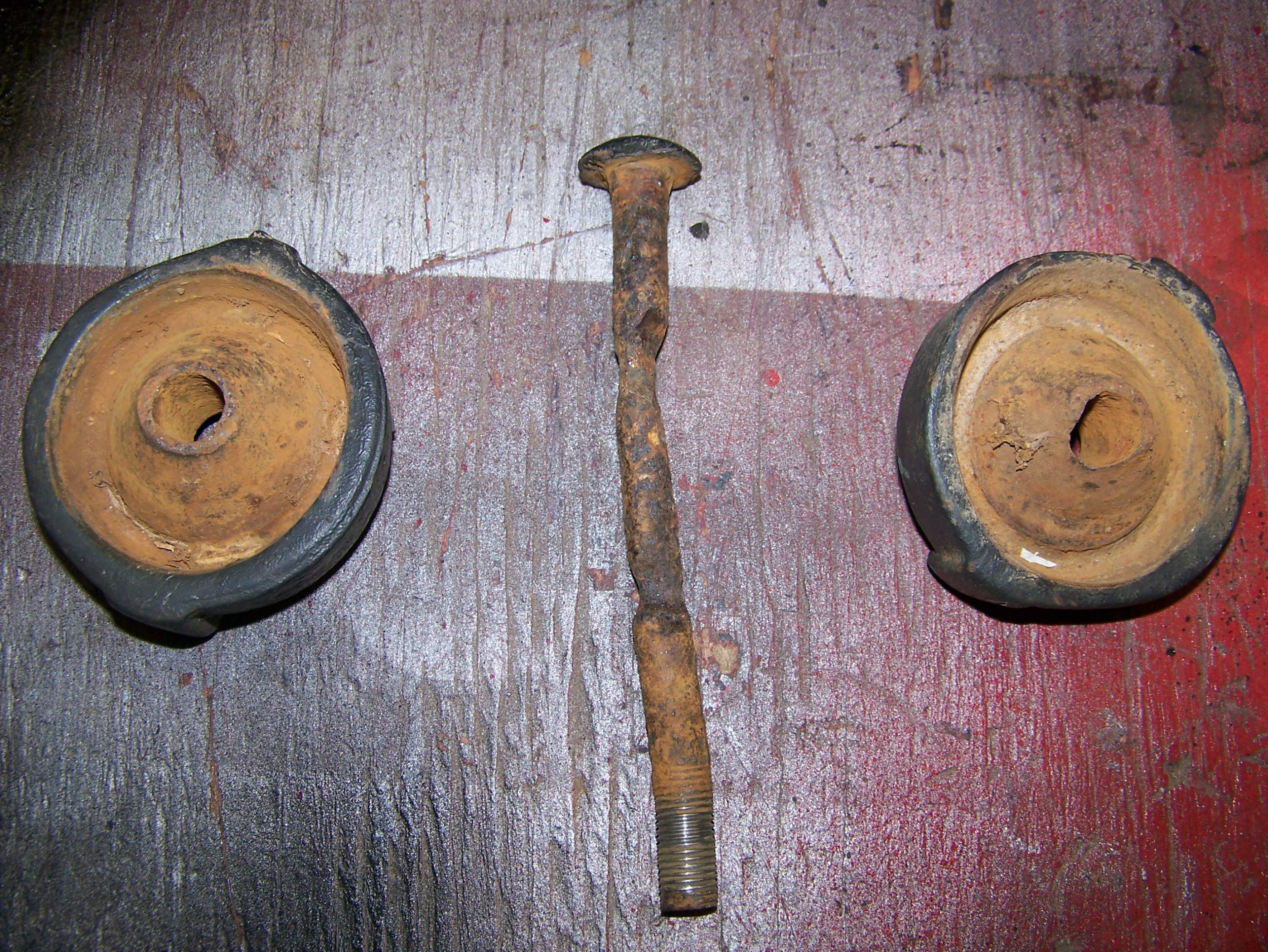

Coulter bolt and bearing halves. This carriage bolt is $17 something from Messicks. The worn bearing half is on the right. 4-12-15 Coulter Bearing Halves and Bolt.jpg

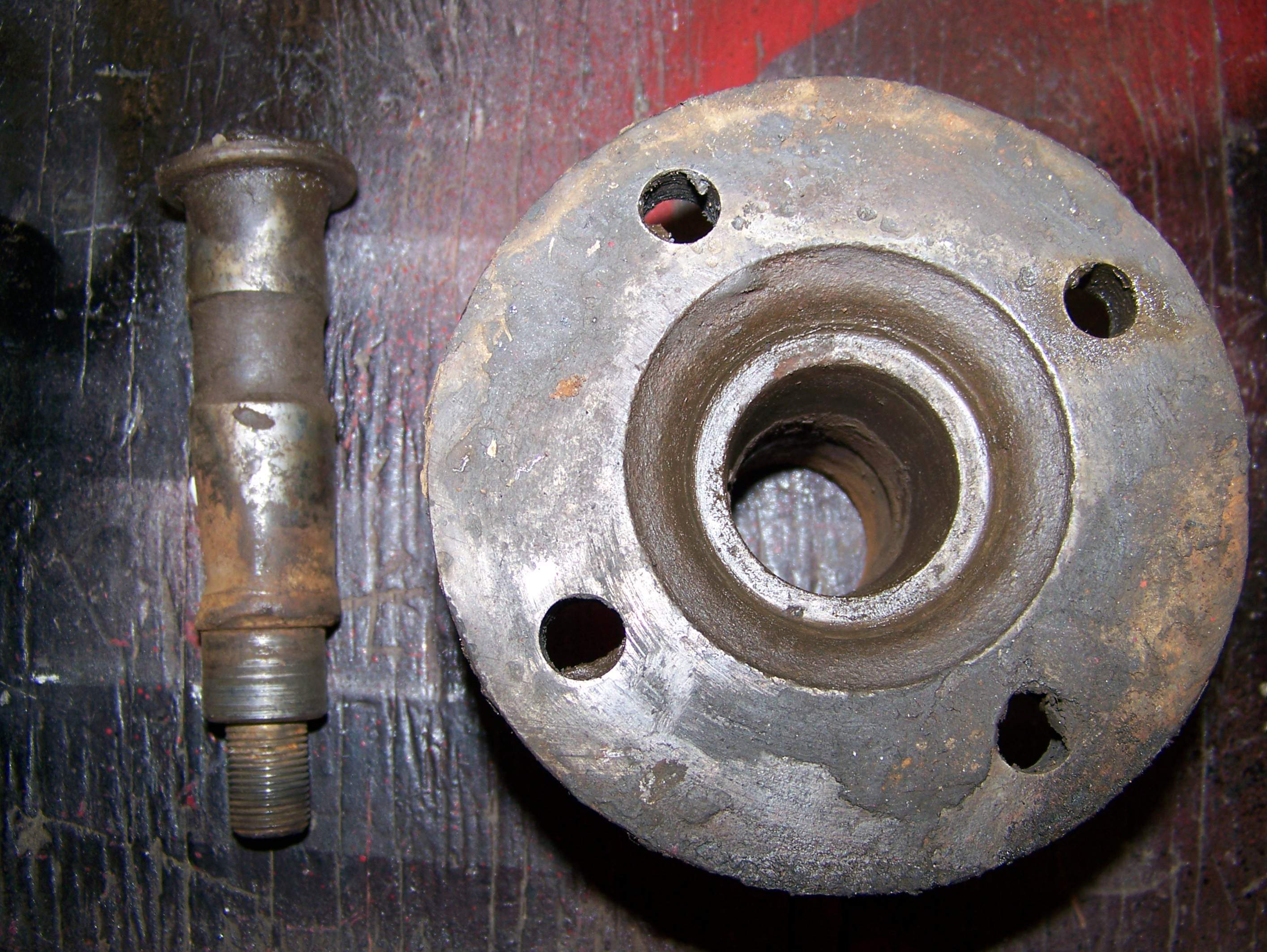

Rolling landside spindle and hug. 4-12-15 Rolling Landside Spindle and Hub.jpg
Coulter Shaft Pivot Nut. There is suppose to be a thick spacer under the nut that contacts the bracket. The nut is the spacer here.4-12-15 Coulter Shaft Pivot Nut.jpg
All these parts were completely dry from any lubricants. Just dried rust and wear.
