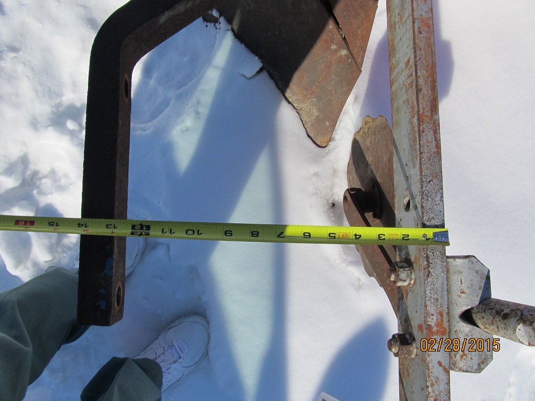

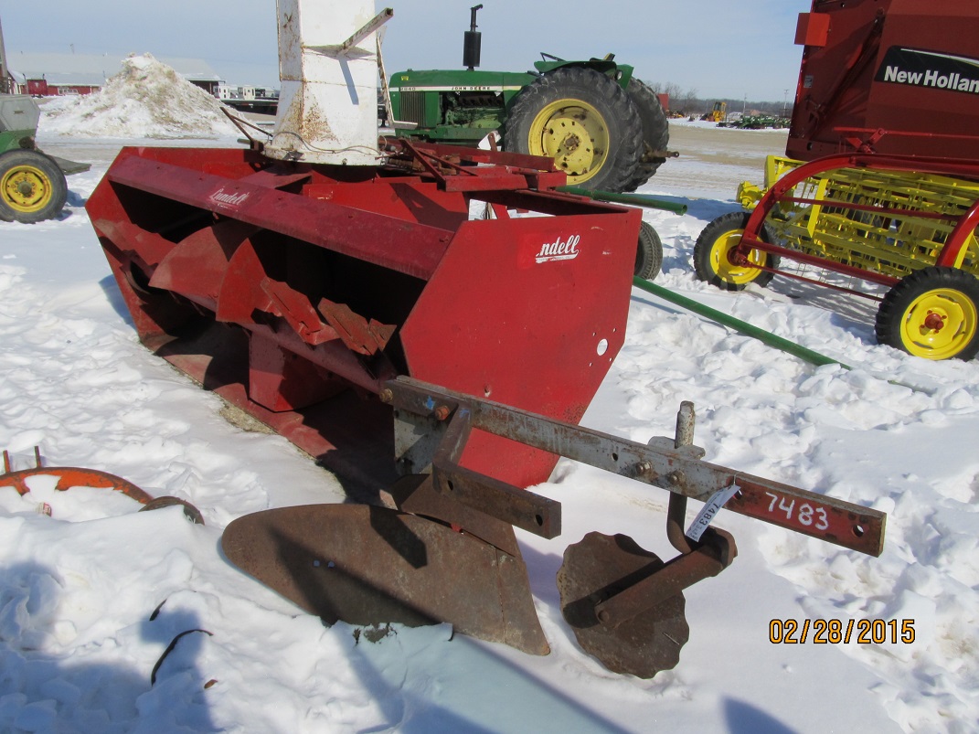

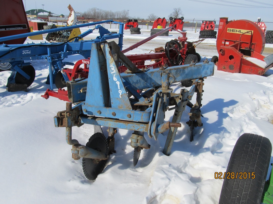

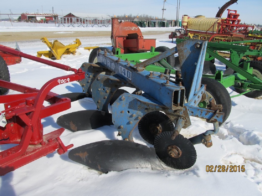

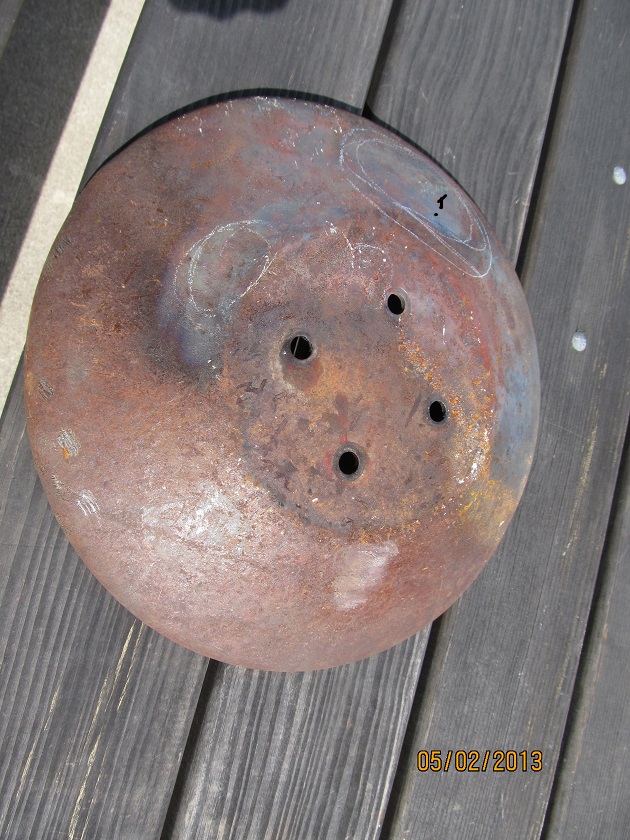

Various pics for you. Excuse the dog pic--I can't figure out how to remove it. He loves eating soft snow. photos of next model up in ford plows and an old beam from a scrap plow. Saw at an auction yard.

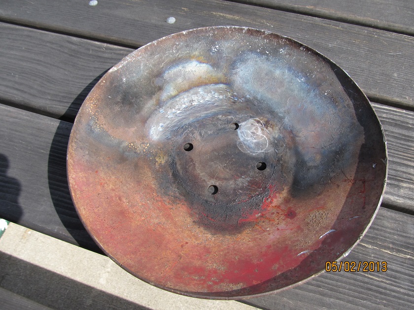

you can pound out the dents in your rolling wheel. just take it off, get a ball peen hammer and an anvil and tap away from the inside out. Works great.

I edited with comments on rolling landslide dents in yours.

I have only seen spring trip shanks but Ford loved to use proprietary bolts for everything and round heads with two flats would be typical. You have some loose frame bolts in the photos so tighten those and oil the beams so they can trip easily.
Also, here are pics of a tailwheel--rolling landslide--that was bent worse than yours. A hammer, anvil and tap, tap, tap until it looks right. I might have heated it as well.
