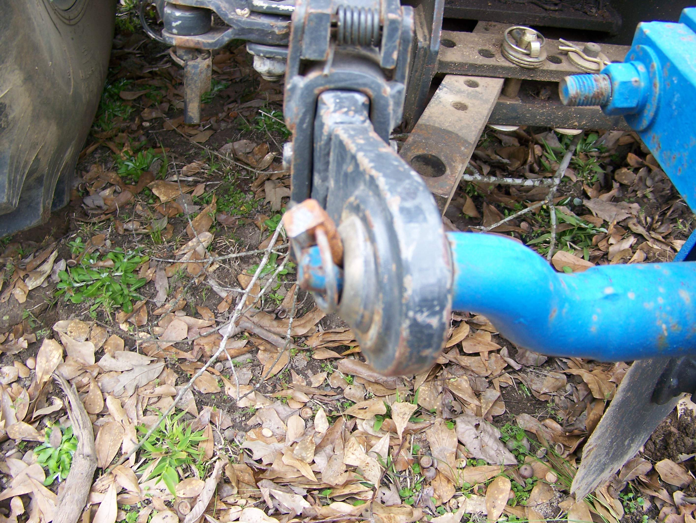

6dogs,
I will put a wrench on everything. Maybe today. It is a wet, gate building day here. If I want to keep the plow and use with my Mahindra.............what do I do about the left hitch mount? With it being cat 1 and the tractor cat 2?
hugs, Brandi

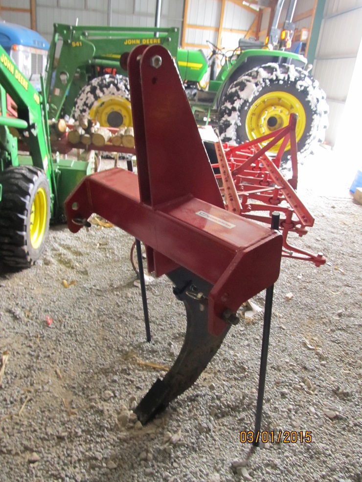

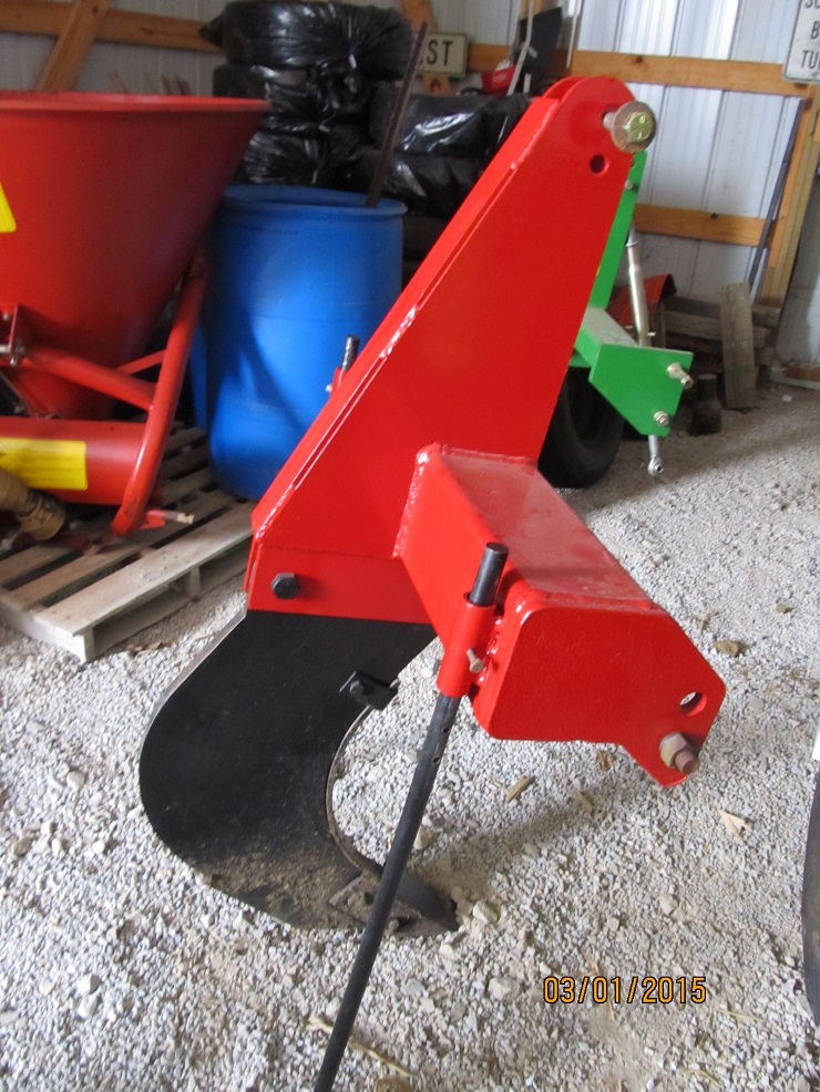

Not sure what left hitch mount means but get some cat I/II adaptors and go for it. I think you have loaded tires for it to rip those roots out so take it a little easy. You already know you need the shorter cat I to II adaptors and many mail order places and some farm stores sell them--or just cut 1/4" off. You can also probably buy cat I hitch balls for your tractor if you want. Most of them are changed by removing a cotter pin and swapping the balls out but not sure about Mahindra.
The photos below are how you rip roots out as well as shatter hardpan. These really do the job. Weighs 235#.

6dogs,
What I mean is the left hitch pin on the plow is too short to to lock correctly. I cut a quarter inch off of the adapter bushing, but the Mahindra's sliding lift arm's swivel ball is two big to put a lock pin in.
It never was a problem before, as all 3PH attachments I have used have removable pins. This plow's left mount is welded on. I had removable balls on my Ford 3055, but my Mahindra's balls are not removable.

#49
Maybe I could grind the shoulder back so the ball will slide on enough for the lock pin? What do you think? That would be the cheapest way.
