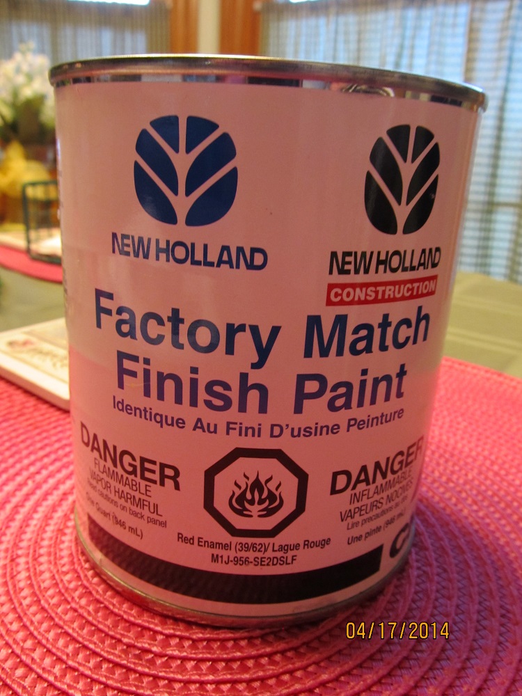

Brandi--the cheapest and best paint is the dealer's paint. Think about it---they have the greatest interest in keeping their product looking nice. Majic doesn't impress me.
The best Ford paint comes from Ford, IH from Case/IH, Kubota from Kubota, JD from JD, etc. If you can find acrylic enamel, that the best readily available for a good balance of price and quality product. I thin with acetone for fast drying but be careful as it is HIGHLY flammable.

Here's the can of Ford Rouge red although your plow was likely blue. Factory Ford blue is attractive. Not everything has to be red...:laughing::laughing:

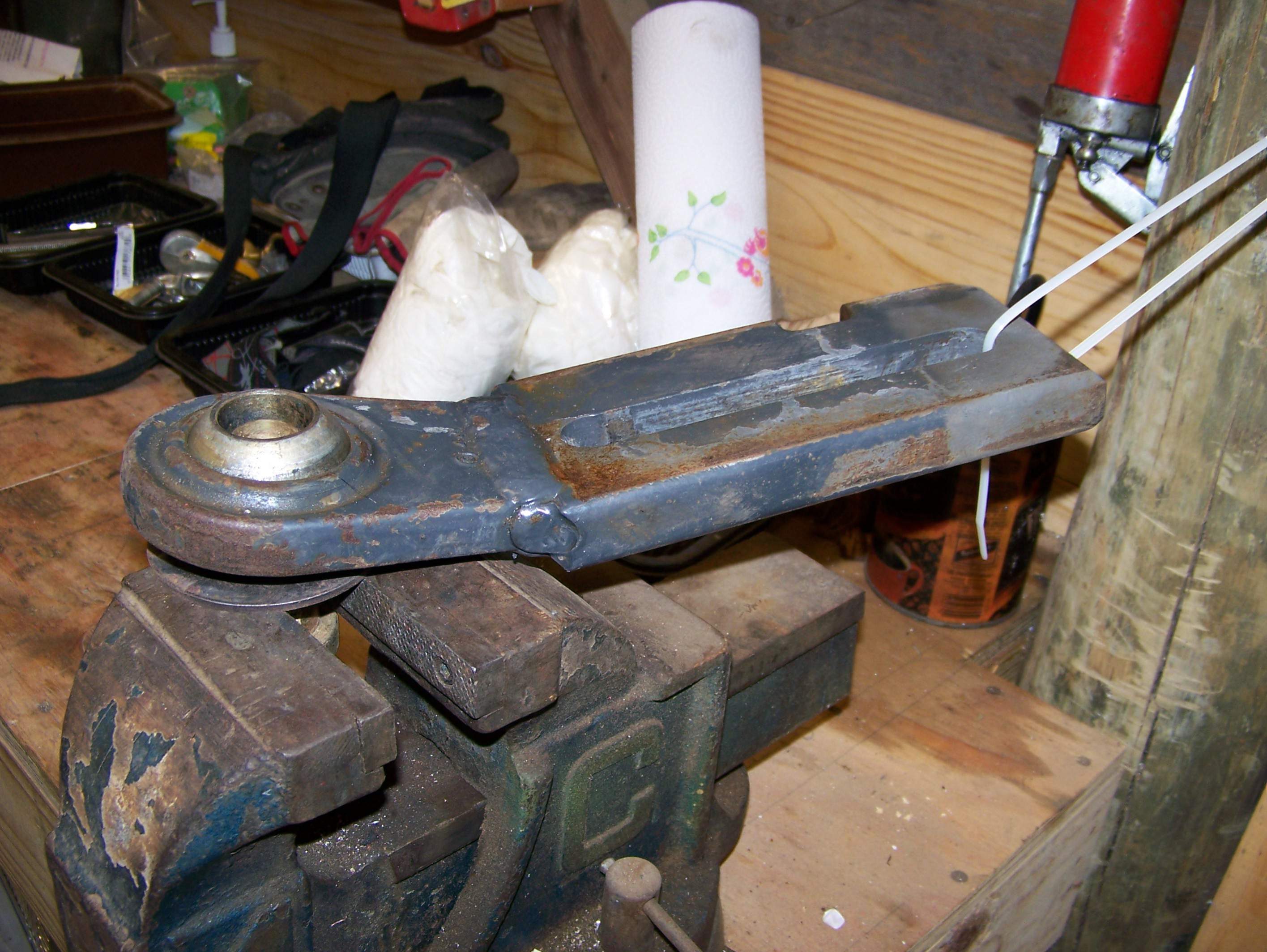

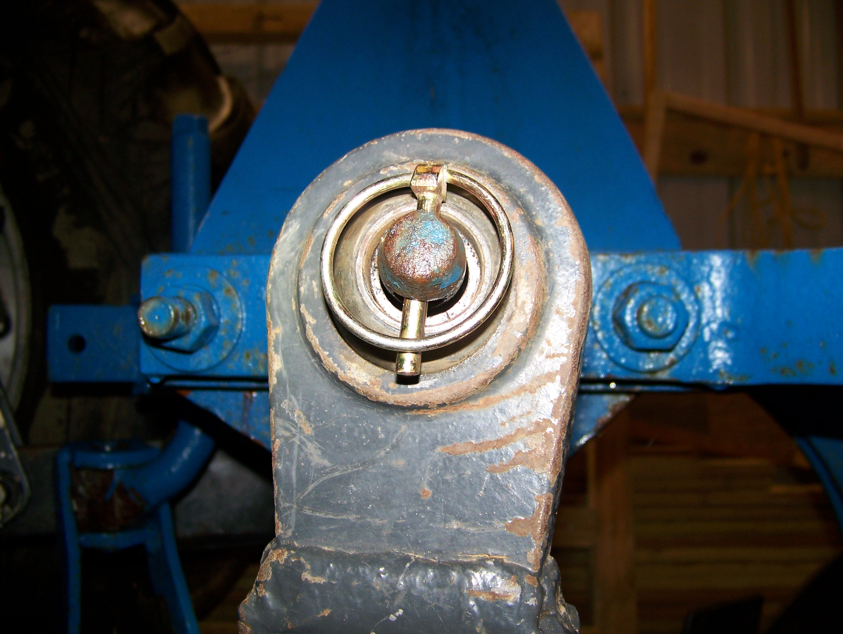

I took the end of the left lift arm off today and ground down the ball. I didn't grind off much material. I now have enough room for a 3/16th inch quick lock pin. Mahindra Lift Arm Ball Getting Ground Down.jpgMahindra Lift Arm On Ford 101 Plow.jpg

I recall seeing many of these plows with the end like yours. The end wasn't very beefy and likely was torn off by the plow flopping around from the three point arms being too loose. So keep them sort of snug and when time is slow think of how to have a stub end welded on in case it breaks again. I do recall some with the stub arm cut off and a plate welded on with the stub welded to that.
I'll have a new pin welded on if it breaks off.
hugs, Brandi

Those quick hitch pins should not be used. Dirt will hit them and they fall out. A bolt with self locking nut the best.
   / Ford Model 101 3 Bottom Plow #70
I am assuming you are talking about the "LINCHPINS" that Brandi is using. If so, to each his own but I disagree. I have never had a pin fall out, all the 'real farmers' use them around here on equipment that is not attached using a quick hitch of some sort and their equipment is huge and heavy. Linchpins are common practice.
AS much as I change implements I would hate to know that I had to have a wrench to disconnect and reconnect.
