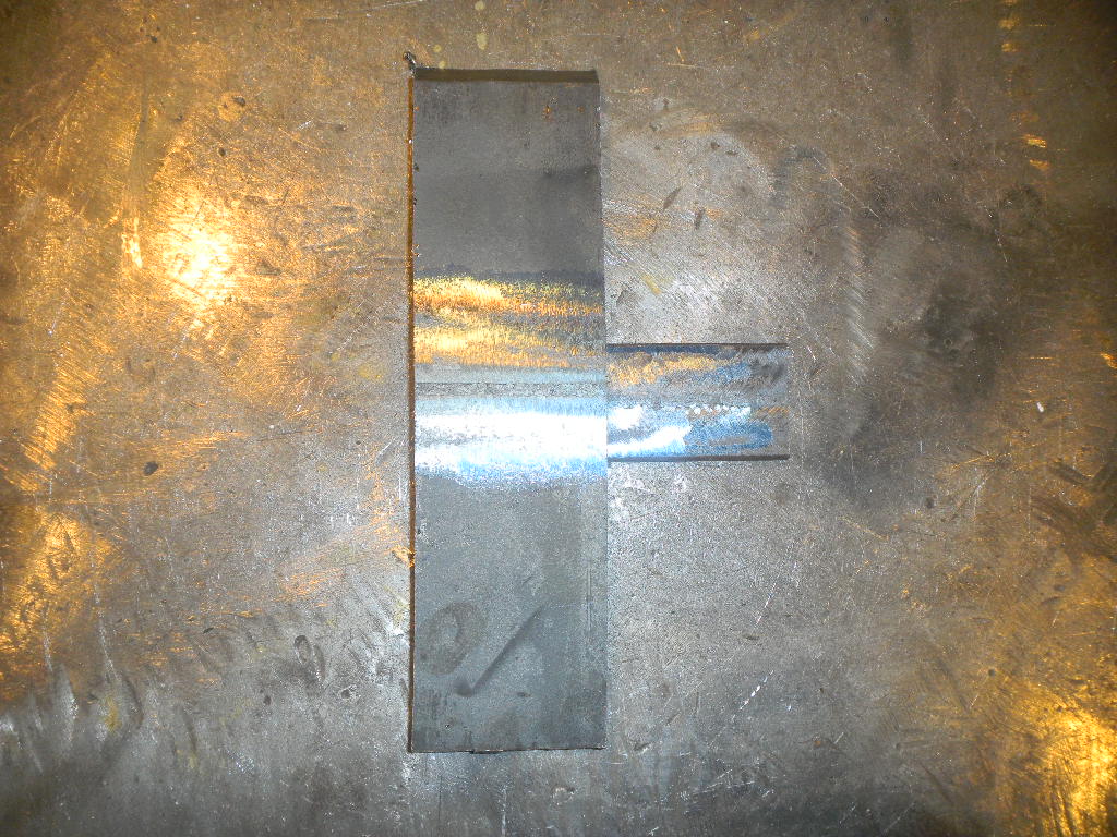

200-amps is a good basic Mig welder to have. I ran this weld at 224-amps, 29-volts. With Lincoln's
.030" L-56 Mig wire. You're not going to see that kind of penetration with a 120-volt Mig welder.

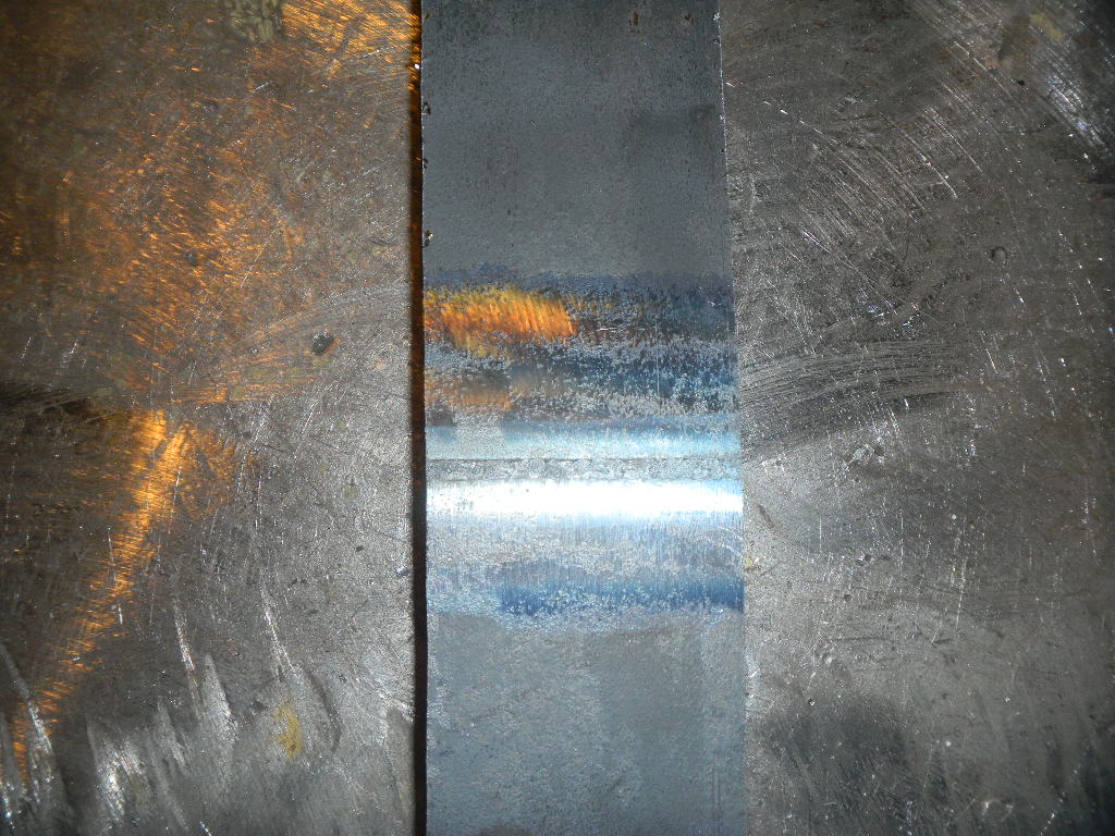

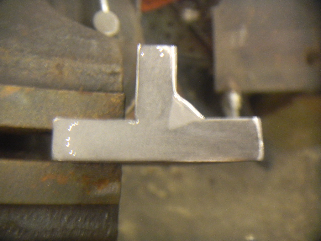

Did it look something like this? This is an etched view of the weld I posted above, done with a 120-volt Mig welder. No penetration at all!

No, it didn't look nearly that good. Imagine sneezing and getting snot on some steel at a joint. Grab one piece and a slight twist and it comes right apart. That's what it was like. Pretty sorry and a complete waste of time, but it gave me a good laugh...

When I made that weld, and was sawing it apart for the coupons to bend. The backing plate fell off while being sawed.:shocked:

Shield Arc, that's one picture perfect weld you did with that Lincoln.
It's no wonder that it took 20+ hammer blows (if I remember right) to break one of those, when you did those hammer tests a couple years ago. :cool:

Yeah, like I've said before. THERE IS NO SUBSTITUTE FOR POWER! :thumbsup:
