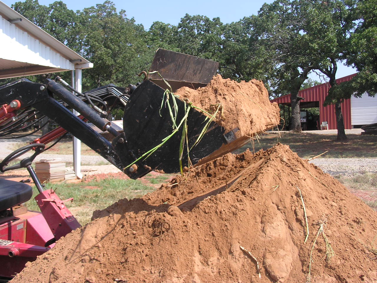

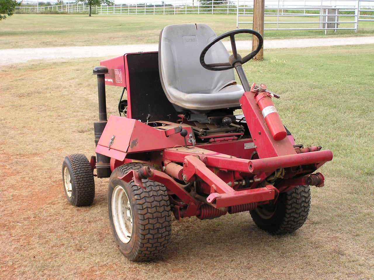

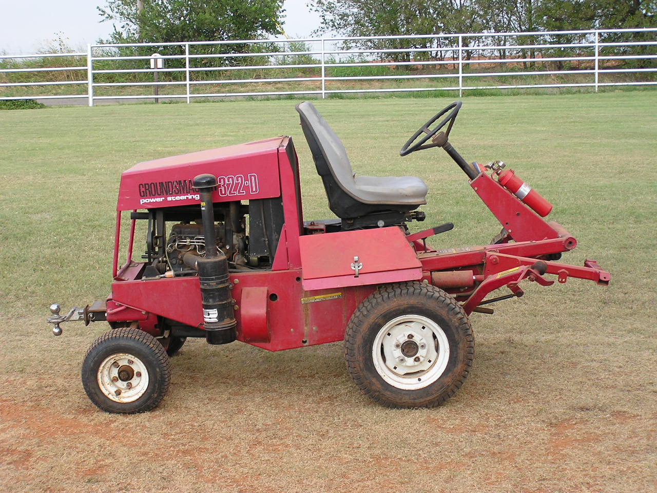

An old commercial mower with no deck.

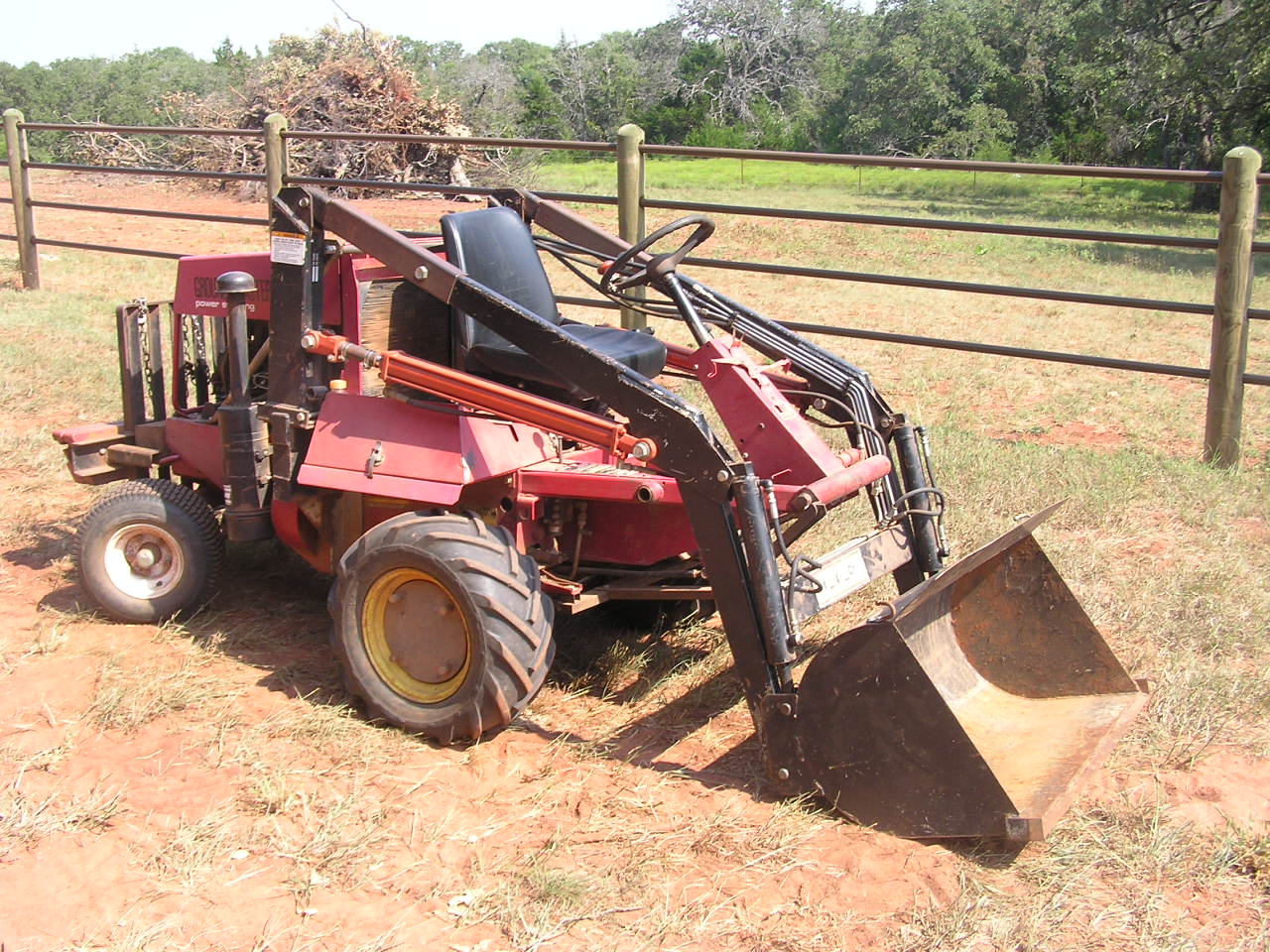

Added a loader 8 years ago, still using it now.

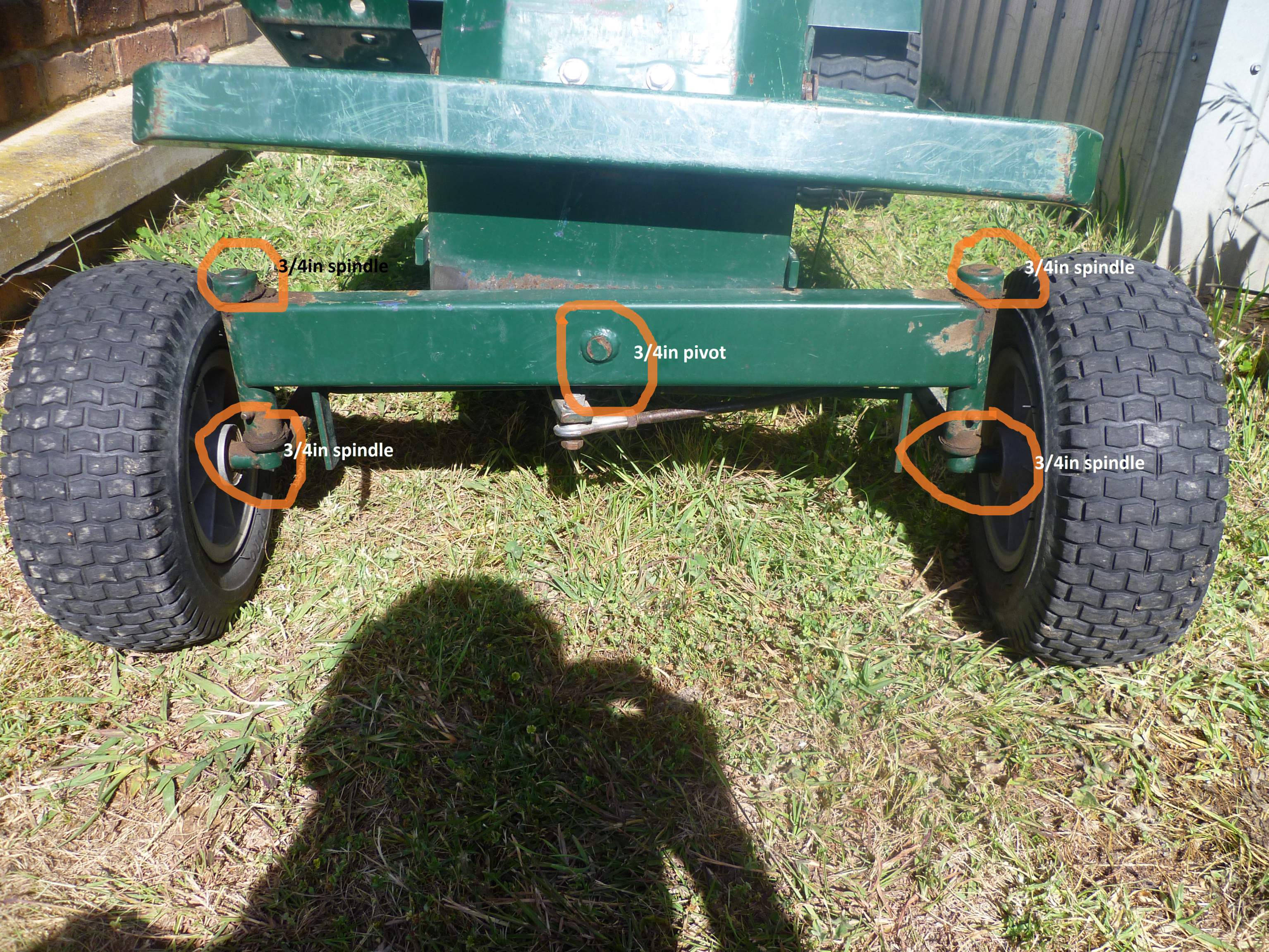

/ Front end loader for...
The loader is not going to be carrying a lot of weight. Here is a photo of the front configuration.P1460473.jpg I worked out that I would have to put 250kg (550lb) of weight on the front bucket before it would take the rear wheels off the ground. I think i will leave the dis brake idea for now. I was thinking if the winch goes through a pulley on the arms and then to the curl, then so when the winch is loose the bucket will sit flat on the ground and when you lift the winch it will curl the bucket (to an adjustable angle) and then lift and when you want to dump there will be a support arm that goes from the arm down to the frame to hold the arms while you release the winch to dump. I don't know if this make sense but it is just what I am thinking at the moment, if you don't think this arrangement will work please let me know.

I understand your idea. Getting the geometry right may not be easy.
With the bucket floating flat on the ground, moving forward to fill it, if snags on something, I think it will raise the arms and dump.
If that is too much of a problem, you could change it to a trip latch, or the disc brake.
Still it will be better than a shovel! :thumbsup: :D

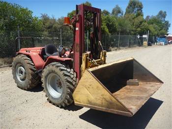

if one wanted more lift one could make a mast similar to a fork lift that lift it straight up and then dump,
