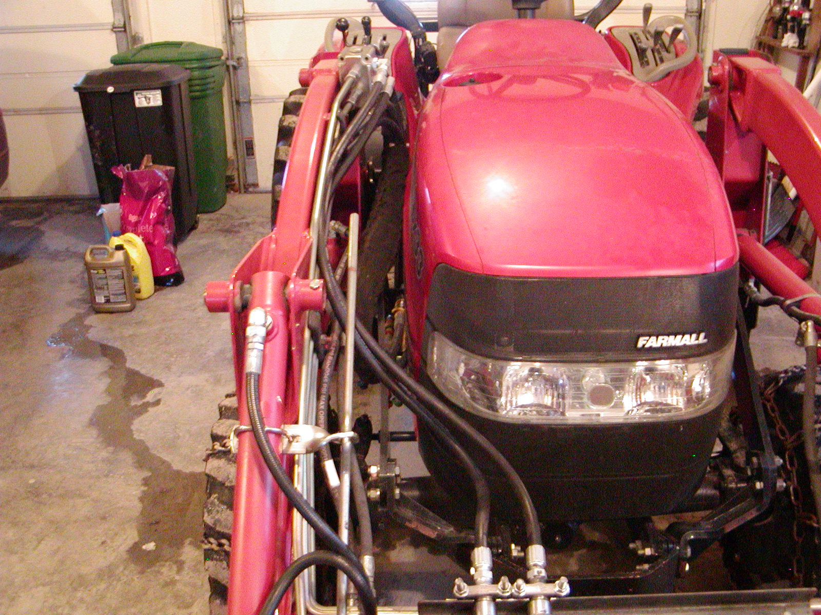

Well I'll throw mine in the mix. Been working on it and finally got the hoses securely mounted. It has been nice . I am pondering an adjustable mount instead of the chain. It looks like the cross over relief valve might be a good idea as well.
Now for a little clean up and paint! Looks like another big snow in the works here in NW MO so it will get another workout!
   / Front mount snow blade
#40
First big snow since I got my blade finished. Cut my plowing time from 5hrs to 3 1/2hrs. Gonna try a chain lift instead of the ridged top link and see if it works any better.
