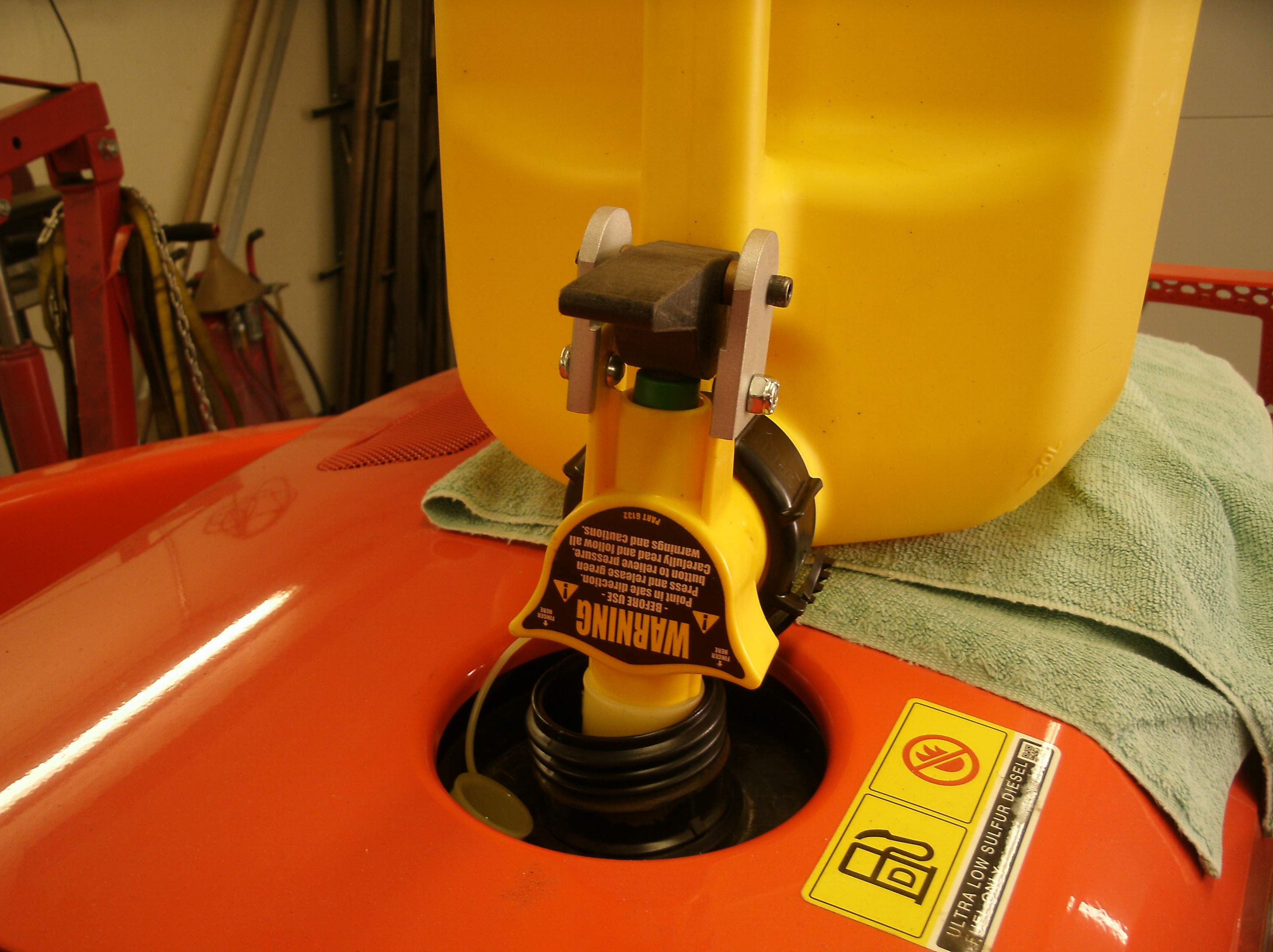

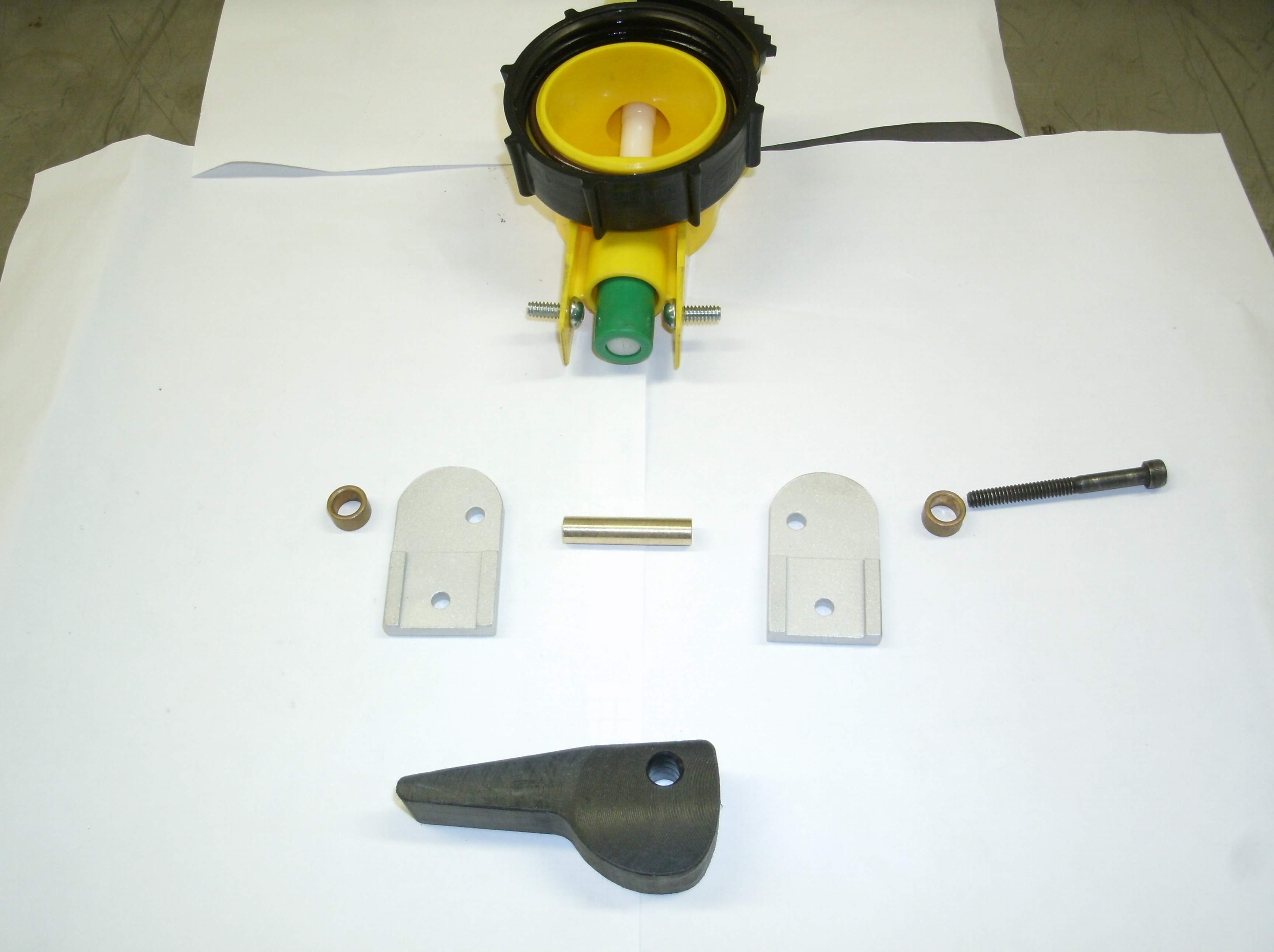

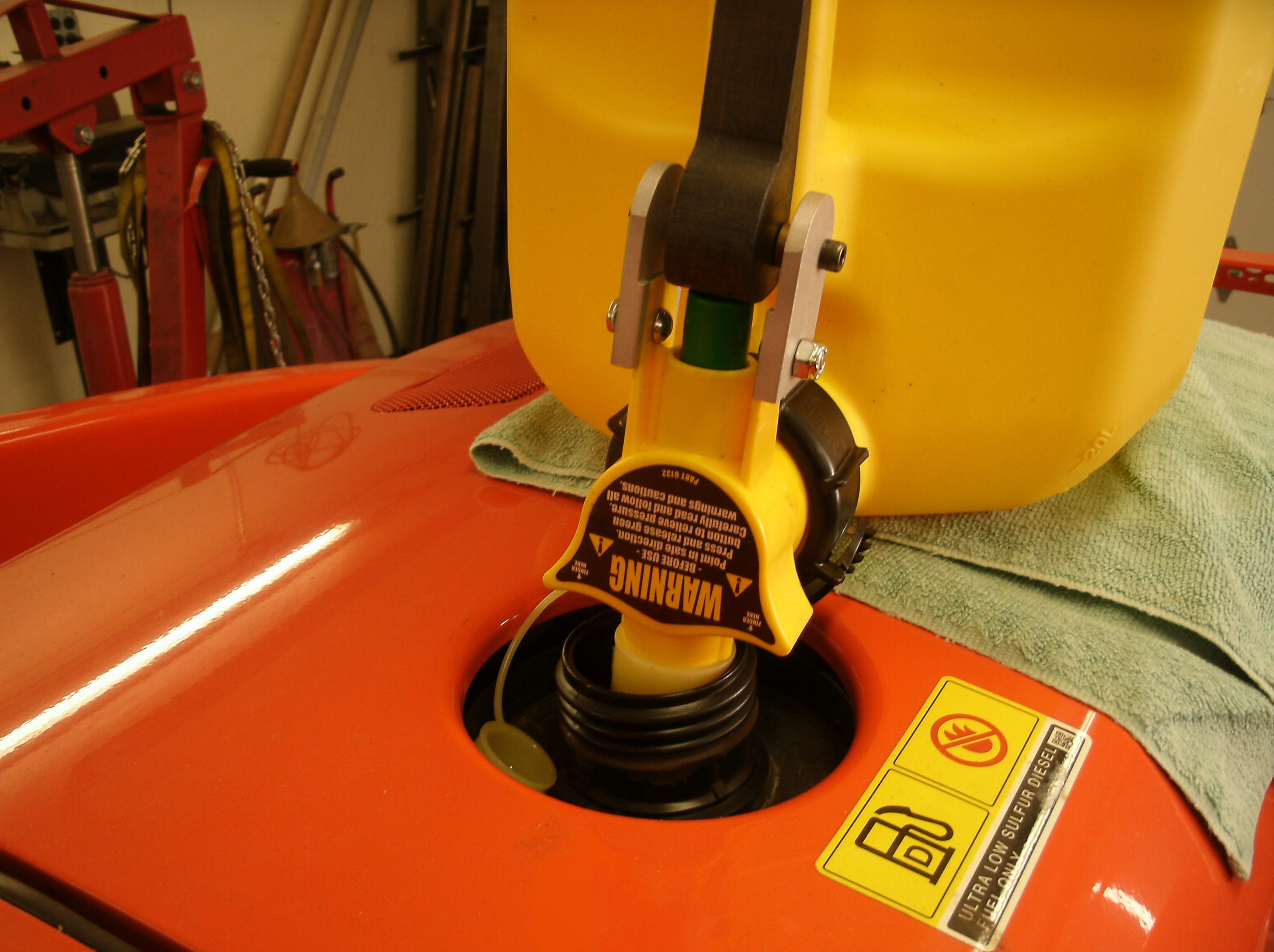

Have you ever had something annoy you to where you get obsessed with fixing it? That's pretty much what happened here. I love this fuel container for adding fuel to my tractor. Set it up on the hood and put the nozzle in and add fuel without spilling. Except pressing and holding the button down while the fuel gurgles in just got to me last time. So I came up with what I thought was a simple solution......adding a cam lever to hold the button down. Well, it morphed itself into drawing the cam up on cad, water jetting it out of nylon and cleaning it up on the sander, milling the thickness to specs, milling the aluminum side supports plus sanding and bead blasting, turning an insert down on the lathe and cutting two spacers. Sheesh! I got annoyed at myself trying to fix something to not annoy me. Well, the good news is it works and all my trouble was worth it in the end. Had a good laugh at my own expense!

I have the exact same cans as the OP and the exact same issue. Love the cans, but holding that button down kills your thumb. While I applaud your ingenuity on that, I just drilled a hole across through the 2 yellow tabs, right about where you mounted those screws to it, and stick a 3/16" drill bit through it to keep the button pressed down. Push the button down all the way - line up a spot to run the drill through, and poke the holes. Give it a little slack so it doesn't bind up. A whole lot easier than your method, as long as you have a drill bit handy ( I always fuel up in my shop, so drill bits always handy). I suppose i could tie a piece of steel rod to the can if I really wanted to keep it there all the time...
Only risk is overflowing if you misjudge how much space is in your tank, or a flood of diesel if the can gets knocked over or falls while pouring. Mine stays put nicely, so I can do other things while it fills. Though I always stay close just in case.

I was thinking of using a 16 penny nail and then remember one of the nice features of these cans is being able to stop the flow immediately...
