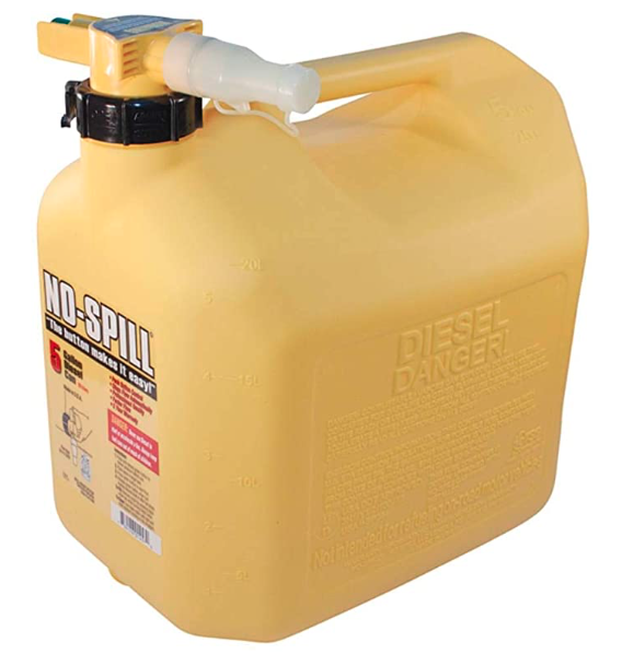

I've got one of the no spill cans for my Bolens. I put a kneeler pad on the hood and tip the can so the spout fits into the filler. Then I use the push button, no sweat. Sometimes I do stand on the tire.

It’s the only no-spill nozzle that works reliably, just slow. Added vent really speeds fill ups. They’re perfect for the little B26. Have the nozzle extension tube but haven’t tried them on the M59.

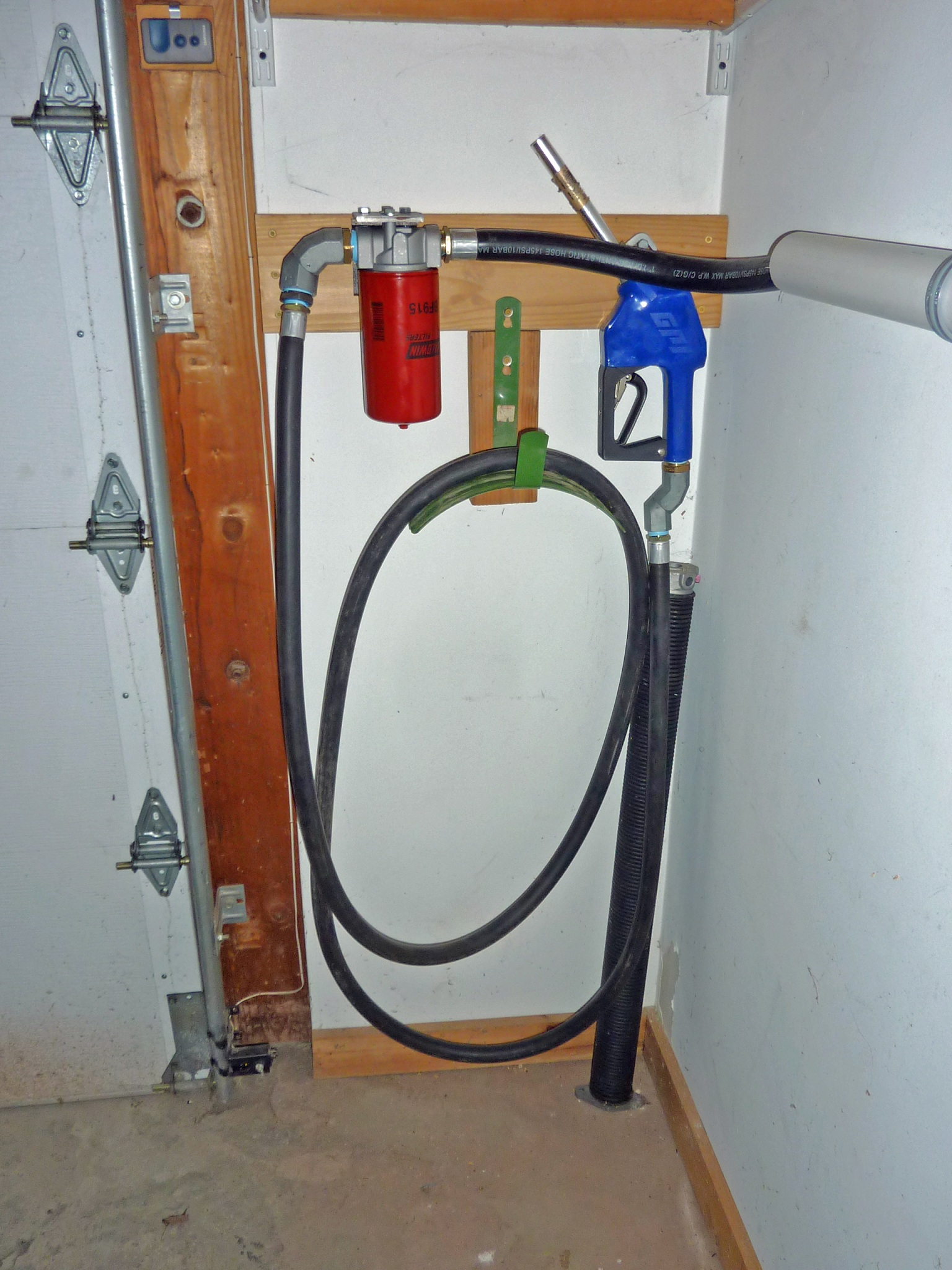

I've had it with those fuel cans. I ditched 'em all and installed this near the garage door:
I put a 110V fuel transfer pump on the 500 gal. fuel oil tank for my oil burner. In my state, home heating oil has to be ultra low sulfur, so it burns just fine in my tractors.
End of hassle.

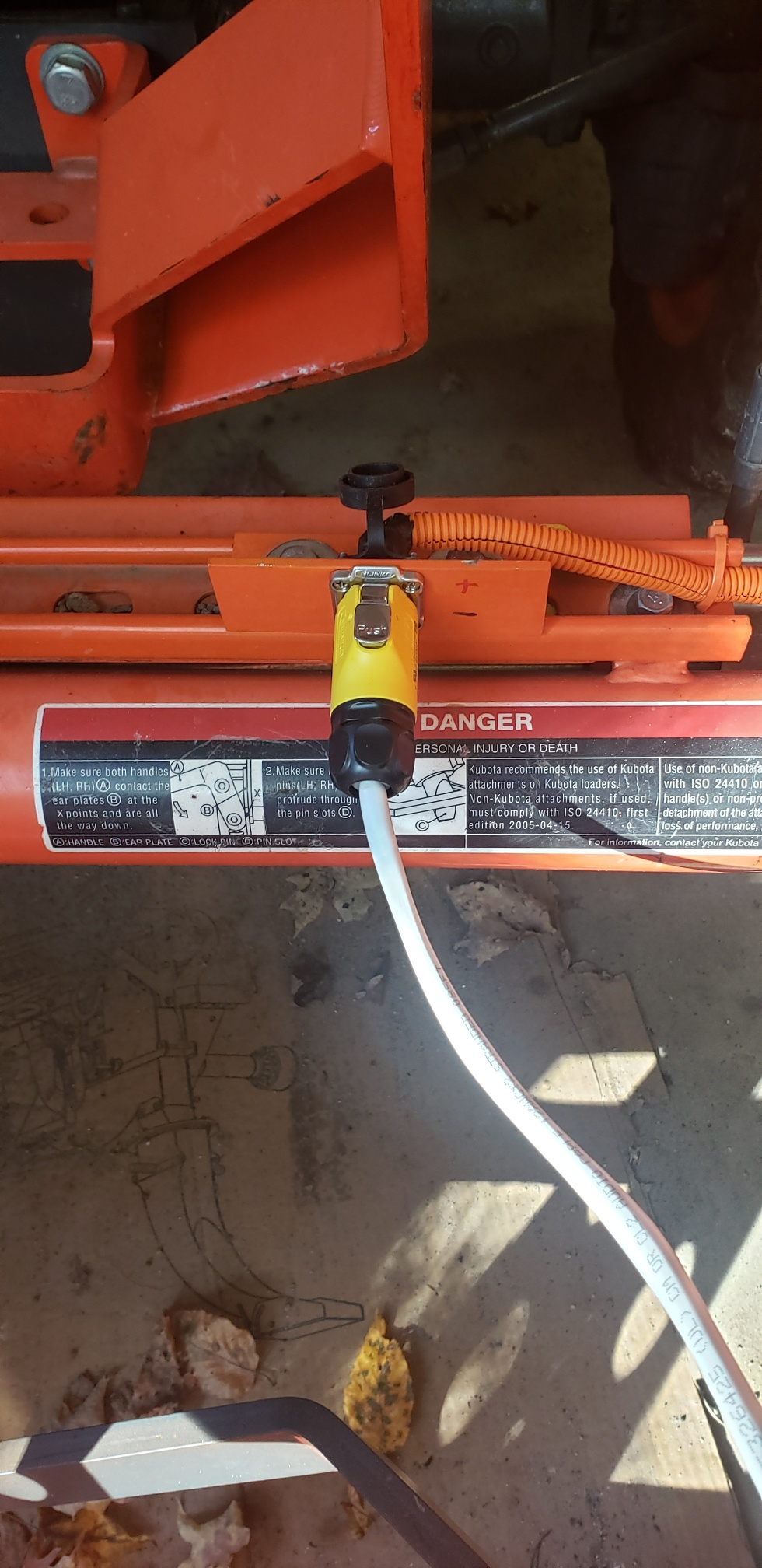

I gave up on lifting 5 gallon jugs. Too old, too heavy, unwieldly trying to hold up. Found a new 55 gallon drum and installed a standard home heating fuel oil fill and vent on it. Used a 12volt Amazon 'special' diesel pump kit that included the pump, hose, handle and input hose and strainer. It pumps at about 15gpm. Mounted it on a nice drum dolly that really rolls easily! I replaced the cord and large alligator clips with a 20' cable and a connector that mates with one I put on the fel cross support.
At my age I really enjoy the little things!
Very nice!!. I guess, for some reason, simple ideas escape me sometimes. Maybe that is a sign of old age also. I never thought of using the tractor to power the fuel pump. Kinda feel like an idiot - When I saw this picture, I thought, what a great idea. And everyone else probably considered that idea. Very Nice, I LIKE IT!
End of hassle.
Cool idea. Is the home heating oil #1 diesel, #2 diesel or kerosene?
The product is called #2 home heating oil. It is ultra low sulfur, dyed red, and is the equivalent of #2 diesel fuel. I've used it in all 7 of my Kubota tractors since 1979 with no issues. The temp gets down to -10F here on occasion and even though it's #2, I've never had a problem with it gelling. I filter it twice before filling the tractor and I've never had to replace any tractor fuel filters.
I know others who advise against doing this but it's worked for me for over 40 years.
