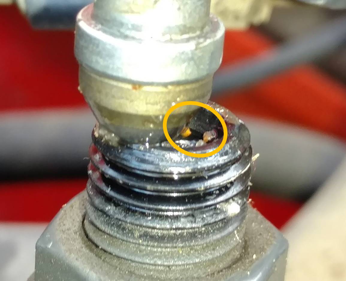

Well, Saturday came around, and a high temp of a whopping 24 degrees. I decided to remove all three of the injector lines at the same time and get a good look at how much fuel is coming out of the lines to the injectors.
I'm glad it's cold today! It made the problem obvious, as you'll see in these pictures. Ice crystals. I saw them as soon as I had them opened up. I cranked it over anyway just to see, and got one good spurt out of one line, and then nothing. It's clearly a lot, and it's clearly through the system.
I guess that just might be why it's not starting.
So what's the procedure for getting it out of there?

Besides the ice, what are the yellow chunks in the 1st photo and possibly the 3rd photo? I'd be a bit worried where they came from and why they are in this location.
Reference the circled area:

Besides the ice, what are the yellow chunks in the 1st photo and possibly the 3rd photo? I'd be a bit worried where they came from and why they are in this location.[
I saw those, too. I was hoping someone here could shed some light on them. Hmmm. Wax?

Before trying to salvage your existing fuel, I'd be cleaning out the tanks, lines and such from the tractor and refilling with fresh known to be good diesel. Get the tractor running and then focus on decontaminating the existing fuel.
Fuel storage tank(s): Before adding any fuel conditioner, perhaps it would be best to filter the fuel first to remove as much water as possible before adding any additive.
That's my plan at this point. I plan to pick up a fresh 5 gallon can tomorrow. I'll get the on-road kind so the dye doesn't interfere with seeing the condition of things. I figure I'll disconnect the tank behind the first filter (before the lift pump) and plug that temporarily, then feed the lift pump from the fresh fuel, with a de-icer additive. (Diesel 911?) And yes, I do have a heat gun and a portable room heater that should warm up the filters, lift pump, injection pump, and injectors.
If I can get it running I'll let it idle a good bit to warm everything up well.
Then I'll tackle de-watering the rest of the fuel. Tractor tank first, then the barrels.
I've been using a water-absorbing filter on the fuel pump. I think I probably need to add a seperator with a glass bowl so I can keep an eye on things, and just have the absorber as a 2nd stage.
Sound like a plan? Any recommendations on additive?
