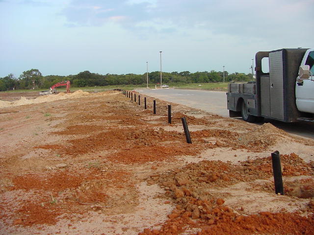

Okay Wallysue!
This is a pipe fence I'm putting around some areas of the new Weatherford High. If'n you're going down twenty west of Ft Worth and you see this blue streak just off the freeway, well chances are, I'm working./w3tcompact/icons/laugh.gif
You're looking down six hundred feet of fence this picture.

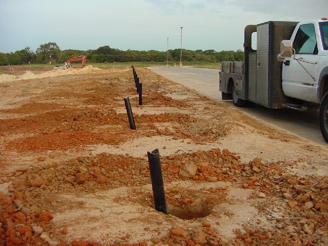

#75
Here's the same line from just a tad off kilter. It isn't perfect. But then few things really are.
I do this all by eye, height and line, just an easy way for an old man to do young man's work and live to tell about it./w3tcompact/icons/laugh.gif

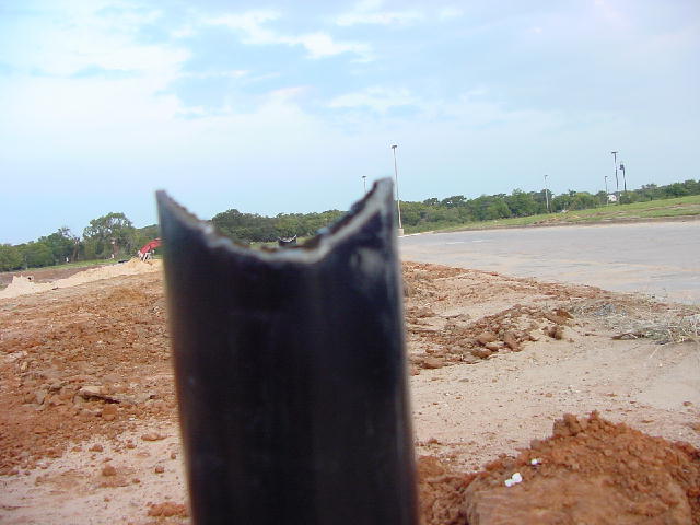

#76
This is the perspective I look at when sighting them in. I see what you're looking at now and then I'm looking for the post in my hand to be one with the rest in the line. I just drop down the eye until it happens.
Then I know it's gonna be fine.
The good thing about doing it like this is you only have to worry about one post at a time. It's sorta like trying to get through a year. If you do it a day at a time before you know it a years done gone.

#77
And this is where we're gonna go tomorrow.
Yup.
That line is going up and making a bend. And then it makes another bend and then it really takes off upwards kinda like. About seven hundred feet or so.
And if I'm lucky it will come out just fine. There is some luck involved. And I do believe in luck. In fact I'd rather be lucky than good. Heck anyone can be good. That only takes working at it./w3tcompact/icons/smile.gif

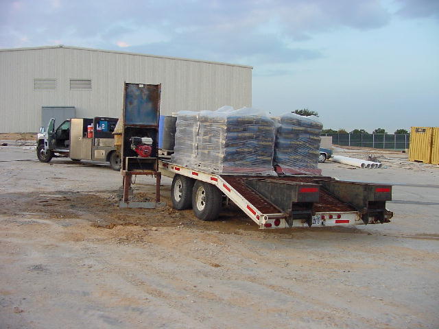

#78
I don't know if you noticed but them holes were a touch large. They're a foot plus across and three feet deep.
I told the locals the other day at breakfast that they must have some real mean short fellas around town. I'm building a heckuva fence and it's only twenty inches tall. Their short fellas must really be something.
Here's the way we do it. The mixer takes nine bags of maximizer. That's nine cubic feet. Nine cubic feet gives me enough concrete for four holes. We're not filling them all the way to the top, landscaping. There's thirty five bags to a pallet. So I get less than sixteen holes per pallet. That whole line in the pictures is about thirteen hundred feet. That's about three hundred sacks.
The concrete bucket that fits on the tractor pays for itself on a job like this. To set up the mixing operation I have to have room. So this place they've assigned to me and the stucco contractor is about a quarter of a mile at the closest point to where the posts are. So I put a mixer load into the tractor bucket. Dump the concrete in four holes. Sight them in. Then go back and mix up another load and do it all over again.
Ain't bad. Pays better than what you'd think. You get to see something from start to finish and done well. And while the hands are busy, my oh my, the mind does get to play.
