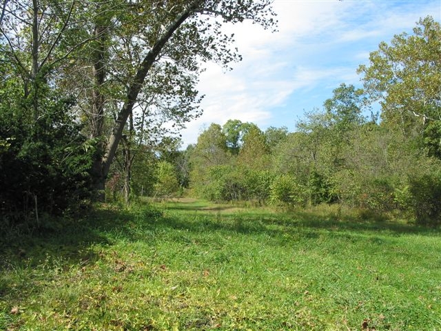

I have considered the raised bed idea and plowing a larger area but planting a smaller one so that I can manage it better. The images show the general area. I will be clearing the trees and brush along the creek to the right.
This space was completely covered with the invasive Autumn Olive when I bought the property and it's at the lower part of a hillside so hopefully the soil will be okay. It's great to know I must get through the hard pan to create life.
I am a couple of hours from Columbia, MO off the I-44 corridor.
That's beautiful land. What a blessing.
/ Garden Implement Basics for the Beginner #24
This is a 4 acre parcel that is adjacent to my back property. I care for the entire 15 acre tract and the owners are only around a few times year. Great folks.
I have leased this 4 acres, (share cropping arrangement) but we shall see just how much I use this year. Irrigation is the issue. I either have to pump water up from Beaver Creek, which is slightly over the rise on the horizon of these photos, or bang down an irrigation well.

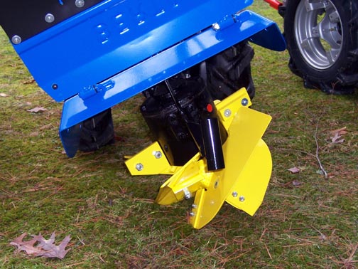

Another bed building option is the Berta rotary plow mounted on a BCS or Grillow 2 wheel tractor as the smallest BCS 8 horse power tractor will dig 12-14 inches deep with the rotary plow.
The entire space could be made into one raised bed for the market garden if desired and have excellent drainage as well.
The Berta rotary plow will till in green manure crops completely and destroy the invasives for you by burying them and destroying any surface vines.
The BCS or Grillo 2 wheel tractor can be used the year round for mowing and snow removal as well as cultivating and planting seed crops if desired

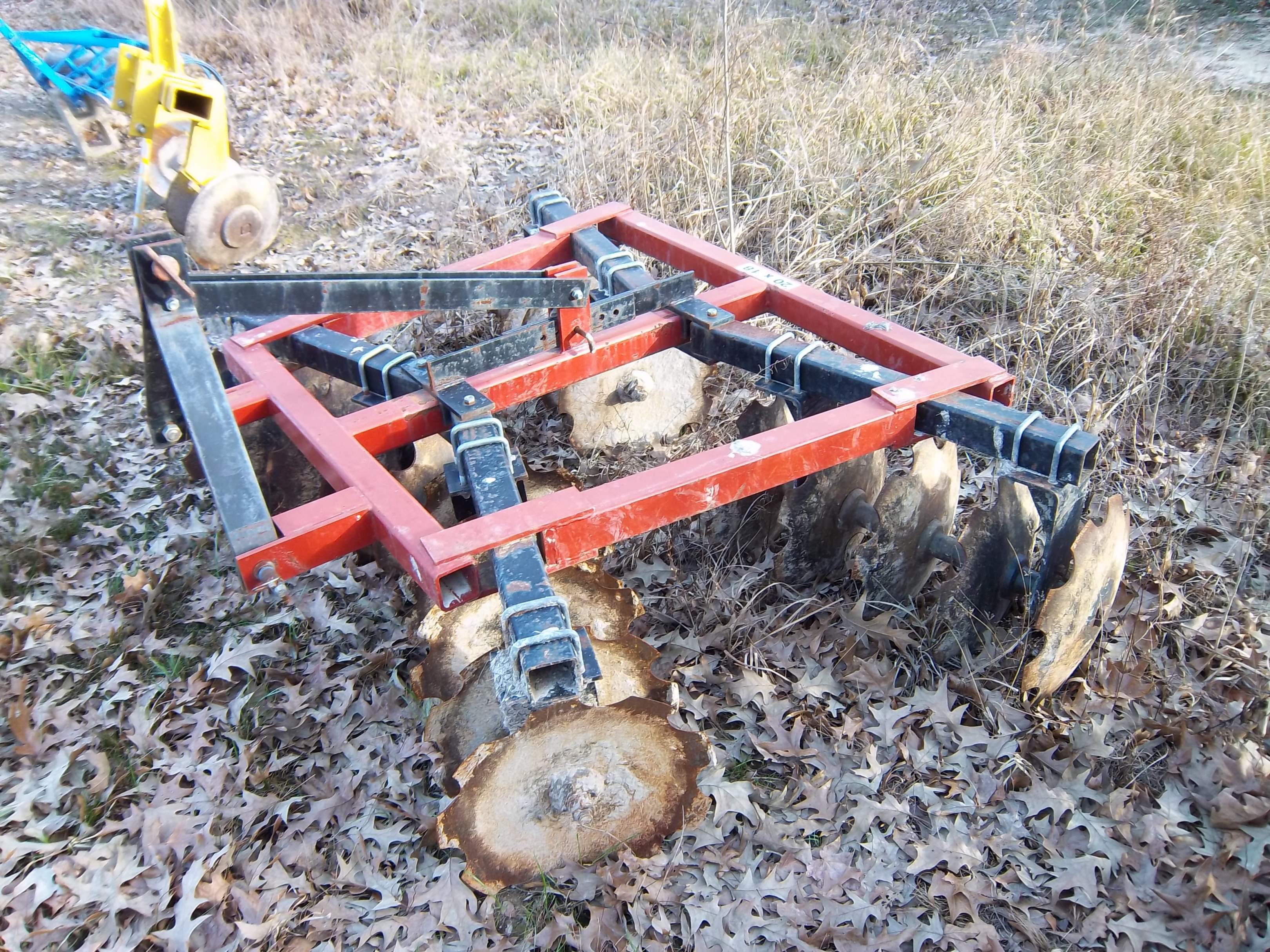

bp fick, Exactly how did you plow the ground with the middle buster?
I have a middle buster and a gang disk and was thinking about trying to bust up the ground like you did. Maybe bust the ground up with the middle buster and break up the clods with the disk? I'm brand new to gardening also. The row hipper and cultivator I just purchased and haven't even hooked them up to the tractor yet...

OK, I will share what I do. YMMV. Pix of "before and after" below.
When busting soddy, hasn't-been-worked, ground. I plow at a pretty deep depth. I send the buster down to the shank. On mine, that is about 10".
I put my front wheel in the furrow and go again. Back and forth. Understand, this leaves an unplowed hump in between each furrow. Don't worry about it. I plowed that field shown in Texas in about 3 hours, so that's an acre an hour, but sometimes, you just need a bit more time. A middlebuster can bring a tractor to a stop.
OK, then I would love to have it rain for a good day or 1" of rain on it. Then, I come back and plow the whole thing again, this time plowing the "in-betweens" that were skipped the first time. Now, all of it has been plowed.
NOW, you go after it with your disk. I would recommend on near virgin, soddy soil, that you plow twice before disking.
In the future, you could plow once and your disk will take care of that "in-between" hump, no problems, because you don't have those roots and sod and your soil is nice and so much better now.
Sure, I'd love to stumble on a good turning, share plow, sized right for my tractor. Love to. They are rare as hens teeth around here and priced at a horrendous rate, cause guys can scrap them. My point remains that for $140, a potato plow, middle buster can do the job and you have a tool in your shed that has many other future uses, even if you get a tiller or turning plow one day. It is an answer to the OP's question of basic beginner implements.
