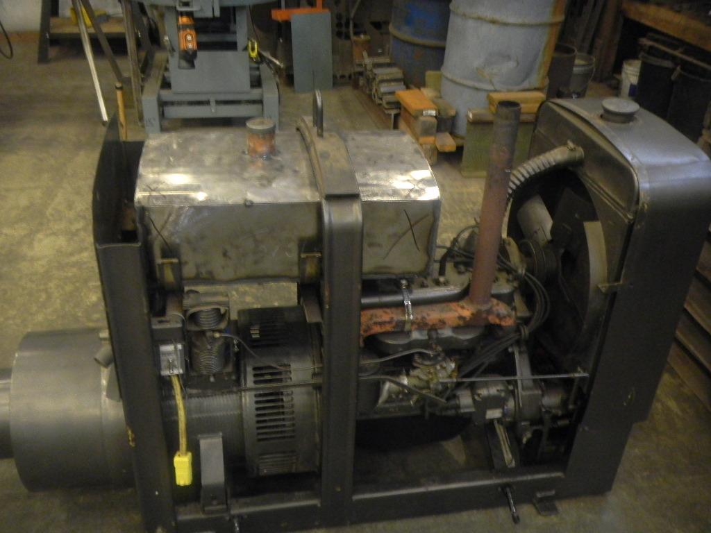

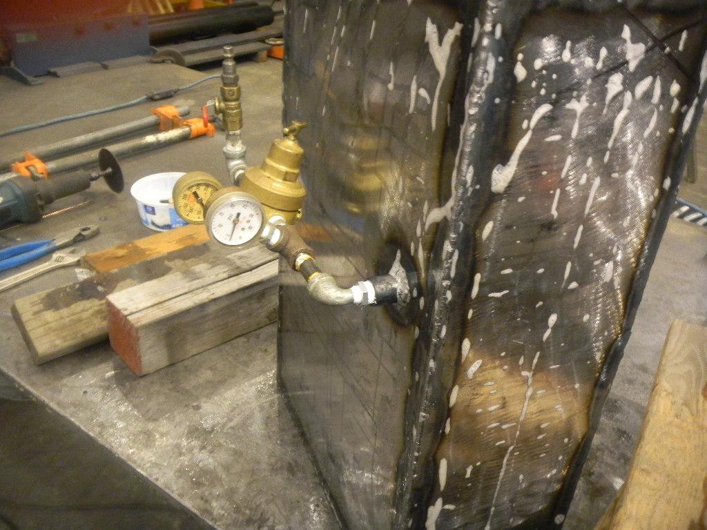

Welp, one of the problems with collecting old engine drive welders. The gas tank on my 1954 Lincoln SA-200 Short hood rusted out:(. Even if you could find a replacement, who's to say it's not rusted inside too. So I took a sheet of 16-GA, and made a replacement tank. I tested the welds with soap and water. I bought a can of gas take sealer. So maybe this tank won't rust out in my life time. :laughing:

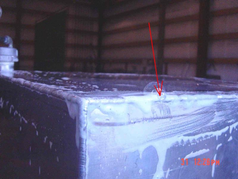

Several years ago I built a 60-gallon farm gas tank out of aluminum. I cut the pieces out with my plasma cutter. I got an education on welding aluminum after cutting with a plasma. :eek:

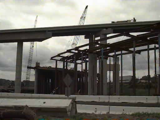

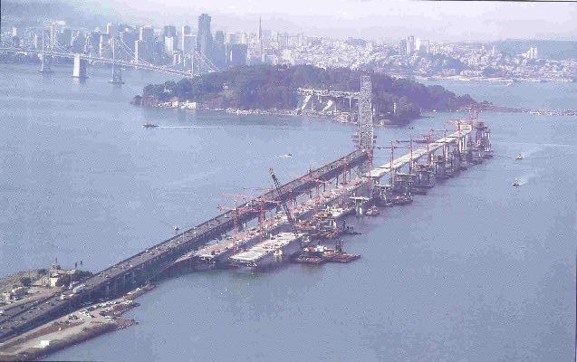

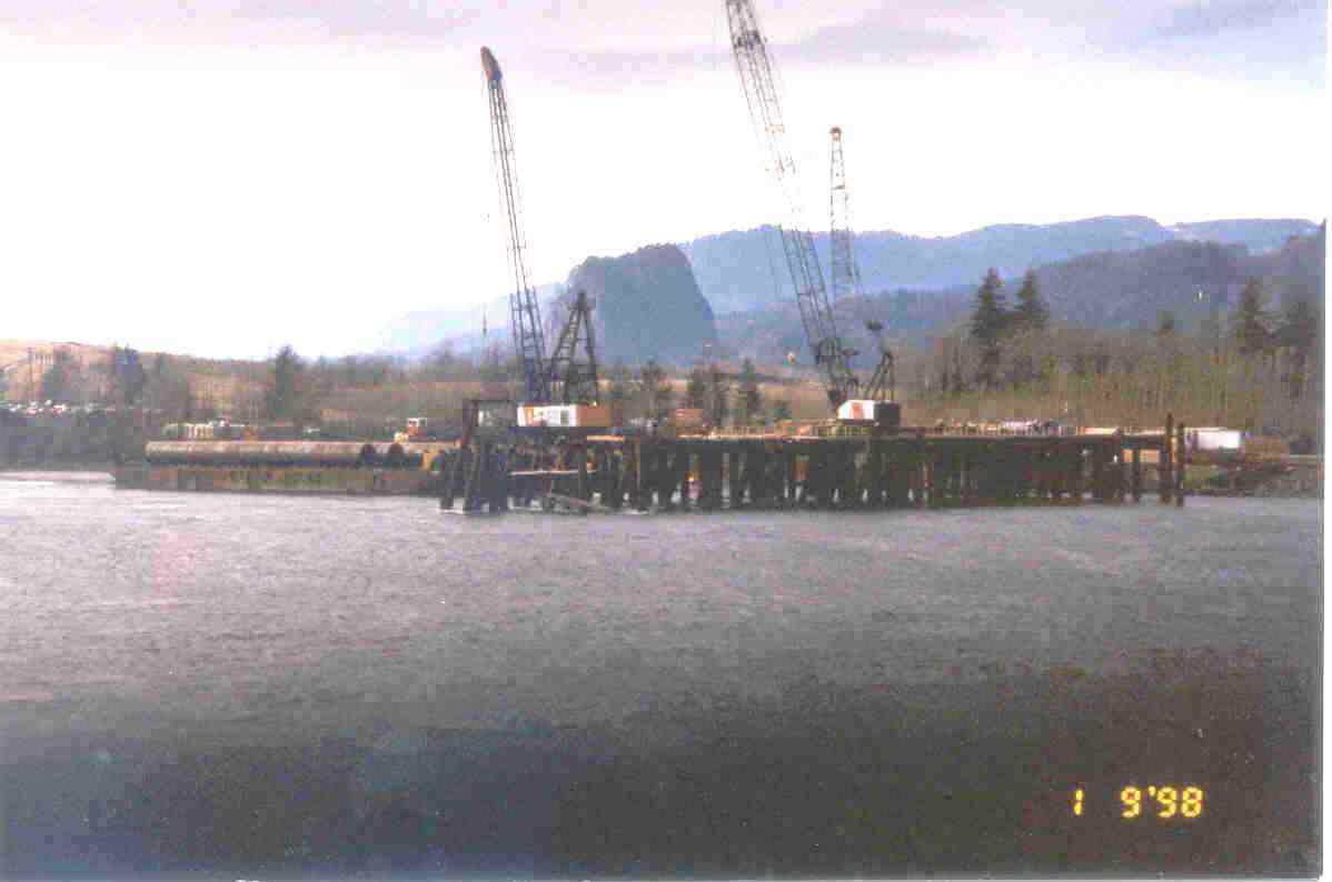

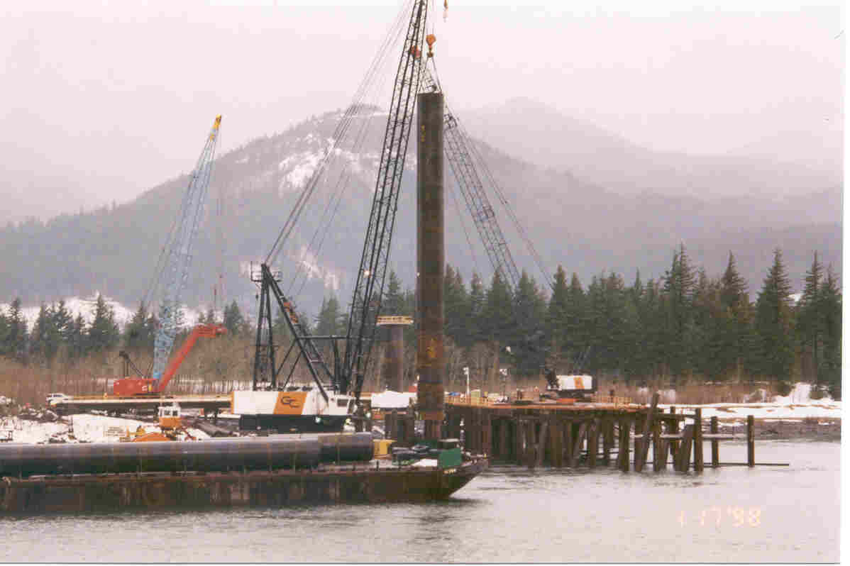

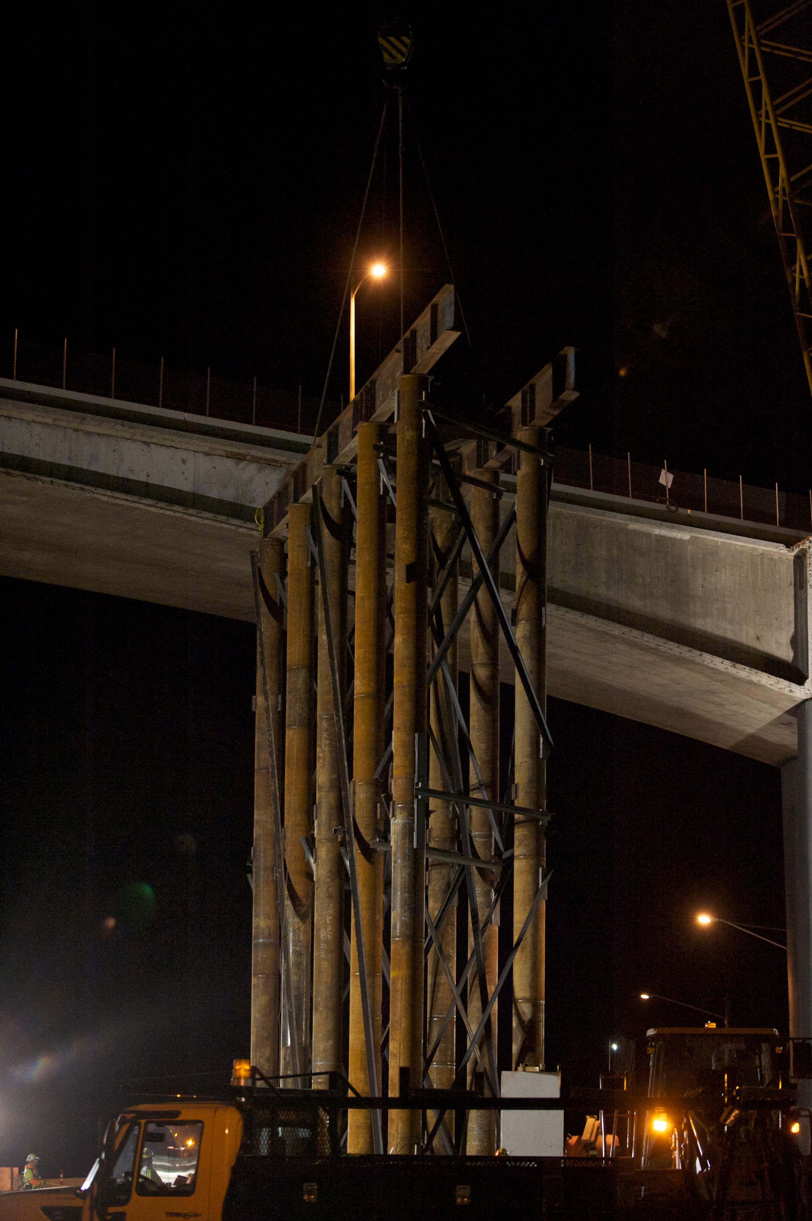

This is what I'm more comfortable building. :D

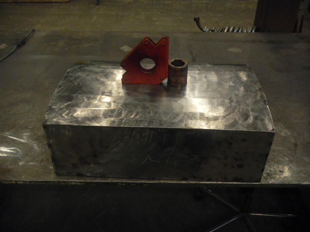

Looks nice! The TIG man at the shop uses aluminum, welds it up like a box, lets it cool for 10 minutes, and then drills the 1/8" pilot hole for the filler neck. If it whooshes when the bit breaks through he knows it is air tight.

Did you salvage the filler neck from the older rusted out tank or did you source it elsewhere?
Even you with all your skills would have had a hard time fab'ing up the filler neck with the locking flanges on the opening I would think.
/ Gas tank build.
#15
I tried using the original filler neck, but it kept cracking at the upper toe of the weld.:confused: So I cut it
out, and bought a new one.

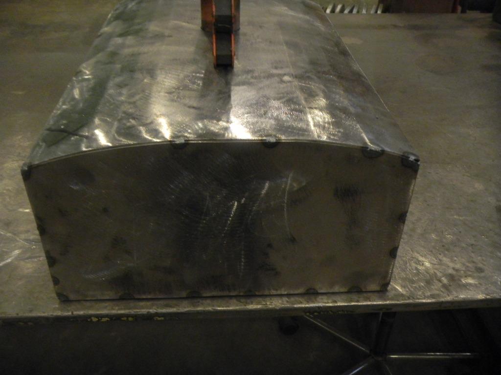

Terry any project is a learning experience. One thing nice about building small tanks, you can roll them so every weld is in the flat position.
Here is my method for welding. With steel I'll tack every 3 to 4-inches. With aluminum, I tack every inch or so. I back step all my welds. Generally don't weld more than 3 to 4 inch long welds. Then move to the far side. This really helps with distortion / warpage. And I feather grind every start and stop.
