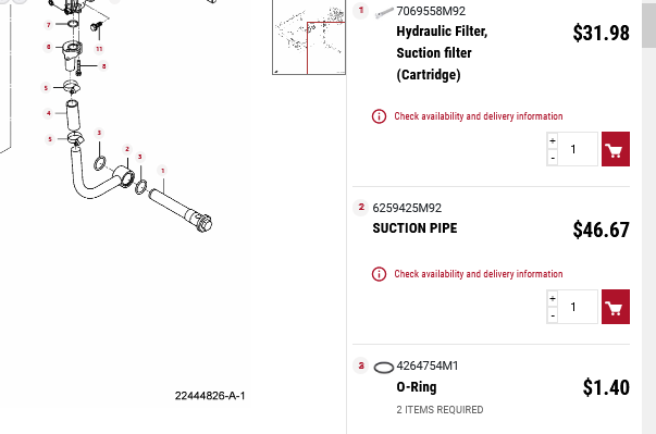

one thing you may have overlooked is the suction filter behind left rear tire. have to remove it (the tire) to check. it can collect moisture and show a bunch of white. it is serviceable. you can clean it in fuel oil dry it very well and reuse it however....be VERY careful of threads. and of course since oring cheap buy a new oring.
this is a quick breakdown of filter, oring, and suction (most likely never needed) tube for a GC1725M
Yes. It is a tricky one to get at. I was fortunate to have found a really good video,
, that walks through the process.
