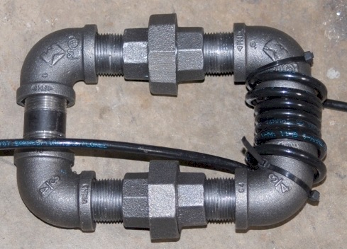

A whole house surge protector should really help. As unclean as the switch over may be, I am a little bit skeptical that the voltage would be extreme enough to kill your appliances. Generators by design don't much over 240 by design, unless they fail. I would put my money on the lightning storm for that.
On the whole house surge protector, I would try to make sure that you set up the wiring to be covered by both grid power and generator power. The general advice is to put the surge protector as close to the meter as possible, but that is likely to isolate it if the transfer switch for the generator kicks in, so you might want a second one at the generator. I would file it under cheap insurance.
If you are having power quality issues, there are ferrorresonant/autotransformers that can "smooth" the power, but they are pricey.
I saw someone who did the math for his power issue and built a homemade toroid for power smoothing;
That is a single conductor, so you need two for 240=2*120. But, no, I am not seriously suggesting that you make one.
All the best,
Peter
