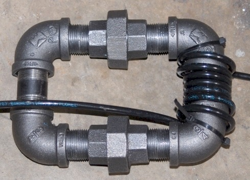

I saw someone who did the math for his power issue and built a homemade toroid for power smoothing;
That is a single conductor, so you need two for 240=2*120. But, no, I am not seriously suggesting that you make one.
