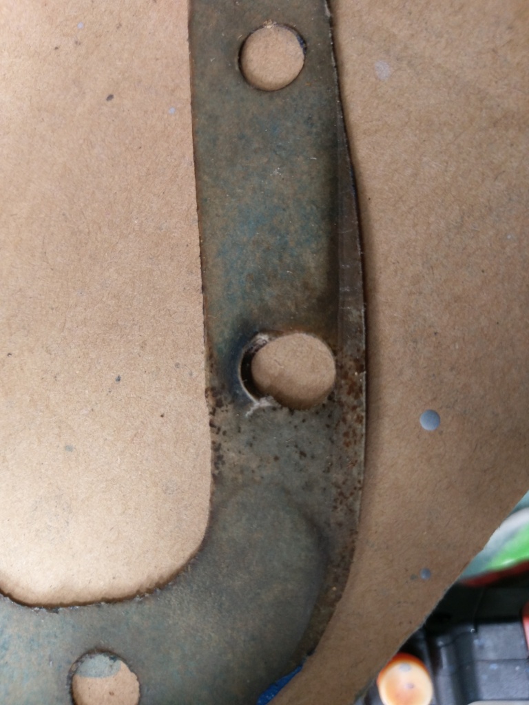

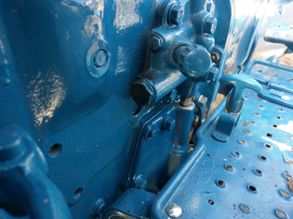

I tackled the power steering leaks again today. New copper washers, stacked to achieve the necessary thickness, solved the leaking pipe banjos but once that was sealed, as soon as the steering hit lock, oil sprayed out of the side cover gasket.
I got to thinking that perhaps the pressure relief valve in the pump was stuck and over-pressurising the system; removed the pump, stripped the valve and fitted a new O-ring but it all seemed pretty good. I pulled off the side cover and discovered that the gasket supplied in the Bareco overhaul kit was poorly made, one hole was out of position and made a path for the oil to leak out under pressure. The photo shows where the punched hole is off line with where the bolt has gone, and the incorrectly placed hole is very close to the edge of where the cover has compressed the gasket.
I had some gasket paper in the appropriate thickness so made a new gasket, coated it with quality gasket spray and re-installed the cover. No more leak.

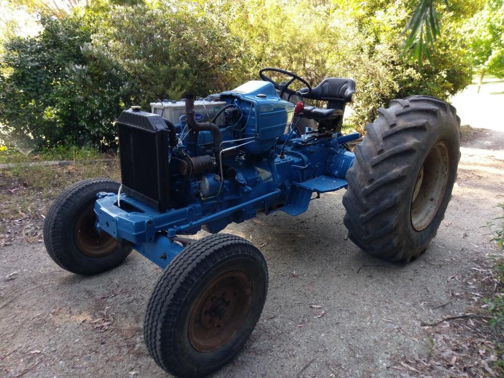

Got the wiring done today, then hooked up the throttle linkages, fitted the cowl, installed the new stop cable and DROVE the tractor out of the shed:D Still plenty to do on it but it was nice to get it out of the way for a while, I gave myself a Christmas present by working on a project other than the tractor for a few hours.

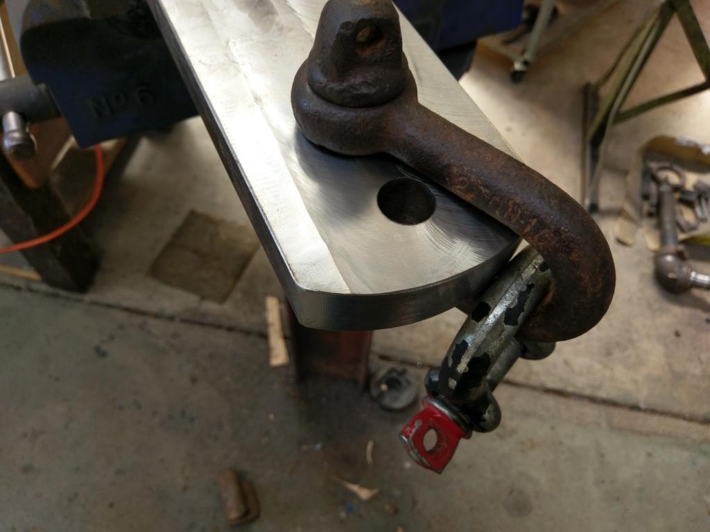

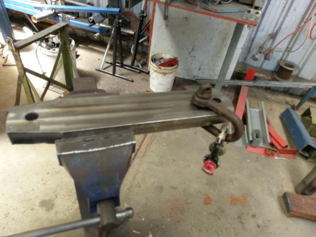

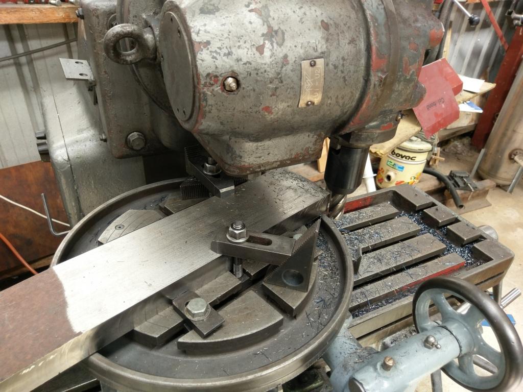

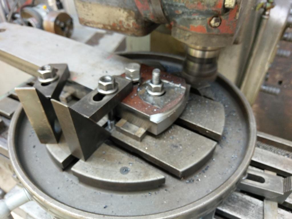

I took a break from panel-beating the badly damaged front cowl (I absolutely HATE panel beating) and whittled a drawbar from a forklift tyne. I've never had a drawbar for this tractor so have always had to pull from the 3pl, this should be much better. Steel other than the 'mild' variety is impossible to obtain here other than in round bar, so I pick up scrapped forklift tynes when I can.
Got the tapered side flat and to the required thickness on the shaper, then radiused the inner end on the mill
Bored a 1" hole at the tractor end, then a 7/8 hole for a standard towball plus a 1" hole for a heavy shackle at the outer end, then radiused the end; I initiall put a large radius on it but then decided to re-cut the radius, centering off the shackle hole so the shackle can swing. Had to taper the inner end as I have made this somewhat wider than the original would have been.
A surprisingly time-consuming job but it sure beat working on that cowl. I had no intention of engaging in panel work when I started this project but having put so much time into it, I can't put a beat-up panel back on the thing.

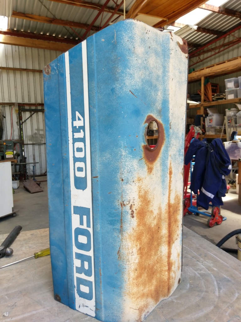

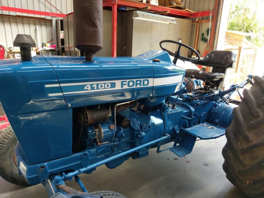

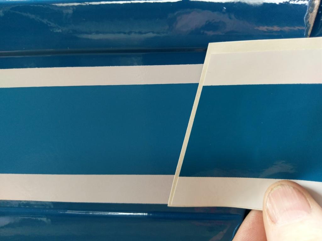

I got the front cowl and the two halves of the engine cover painted and installed. Today I fitted the new decals to the sides.

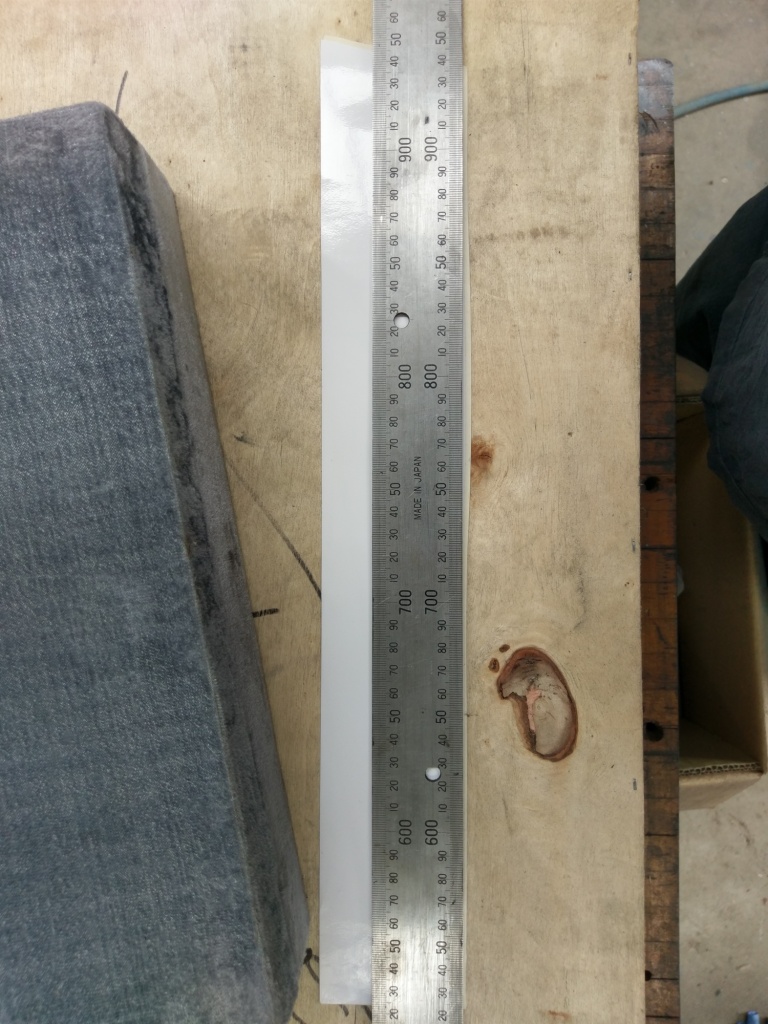

The BareCo decal kit was really appalling quality, the stripe on each side is in 3 pieces as it goes on 3 panels. The 3 pieces were different widths, the blue was a different shade from one piece to the next and the long white stripes had a crooked edge that looked like it had been cut with plastic scissors by a 3-year-old child.
I used a straight edge and a scalpel to trim the crooked edges, in the first photo you can perhaps see how straight the decal isn't when compared to the straight-edge.
This photo showcases the varying shades of blue, as well as the different widths.
Trying to make a silk purse from a sows ear, here's the result
Ah well, all the panels used to look like this, so it is definitely an improvement.
