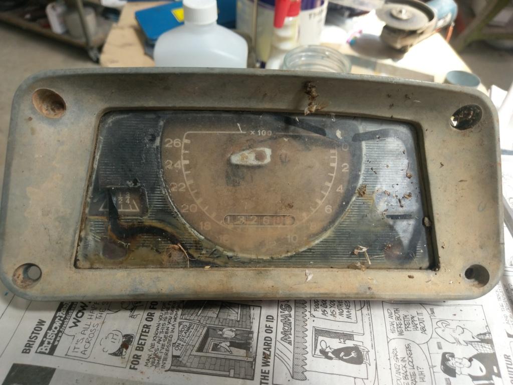

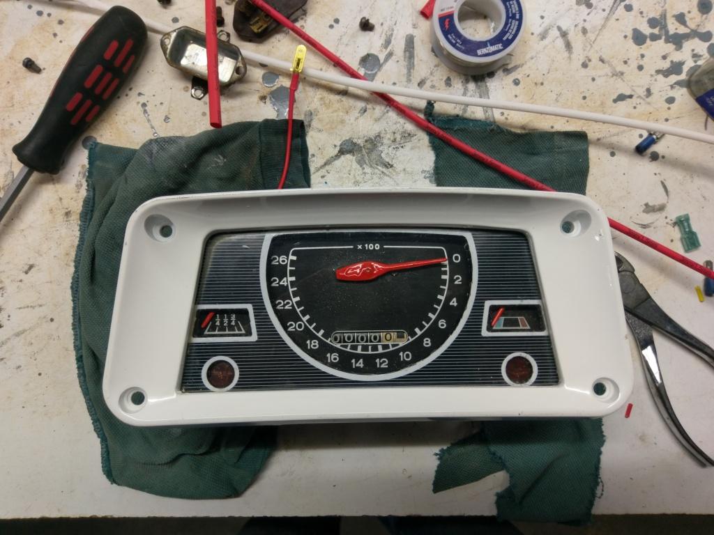

The instrument cluster was in a sad state
I found a clip on youtube
Instrument Panel Renovation - YouTube

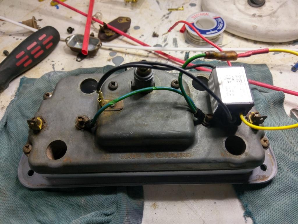

where the guy reconditions the same cluster, got in touch with the very nice chap from Missouri and he sent me a copy of the photoshopped repaired fascia he has created. I did essentially the same process Jim shows in his video, plus repairing the broken needle. Before reassembling the cluster I tested the voltage stabiliser and it was shot, I replaced it with a DC to DC converter from eBay, by pure chance the eBay component mounted to the same holes on the cluster casting that the original bimetal stabiliser was screwed to.

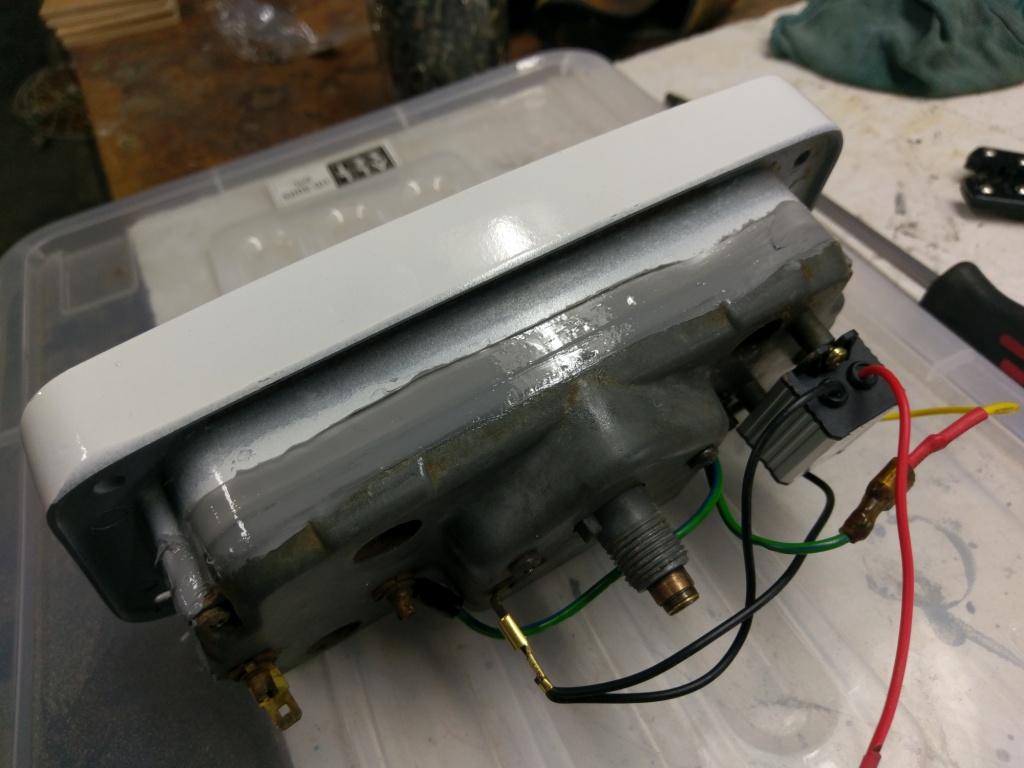

I used a modern silicon sealant to seal the two halves of the casing rather than the strip of cellophane tape originally used. I also made up a sachet of silica gel by emptying a teabag and refilling it with silica cat litter, glued it into a void inside the cluster to absorb moisture out of the assembly and hopefully avoid condensation.
The cluster came up pretty well with the photoshopped fascia, repaired needle and fresh enamel on the surround.

Do you plan on calibrating the tach?

Thanks for the comments Dave. I couldn't think of anywhere close to me where they might sell silica gel sachets, I had about a gallon of the stuff sitting around from making sodium silicate for metal casting so the teabag solution semed reasonable. I was tempted to make an instrument panel with some generic gauges but when I saw Jim's video I changed my mind. Nice to keep it mostly original after doing so much work on it, and this task was quite a simple one compared with a lot of the hydraulic stuff. I'll compare the tacho against an analogue rev counter that I have, whether I decide to calibrate it might depend on how far out it is.

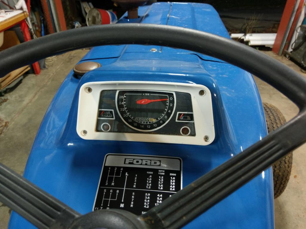

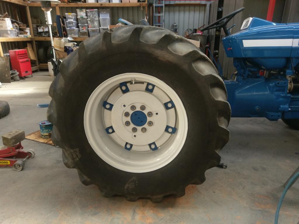

I've got the tractor back in the shed to continue the 'freshen up' that has turned into almost a complete restoration. Fitted up the reconditioned instrument cluster, here it is insitu- I decided to zero the hour meter, given the fact that it had not been working for an unknown period, the numbers displayed were meaningless. At least now it will reflect a known starting point.

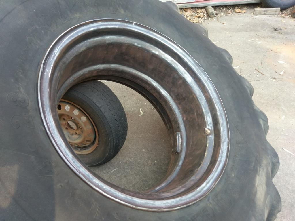

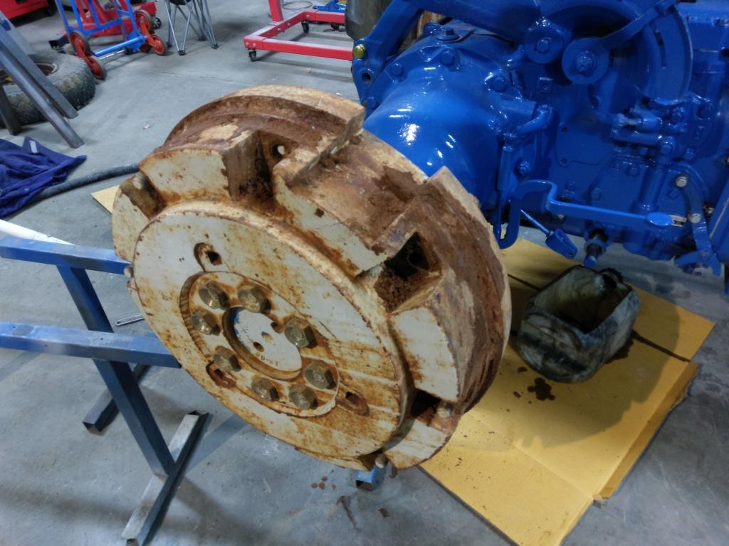

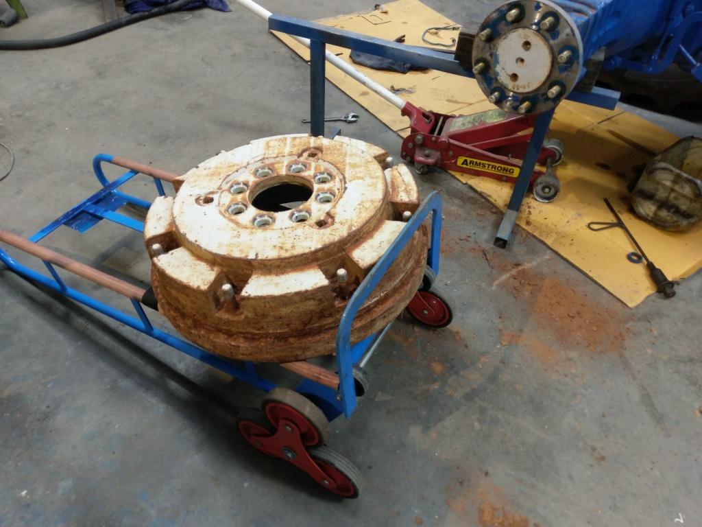

Made a start on stripping and painting the wheels, one rear wheel done so far. Wore out one wire cup wheel on the angle grinder cleaning this up.
That wheel centre casting is incredibly heavy, I had water ballast in the tyres but I suspect it may not be necessary with those wheel centres.
A bit of contrast was in order for the retainers
The end result is certainly an improvement. Who needs mag wheels.:)
I should get the other rear wheel done this week, then both the front rims.

Yes, on reflection, with the loader and my hilly property I don't want it less stable than it was, so water will go back in.
