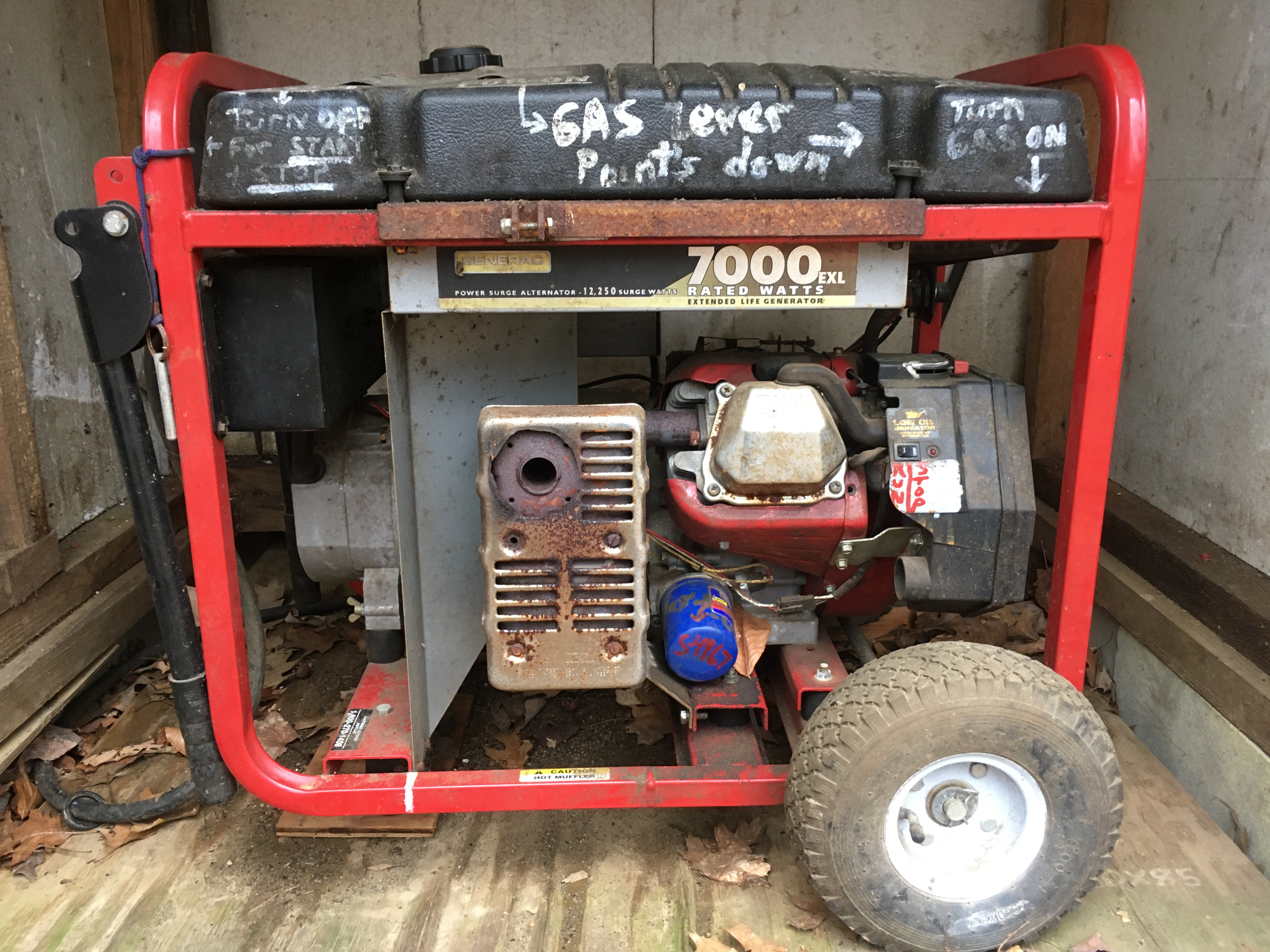

I finally decided to check the outlet voltage on my 20 year old 7000w Generac generator this past weekend while in middle of all day use. I knew it wasn't and never did put out 120v because it wouldn't run my microwave, toaster and coffee makers always took longer, I put the volt meter on outlet at the the generator and in house, the readings was 114-115 volts.
So I guess this summer it's time to update it to something that will put out 120 volts, on the assumption that they do make generators that does put out 120 volts, 119 probably would be close enough.

Have you checked the capacitors (if equipped?) and the engine RPM? I have a Porter Cable H1000ISw, it's 10k, 19.5k surge. It's got a 20hp Honda motor on it. When I first got it, the output was low- around 108v. It ran great, but didn't *sound* right. So I checked engine RPM, it was low. A quick adjustment back up to 3600rpm and it puts out 120v/60hz.
Easy enough to check, might save you money, AND even get you a new tool out of it. ;)
(new tool= laser RPM gauge)

I didn't think it's possible to adjust RPMs on a governed set motor. It sure sounds like a fast idle motor to me any faster and it might throw a rod, as fast as that motor is going it should easily be putting out 118 volts, 113-114 is not right.
/ Generator question #52
On mine it is, all it took was a quick turn of a screwdriver and it was good to go.
I wasn’t sure if that would do it but it’s been perfect ever since. Might be worth it to grab a infrared tach and check how fast she’s spinning.

The more poles in the generator, the slower it can spin. But that means more parts & more copper required. So cheap generators use the minimum number of poles & flog the engine to make a cheaper product. With people wanting a cheap backup generator, this method gets the job done with a minimum of cost. It doesnt make for a super long lasting or quiet generator, but they generally aren't used that frequently.
You could gear up the engine to get output RPM. But again at the low end it's super price competitive & the cost of gears or whatever puts that manufacturer at a big disadvantage.
Changing Generator Rotational Speed has some more info. But a 2 pole generator needs to run at 3,600 rpm where a 4 pole only needs 1,800 rpm. So generally any generator engine will need to spin at one of those RPMs.
