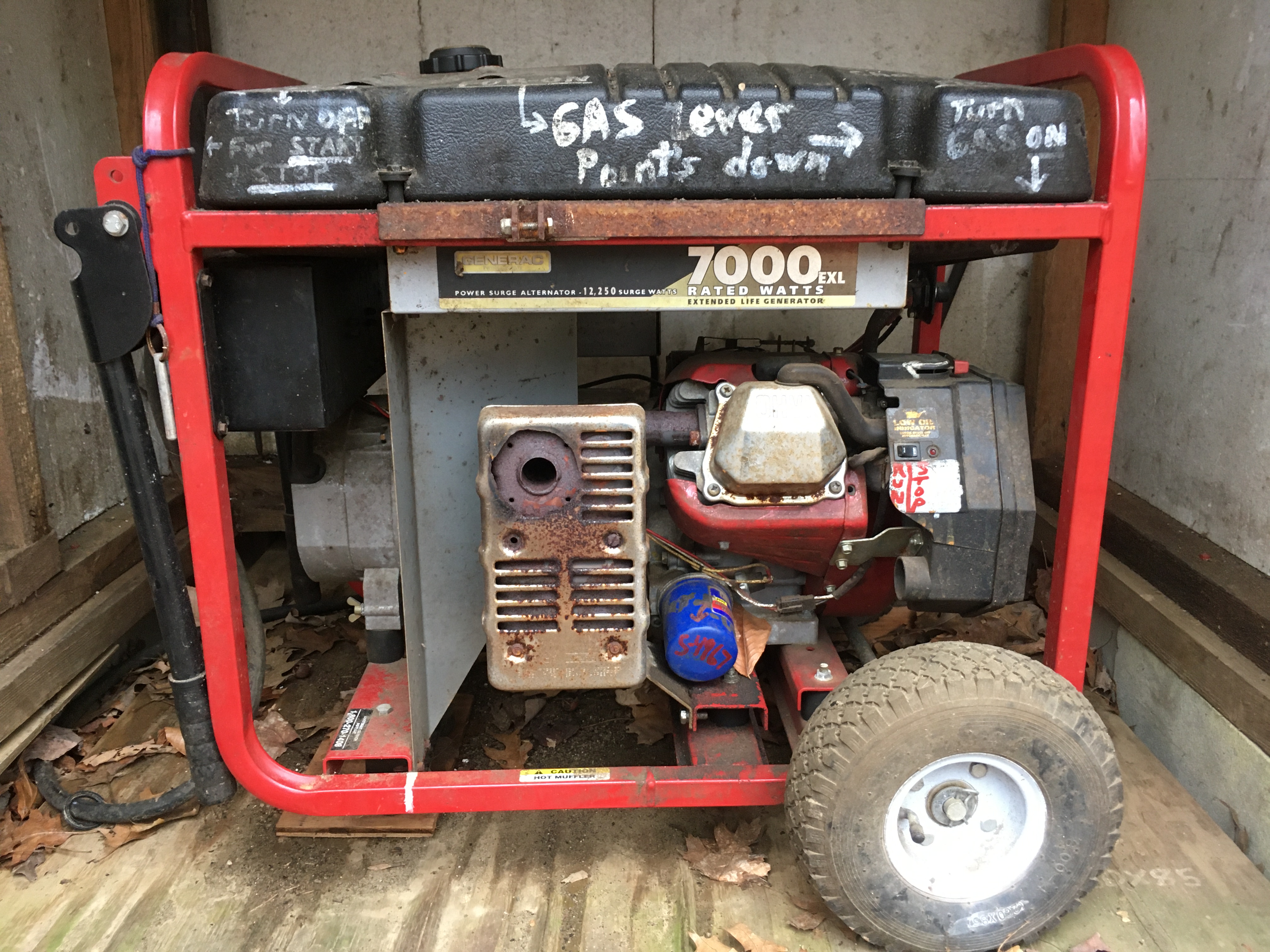

I finally decided to check the outlet voltage on my 20 year old 7000w Generac generator this past weekend while in middle of all day use. I knew it wasn't and never did put out 120v because it wouldn't run my microwave, toaster and coffee makers always took longer, I put the volt meter on outlet at the the generator and in house, the readings was 114-115 volts.
So I guess this summer it's time to update it to something that will put out 120 volts, on the assumption that they do make generators that does put out 120 volts, 119 probably would be close enough.
View attachment 651159 View attachment 651158

I had that same generator for 17 years. Easy starting and reliable. Late last year it fried some surge protectors in the house, and I found it was making 340v at the 220v plug and 170 on the 120 plugs.
I replaced the AVR without fixing the problem, and gave the generator to my electrician neighbor. In short order he found a bad connection on a wire coming from the AVR. It's back to purring like a kitten!

Holy high power Batman that's making me nervous, just the opposite of my issue. Did you get a replacement?

I really only posted to say that I got years of good service out of the Generac 7000exl, and now my neighbor will continue on with it.

Even commercial power will fluctuate 115-120 V, nothing wrong with your genset. You could up the throttle setting a bit to compensate if you want to get it in the ball park. As for heating elements like coffee maker, just about any current would work for them. 5 volts shouldn't make much difference on speed of use on heating elements, motors would be a few RPM slower but not enough to notice without something really accurate measuring the RPM.
