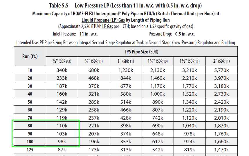

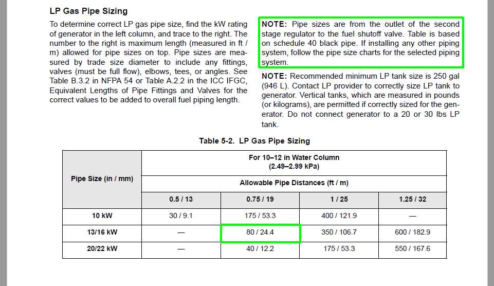

I know you said you don't like the HomeFlex gas pipe, but that's my best option for right now considering copper prices. I'm not ready to buy the generator yet, but I am ready to open the trench for the gas line for other reasons. As I said, I plan on moving the LP tank once it's close to empty and light enough to move. I need to dig this trench to the new location sooner so I can bury some other conduits for other uses. The new tank location would be somewhere between 80 and 100' from the genset location.
I currently have 1/2" copper to the existing tank location in the back yard. I have to check ... it may even be 3/8" and it's a pretty good distance ... 150' or so. That line runs the LP forced air furnace and stove. I know I'll need another regulator though for the genset.
This is all future planning so I really NEED to know if I need 1/2" or 3/4" HomeFlex pipe because I don't want to dig again later.
Charts attached are from HomeFlex and the 13K install manual.
View attachment 667655 View attachment 667656
you need to talk with your propane supplier. At a certain distance they have to upsize underground pipe depending on total BTU of all appliances. Better to know instead of redigging... at 150 feet i have no idea of pipe size.
I have no idea what to ask them. Sound dumb, don't I?
/ Generator Selection? #94
You need to make a list of all gas appliance BTUratings. There listed on each appliances nameplates. Then the btu rating on your generator. Its not hard

Furnace shows 100,000 and the stove shows 9,000 for each surface burner and 18,000 for the oven, but those are all for NG. They don't show ratings for LP which they've been converted to. No tag on the LP wall/plaque heater, but similar ones on the web show 30,000.

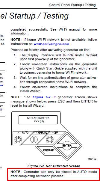

One thing I don't like is requiring Activation before something will work. Doing it for a warranty or service contract is one thing, but this says it can't be set to Auto Mode if you don't. That's kind of Big Brotherish.
Not at all, it just sets your warranty. If you dont activate it....there is no warranty. You dont have to activate the wifi option. You can even give a fake email and phone number if your afraid to give that out. But you better give correct address, or no warranty service.

Dunno. I just see this:
Talked to a local dealer and they're willing to work with me. Said they'd be willing to come out on a service call basis to complete the testing and start-up after I have all the grunt work done. They gave me quotes that are about $400 higher than Lowes base price. I get the 10% off at Lowes, so that knocks another $300+ off. I don't know how much margin these guys have or if they can even come close. I'd really prefer to buy from this small, locally owned business, but my wallet has to make the choice. If they can come close, I might even go with a service agreement with them if it's reasonable. Other thing is that Generac has a promo to extend the warranty to 10 years if you buy from one of the big box chains. That seems like they're shooting their own small dealers in the foot.
/ Generator Selection? #99
nope, the same 10 year applies to registered dealers.
But be aware.... GENERAC HAS CANCELLED ALL PROMOTIONS. im not sure if the sales person knows this. Due to the demand and the fact that generators are baclogged 3-4 months, all promotions have been cancelled. Even the big box stores. If you read the fine print, youll see that it ended in may 2020.
Does not matter where you buy it. But some of the free extended warranties REQUIRE you to activate wifi.
Personally, when i was installing these things, i could care who supplied the generator. I made nothing on supplying the unit. It was easier for me if the homeowner supplied them. That being said, if homeowner supplied it i REQUIRED the generator to be uncrated and on the concrete slab prior to my arrival. Reason was if i supply it, i bring my trailer and generator transport cart. But im not hauling that if i dont transport generator.
I made my money on the install and maint side.
