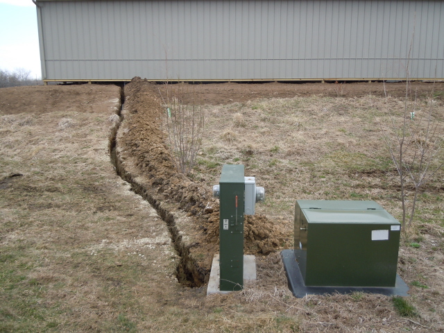

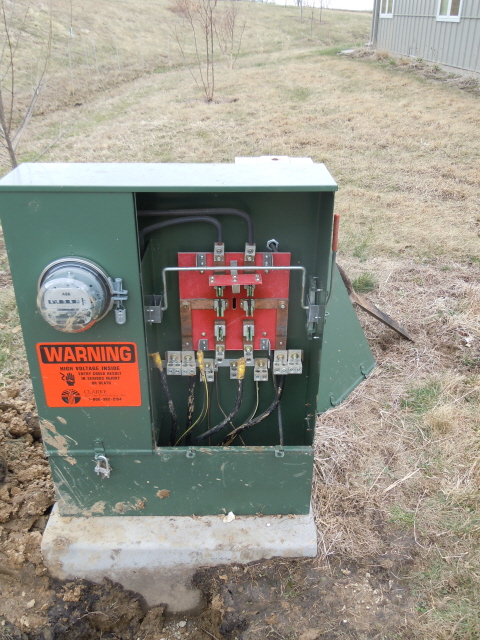

Every tombstone by the transformer on our utility has manual switch. I need to add only a male plug bolted to the tombstone and connect it to switch. (On the picture: Middle lugs on the bottom of the switch.) Then the cable between the generator and the tombstone will be male on the generator end and female on the tombstone end.
The lever has three positions:
Up: Connected to utility.
Horizontal: All disconnected.
Down: Connected to the external power source.

The male plug can not be live. The female plug must be energized by the generator and the load be the male plug.
The male receptacle bolted on the tombstone would be energized only when the cable from the geny is plugged in.
