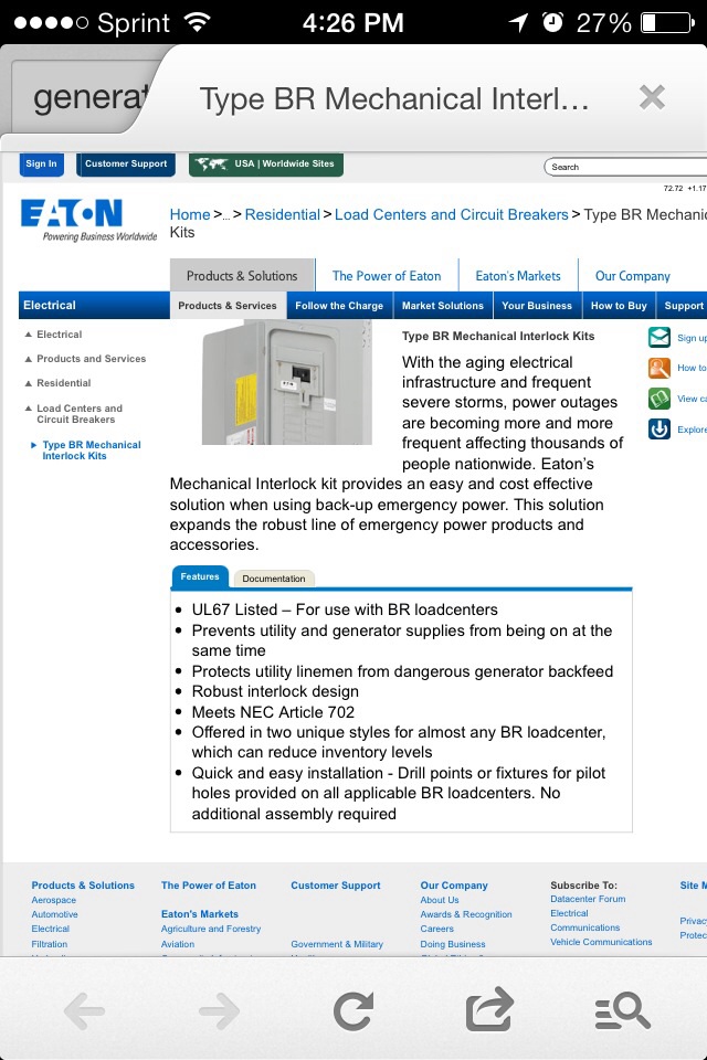

Although I agree that the interlock would not be 100% safe given an idiot can remove the cover and disable the interlock I still think this is a really elegant solution and I think the theory is sound (good job too). I do however think that without a CSA/UL sticker I would be worried what my insurance company might think if there was ever an electrical fire (related to the generator or not). They are always looking for excuses to refuse to pay!
I also wanted to throw my hat into the ring and comment on the generator backing feeding the electrical grid. I will assume straight off that this is not a great idea but I don't think the generator would do it for long before "removing" itself.
Lets say you have accidentally connected your generator to the dead utility company lines by removing the panel and disabling the interlock and having both generator and main breaker on. This would mean your generator will be driving the secondary of a very large transformer, attempting to power your house and the neighbors (on the same transformer or down the road). This will represent a very serious load to the generator indeed! I would argue that this would cause the generator to draw a lot of current and trip one of the breakers in the system (either the generators or the one in the panel).
There might be dangerous voltages on the line but not for long! I seriously wonder how many times someone would keep resetting the breaker before deciding something was up!? ;-)
I am also curious as to how you could melt all the wires in the house? The breakers should be preventing that. Any personal experiences someone might share?

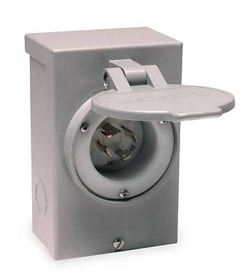

Yes on the wall is a female outlet twist lock on. same as on the generator. Thus you need a cord with a male on each end. completly safe unless you grab the male prungs that stick out. Thats the point You have to be careful . But what is the alternative? a male rescessed outlet plug?
http://www.federalindustrialsales.com/images/electrical/hbl2751.jpg
this cord end would only be live when the generator is started. So the cord is plugged into the wall outlet first then the generator started.simple procedure. And being of the twist variety I guess no one will use it in a regular outlet and find the female end live.
I dont believe there is any other alternative. thus the lack of replys other than is unsafe.
only other way i see is to have a disconnect box with a line out that would have to have a female twist to plug into the generator and then youd be relying on the disconnect to be OFF when you are not using it. padlock perhaps but far more likely to remain energized.

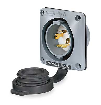

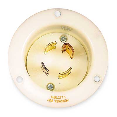

I support that the manual back-feed lock out strap works safely as advertised (if it is installed correctly), but DO NOT! DO NOT! DO NOT! mount a female outlet on the house side that you plan to power. YES there are male outlets for that side (see images). Someone with even less knowledge of this than you could kill themselves if they were to have a double ended male plug plugged into the gen set and the other side laying loose
As a Journeyman Lineman I can say without a doubt that it is absolutely possible to backfeed through a transformer and energize neighbours services. Depending on the time of day and time of year, there may be so little combined load that the generator handles it very well! And who's to say the dangerous voltage always has to be the higher voltage? 120V is more than adequate to cause ventricular fibrillation. Also, read up on shunt wound generators. They will drop off output voltage as resistance load goes up. Enough resistance load and they will run but not produce any voltage. A Lineman can check for voltage, find none, and then disconnect enough load that the generator is able to produce voltage again. This is NOT a hypothetical situation, it has happened.
Are you saying you consider it acceptable to backfeed into a transformer and produce dangerous voltages if you only do it for a short time? How long do you think you could handle 14,400 volts going through your body before you were harmed?
Once again: It is NOT the responsibility of the utility to guarantee there is no backfed condition, it is the responsibility of the customer to guarantee he cannot backfeed into the utilities system.
