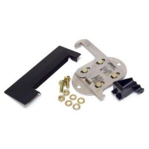

After looking around at interlock switches... if you have a mainline type panel from either GE or Square D, then the interlock kit is priced around $50 at home depot. Put in the dual pole breaker sized for your genset, proper size wire, and a inlet plug.

I use a PTO generator rated at 50 amps. I got a mechanical interlock for the service panel. It's 200 amp and GE brand. I put that in back in 1983. Couldn't find the slide interlock for that style as they have changed over the years. I got measurements and kept looking at different interlocks till I found one that was close enough to use. Had to mill it in the slots to extend the length a little and cut the tab that blocks the generator breaker to make it fit. It works good.

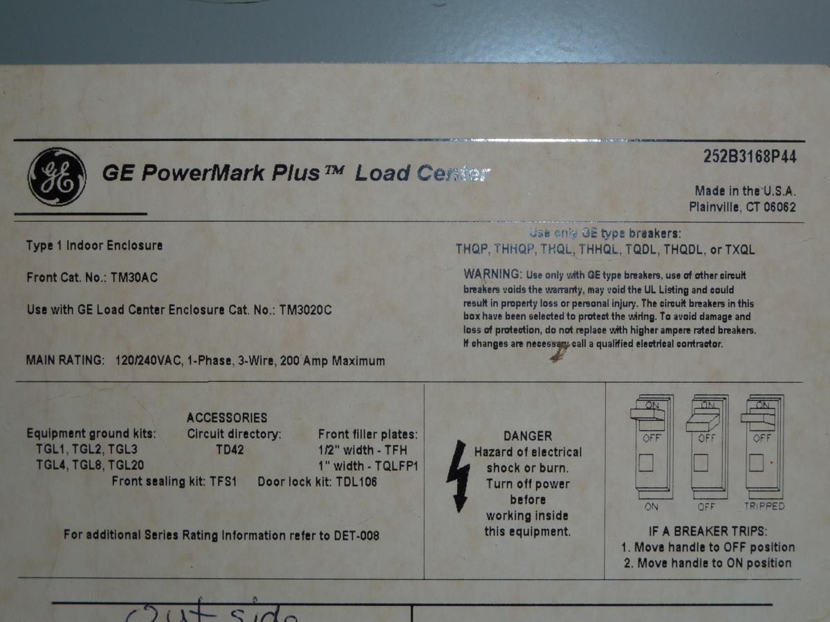

/ Generator Transfer switch connection choices #33
Does your panel have a vertical Main Breaker?
Our house was built in 1994 and we have a GE PowerMark Plus 200amp 30 space load center.
I'm looking for an interlock to fit it but the GE model THQLLX1 appears to be for PowerMark Gold models.
Generator Interlock Kit from GE | The Home Depot - Model THQLLX1
If yours is similar to mine could you post pic's and a link to which interlock you started with?
Thanks.

/ Generator Transfer switch connection choices #34
Thanks.
I bought mine in 1984. It's 40 space load center. Looks similar to yours but has one extra slot at the top on each side that says not to remove and has a vertical main breaker like yours. I used an interlock that was for a SquareD K5410 and modified it.
I used Generator InterLock Kit and look at Generator InterLock Kit - General Electric Kits K-8110 that perhaps will fit your panel.
