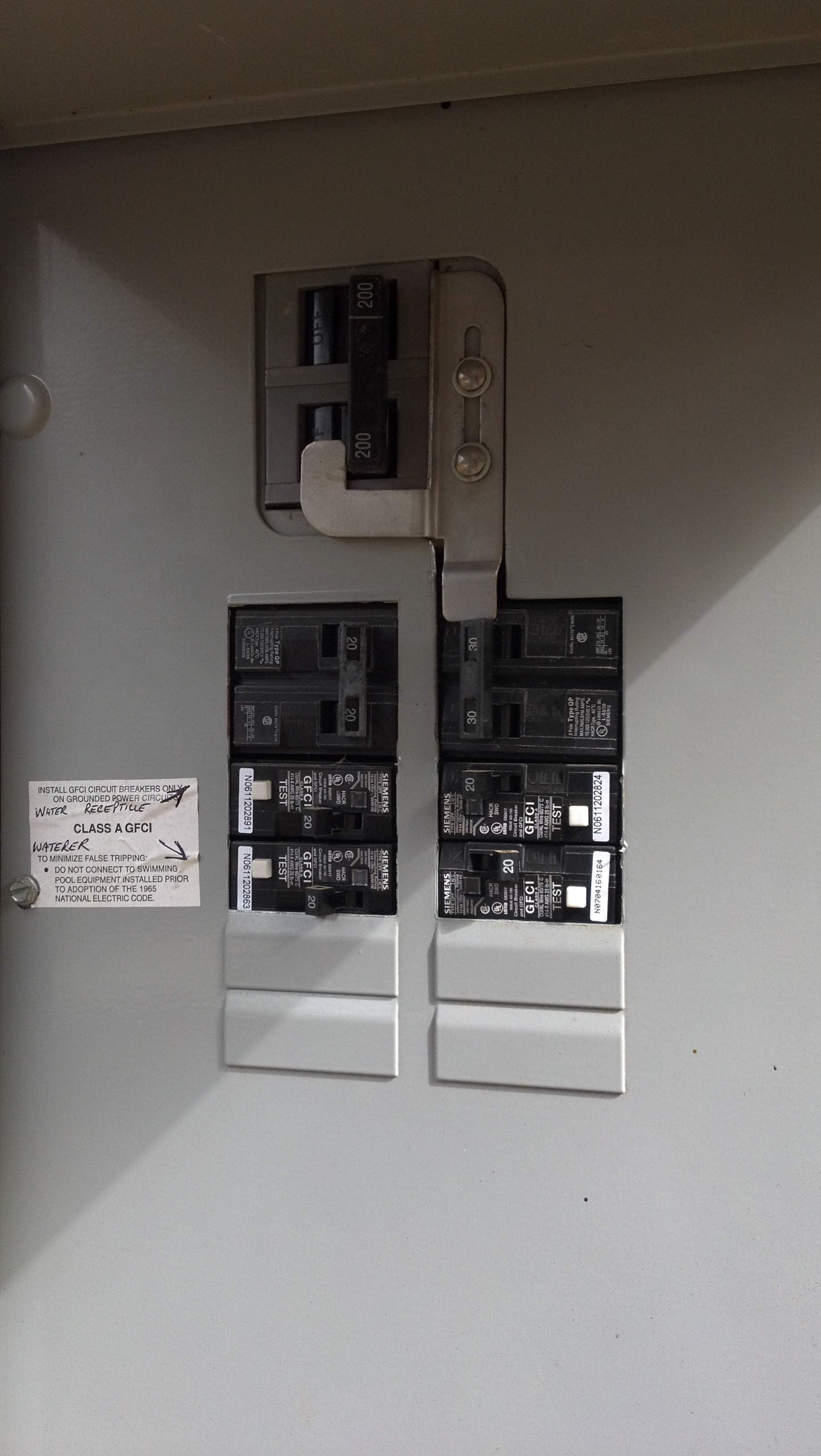

Howdy,
"The interlock"
The interlock makes it so only 1 breaker can be on. The main panel breaker, or the generator breaker. So, you turn off the main 200amp breaker, slide the metal interlock, and now you can turn on the generator breaker.
View attachment 272502 click on the picture to see larger, then click again to zoom in.
Your panel needs to have a interlock kit for it. It usually needs the 2 top right spaces for the generator breakers. If your panel is full, a lot of times you can get half breakers to help make some room.
I like this option a lot because I'm not spending a lot of money on a temporary transfer switch that would be unneeded some day when I get a generator big enough for the whole house. My thought was use one of these and then flip off all of the breakers I don't want to power before I start the generator. The one problem with this plan is this approach doesn't provide a meter that shows how much load I'm putting on the generator. Is there a way to put a meter on the panel that would be active when the the interlock is flipped and the generator in use?

Howdy,
The interlock kit does not have a certain amperage limit. The limit will be the size of dual pole circuit breaker you can find to fit your panel. Most folks use a dual pole 30amp breaker.

As mentioned here, I have a 400 amp service that feeds two 200 amp main panels.
I bought a TED 5002 to monitor my energy usage and confirmed that a 15KW PTO generator would suffice.
I bought two Square D QOCGK2C interlock kits and two 50 amp double-pole breakers to occupy spaces 2 and 4 of each panel:
I bought a Reliance Controls MB125 50 amp meter box to monitor load balance.
I bought a GE 50 Amp Twist Lock Power Inlet with L14-50 connector (larger and more robust than the popular Reliance Controls PB50).
I bought 3/4 in. Flex Aluminum Conduit and 8 gauge THHN wire (rated for 50 amps and much easier to work with than Romex 6/3 with ground).
I bought a Conntek 1450SS2-15 Temporary Power Cord with NEMA 14-50P Generator Plug to CS6364 Locking Connector.
Now I am trying to wrap my head around the parallel neutral path that this approach would introduce as discussed at length in this thread. The neutrals are presumably bonded at the meter and to ground at the disconnects between the meter and each panel. I don't yet understand 1) why a secondary neutral is unsafe if it's of the same gauge as the primary, or 2) why it would be unsafe to connect the generator neutral to only one panel to leverage the existing primary neutral connection to the other panel. Worst case I can order another inlet box and associated wiring to connect each panel separately, in which case the parallel neutral path would exist only when the generator is connected via a Y cable. Thoughts?

Here, they wouldn't let me use the two, 200 amp main panels for a disconnect. Had to be a manual, knife type. Absolutely no breakers. Engineer told me current can jump across a breaker. I'm thinking more of a safety factor for lineman, in case someone doesn't kick the main panel, and back feeds out on the main line. With a manual throw disconnect, there is no way that can happen.
An interlock kit ensures that only the 200 amp main breaker xor the 50 amp generator breaker can be switched on at any one time. With the 200 amp breaker switched on, no power from the generator hots can reach the panel. With the 50 amp breaker switched on, no power from the generator can reach the main line hots. Breakers do not switch the neutral, so perhaps that is what the engineer meant by "jump across a breaker," though 1) I don't see how the number of panels involved makes a difference, and 2) I don't see how this is a safety concern for lineman considering the neutral is grounded before it leaves the meter.
