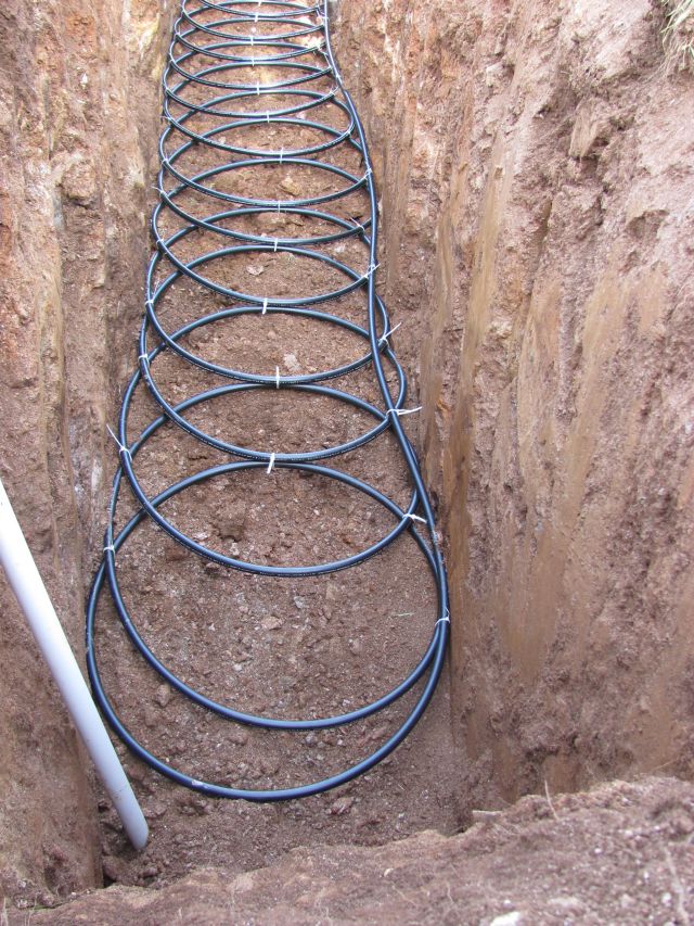

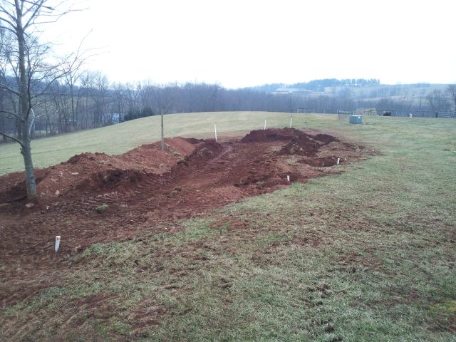

   / Geothermal heat pump install with crawlspace encapsulation #29
I have added once for settling, and needs it again.
added some pics, because TBN loves pics.... :)
