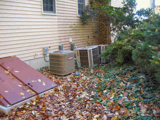

I will give a blow-by-blow of the installation of a geothermal heating system in my home. First for the disclaimers and "don't attempt to do this at home": Although I am a trained engineer and a very mechanical hands-on guy, I also have a small side business installing and servicing HVAC equipment (A/C and heat pumps primarily). As such I am EPA licensed and have over 18 years of involvement with the HVAC trade. This is not a simple or easy project, and a wide range of skills are needed.
The project started when I decided early last year that I was tired of fixing the inevitable breakdowns that occur in my existing heat pumps every winter, usually when it is 15 degrees out and blowing snow. My existing heat was a 2 zone/2 air heat pump system, 1.5 and 2 tons, a for 2200 sq-ft house (2 years ago I added a new 1.5 ton unit for a new 500 sq-ft addition to the house). The existing York units have been very good, reliable units that provided good comfort at a reasonable cost (all electric average $175/mo the last few years). But given that they are 18 years old (7.8 SEER), every year seems to bring some little part failure. Usually not expensive, but a pain to fix at those odd and usually cold times. At least I have the benefit of not haveing to call a service guy, so I get it running more quickly.
Anyway, I had wanted to install ground source when the house was built, but the technology was relatively new 20 years ago and priced way beyond my budget. Now I decided it was time to do it to lower my utility costs and have a more reliable system. Part of this was pre-retirement thinking, although that is 10+ years away. Little did I know when I made the decision and planned the project that the energy costs would take off later in the year and make my decision all the more wise.
I did a lot of research through the internet, books, seminars and networking with other dealer/installers. By spring the project was going full speed.

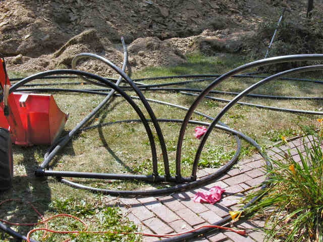

As Bob was digging, I made up the first header and coupled one end of each coil to the header. The line ran vertical to an elbow and a straight run to the house.
