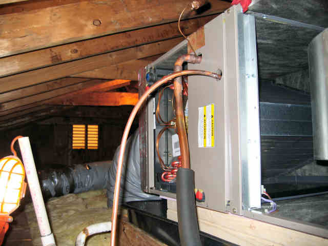

#41
Connections made. Height clearance was under 3'
paul

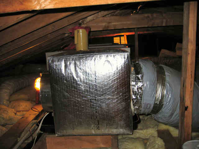

   / Geothermal Heat Pump Project
#42
Almost finished. new plenum box on the discharge end.
paul

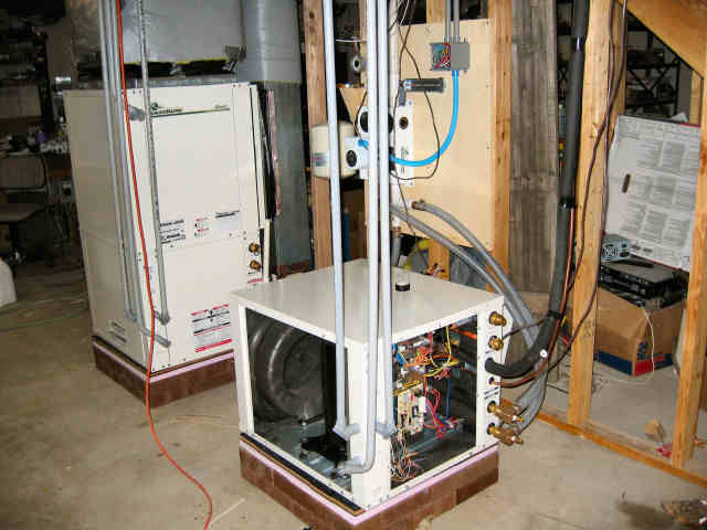

#43
Chapter 12

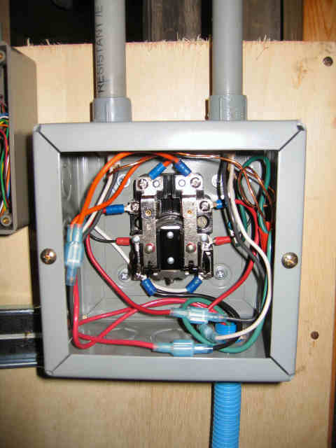

With the attic finished, the 2nd floor compressor was installed. Mounted the same as the other unit, electrical, freon and water connections were made. The freon lines were triple evacuated and charged with the required amount of freon. The second unit was flushed in the same manner as before, and the loop valved to both units. The unit was started and performed as expected. The only real difference was that the long (60') freon line runs make it slower to get full heat output on the second floor unit as compared to the first floor system.
As stated earlier, I installed a 240 volt power relay for the circulator pump. Each geo unit has a power out to the circulator, which energizes when the unit runs. Since there is only one circulator for two units, the relay is used to operate the circulator when either unit runs. ClimateMaster makes a module to handle this task, but the relay was 1/3 of the price and simple to implement.
I also deviated from the trade norm which is to have the thermostat and compressor wiring all connect together at the airhandler. Since the airhandler was in the attic, in a not so easy to get to spot, I decided to bring all low voltage wiring to a central J-Box in the basement. This was If I added or changed anything in the low voltage wiring, I could do it in comfort, standing up.
More on Chapter 13
paul

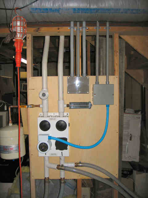

#44
Circulator panel with both units connected. On top the low voltage J-Box and relay.
paul
#45
Showing the inside of the circulator relay enclosure.
paul

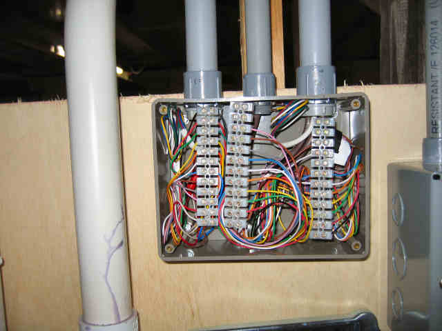

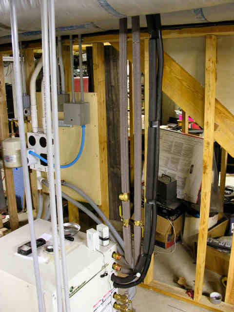

#46
Low voltage J-Box. This has the wiring for both units.
paul
#47
Chapter 13
The final phase of the project was the connection of the desuperheaters. As described earlier, each unit has a small heat exchanger that removes compression heat during heating and cooling operation. This option includes the heat exchanger, a small circulator and a thermostat limit switch. The desuperheater can put 1000-1500 BTUH per unit into the domestic hot water. While it can be connected directly to the existing hot water heater, the capacity of this recovered heat can be lowered. This is because the water in the HWH can be 120 or 130 degrees, which is near the desuperheat temperature, so with little temp difference, heat transfer can be reduced.
The better (but costlier) method is to install a second HWH that is used to store the recovered heat and act as a preheat tank for the main HWH. I chose this method. I installed a non-powered 50 gallon tank. The inlet is from the water supply, and the outlet feeds the normal powered HWH. The desuperheater system circulates water from the added tank, warms it and pumps it back into that tank. With the two geo units, check valves are added to each desuperheater water loop to isolate the flows and prevent cross circulation.
Beside the required piping, I added shut off valves and connections to each tank. This allows me to run the normal HWH as before or have it fed by the preheat tank. I can also use the preheat tank as the only HWH. In this mode I could hook up the power to the tank in the event of a failure on the normal tank.
In operation, depending on the run time of the geo units and out hot water usage, the preheat tank runs between 80-95 degrees. This warm water feeds the main HWH, instead of 50 deg well water. This is direct KWH savings for hot water. A very good feature that should always be included, in my opinion.
#48
Showing desuperheater piping (gray insulated) on the geo unit.
paul

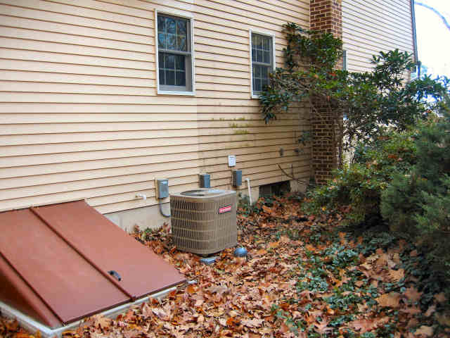

#49
New outside look.
paul
