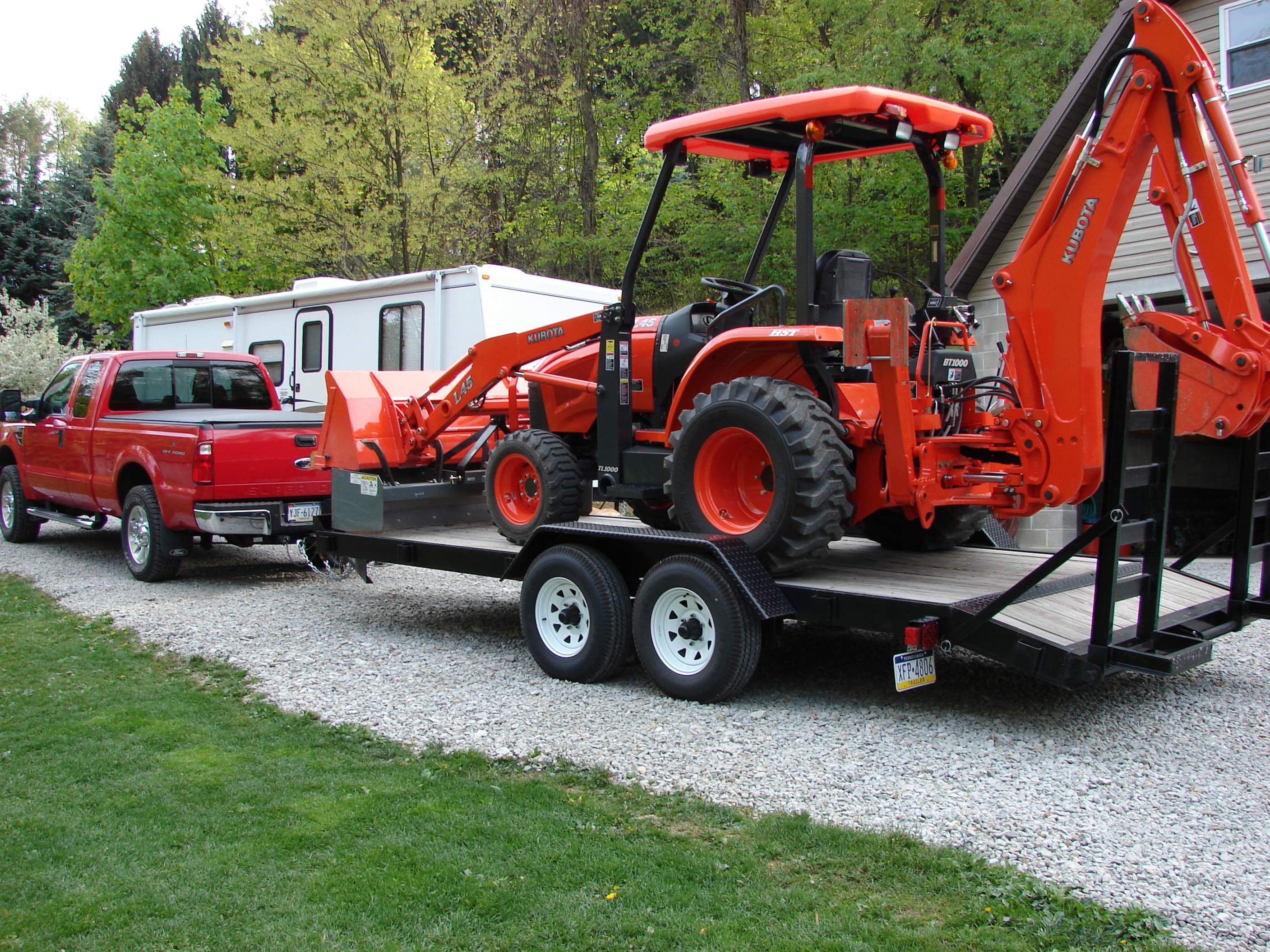

Here is my L45 at 7200lbs and my!! 10k G.V.W.R trailer. This is legal that I know for sure. If I had a 12k G.V.W.R trailer hook to my truck empty I would get a fine because I don't have a class A CDL.
Another thing some people need to read is the difference between G.V.W.R & G.C.W.R.

Ok one more time when the trailer is in excess of 10k you now have to get the next class of licenses. Period!! Look I drive and haul one day in and day out have been stop many times . You are wrong you look at it that if you don't meet both parts of the equation you can tow what you want. You can't!!
Look lets say a tractor trailer bed 18 wheeler. Weighs in at 15k empty and my F250 is at 8k so I can just hook up to it and go. 23k total. You will have your ***** FINED OFF.
