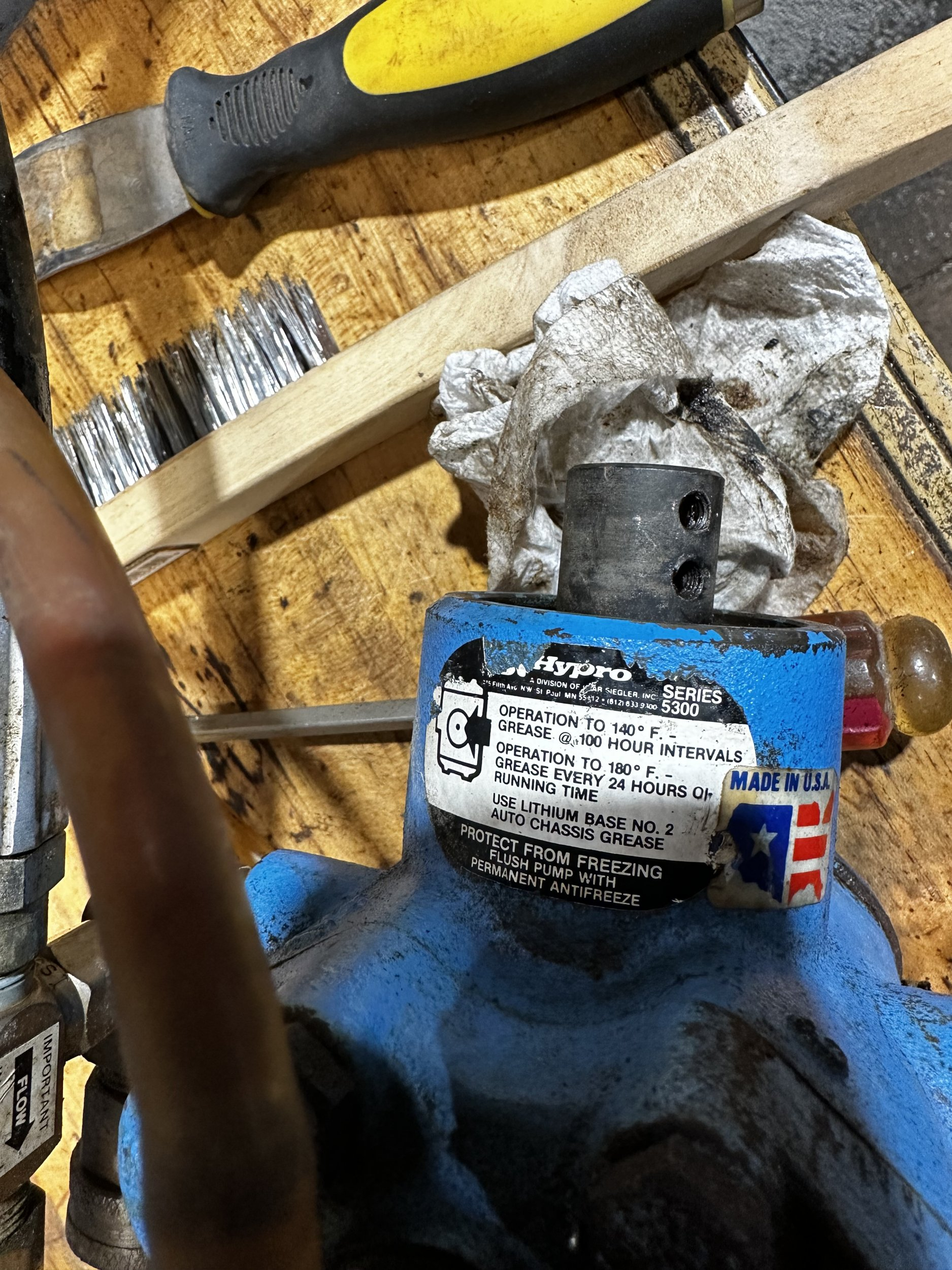

The cast iron welding repair is still leaking. I welded it in place and it is difficult to do successfully. Looking for a replacement pump
You could try to seal it up with bronze filler, it will usually flow out on cast iron as well as the (likely) nickel filler.

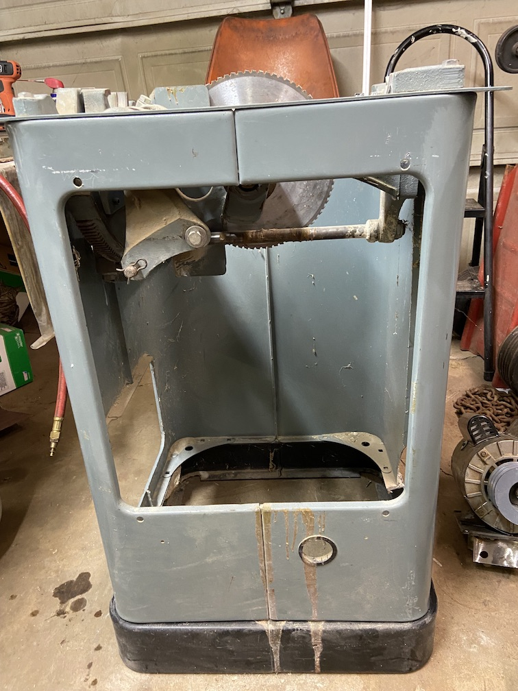

Also confirmed that the motor amperage is 7.8 amps and it was a 3 phase saw originally (on the plate in the picture below)
Probably a good chance that the 3 phase motor is the original.

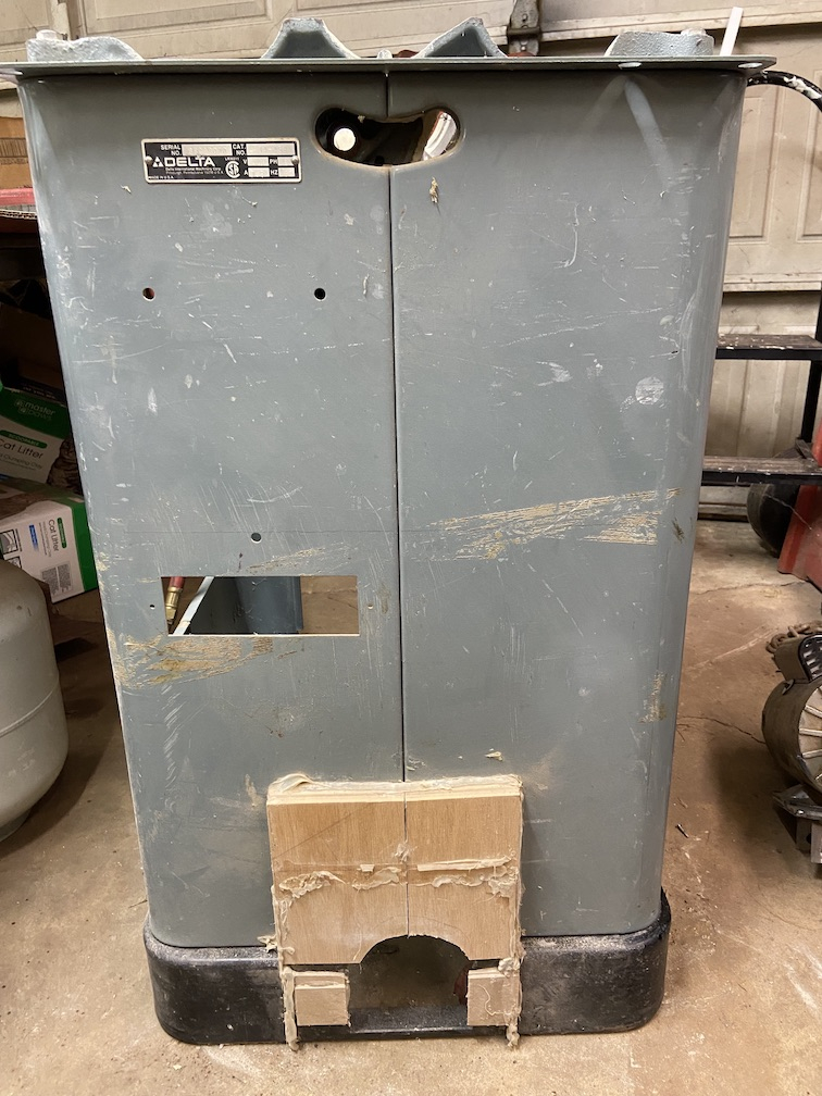

Made it around to rear side of the saw. If there's one unfortunate thing about this unit, it's this little "modification":
Whoever did that little bit of butchery should be beat profusely with a large stick.

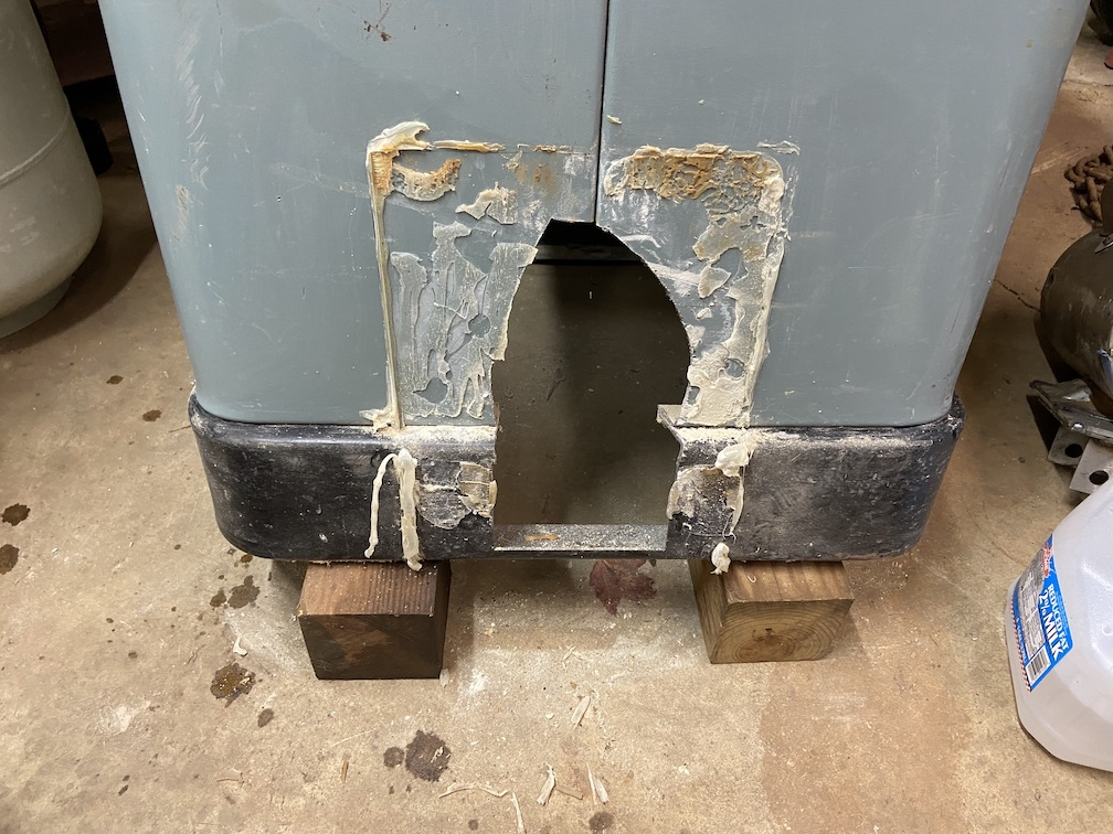

I did manage to remove the wood piece and a good amount of the silicone caulk ... hopefully with no further damage to the metalwork of the cabinet:
Today I'll take up the McKanica Silicone caulk remover and see if I can get the remainder of it off while I ponder how I'm going to repair the damage done to the cabinetry.

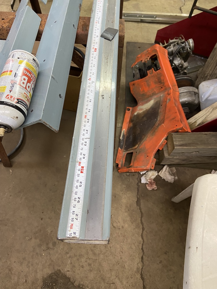

After working on the back, I took a break from the cabinet and started working on detailing the Biesenmeyer fence, using rubbing and polishing compounds and wet-sanding with 320/500 on the bare metal parts:
The sacrificial rail on the blade side of the fence really needs replaced (or at least an additional rail added to it) ... as it's had contact with the blade at some point. (The one on the non-blade side cleaned up nicely)
But examining the fence I was at a loss at how to go about doing that ... since there are no visible fasteners attaching it to the metal portion of the fence.
Fortunately, Google and YouTube revealed the answer: The fasteners are hidden under the Formica laminate ... so that has to be removed to access them.
Will probably go ahead and replace the black edging on the fence rails as it's pretty beat up and is fairly cheap.
Next up was tackling the right side of the cabinet, which has the hole to access the motor:
I suspected that stuff that had run down the side at the bottom might be contact cement (used to glue laminate) and it turned out that was the case. A combo of Goo Gone and the Wagner Heat Gun set on low allowed me to remove most of it:

Take a jig saw and clean up the mess of a cut that is there, make a pattern out of cardboard the fits the hole when you are done and use that to cut out a piece of steel to fit and weld it in. If you can’t weld it yourself it would be an easy job for someone that has the equipment and skill if you brought them the cabinet and the piece that you made.
