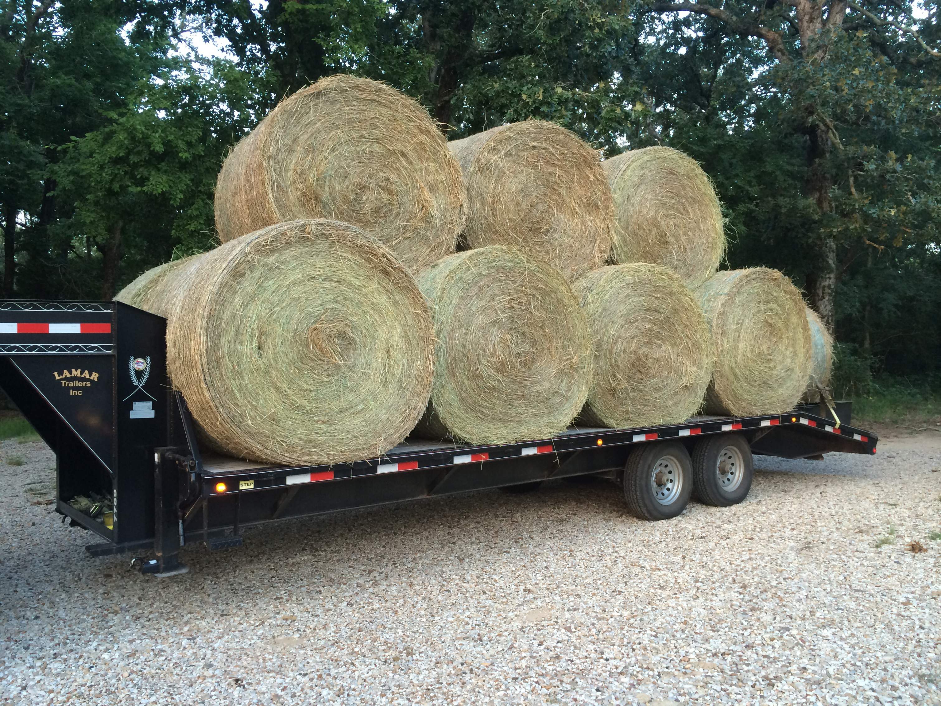

Below is a photo of my 20 foot GN. She carried 14,000 pounds. Weight on the axles was 2600 pounds, giving me 11,400 pounds of carrying weight. My tractor weighs 11,300 pounds. Adding the grapple onboard with a bucket over grossed it. This is why I upgraded to a longer, heavier trailer. She pulled like a dream empty or full at "high" highway speeds, just like my dual tandem. With my Ram 2500 and my Ram 3500.............I can see the GN ball while backing up to hitch up. This is why I don't have a bed fuel tank. I could put this 20 GN in places a 20 BP trailer would never dare to go.5-14-07 ALL Red.jpg
Oh yeah........only reason I upgraded from a Ram 2500 to a Ram 3500 is pulling all this weigh in the Texas Hill Country. I routinely pulled with the Ram 2500 way over the trucks rated pull.
Farm tags keeps all the legal stuff simple.
hugs, Brandi
