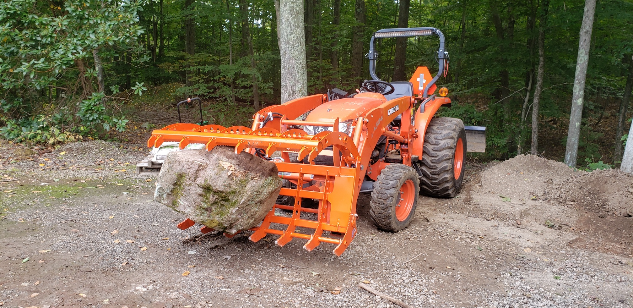

I have it on my 38hp Kubota. Its a great tool. I've used it to clear and move good sized logs in the woods as well as pick up some pretty big potatoes to be used as landscape features. For me it's a must have and a joy to use.

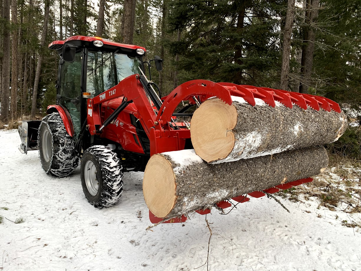

If you're looking to move heavy logs then you want to pay attention to the grapple's weight. The heavier the grapple the less log weight you can lift.
I have an EA wicked grapple, the long lower tine type. I think that's a good compromise for handling both logs and brush. If you're just handling logs there are dedicated log grapples which are lighter and cost less. Short tine root rake grapples might do a little better on logs but have less capacity for brush.
One drawback to the log tine style is that when I pick up a heavy log I may not be able to curl the loader back. The long tine puts the log's CG a bit farther from the pins if you picked the log up from above. This may not be an issue for another loader. A few times I have ended up carrying a log with the grapple facing down.
I have a 60" wide grapple and could have gone with a 55" or even 50". I thought I'd be able to grab firewood rounds with the grapple and wanted the extra width for that but it turns out that's not easy. I changed how I process wood so I don't do that unless the logs are so large that the grapple's jaws won't go around them. For logs and brush a slightly narrower grapple would work just as well.

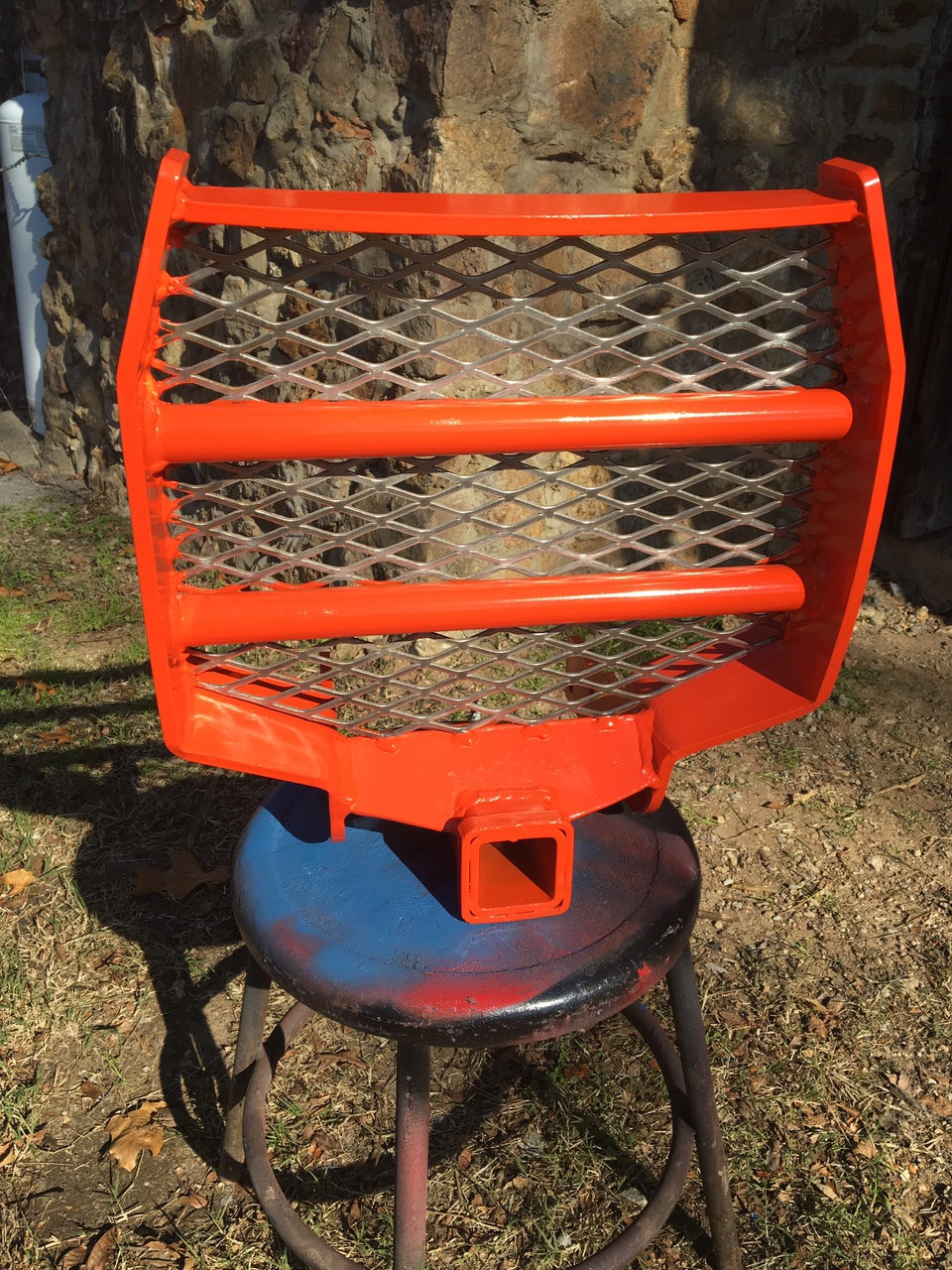

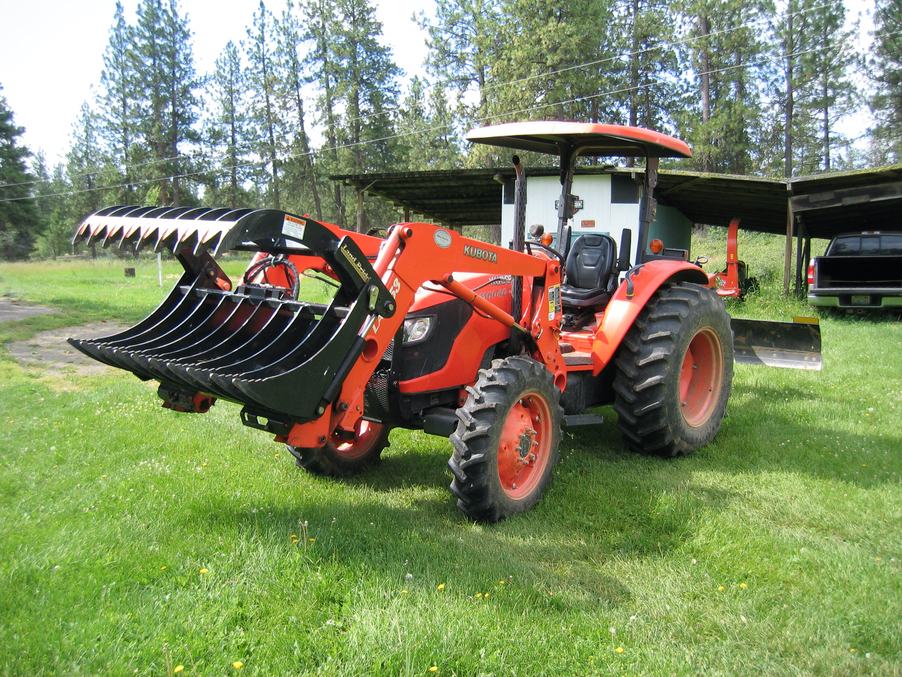

Have 54” wicked on the [AFFILIATE=1, nofollow=true, newwindow=true, title="Kubota"]Kubota[/AFFILIATE] B26 and love it. Don’t want your grapple too wide compared to a GP bucket. Dual lid, long bottom a must for my brush work.
Added front grill protection a must have.

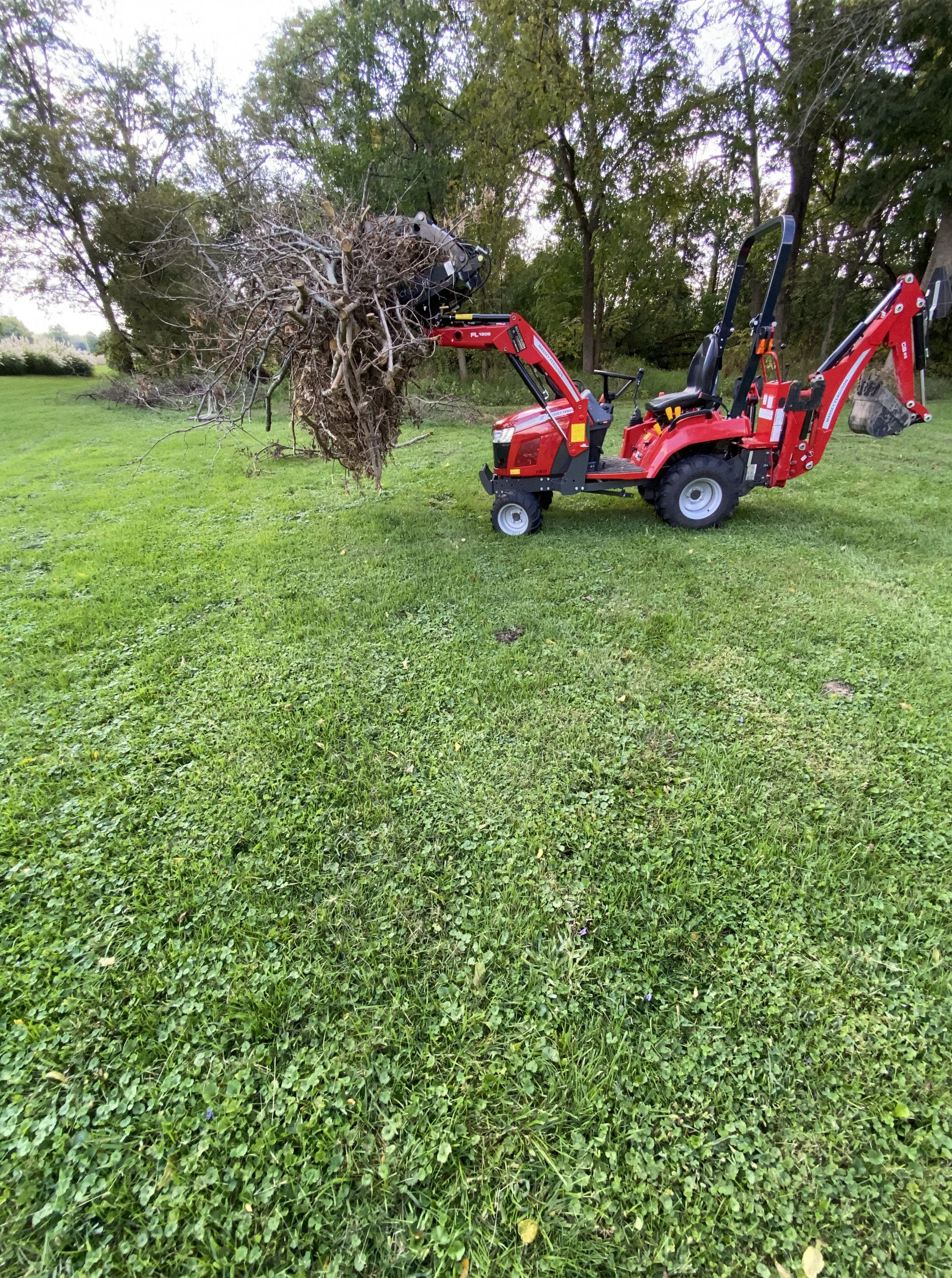

I had my dealer install a 4 foot CID grapple on my little 23 hp Massey. He did all the hydraulic hook up. I have a little rocker switch on the loader joy stick . I can operate everything with one hand. I love mine and I bet you will love yours.

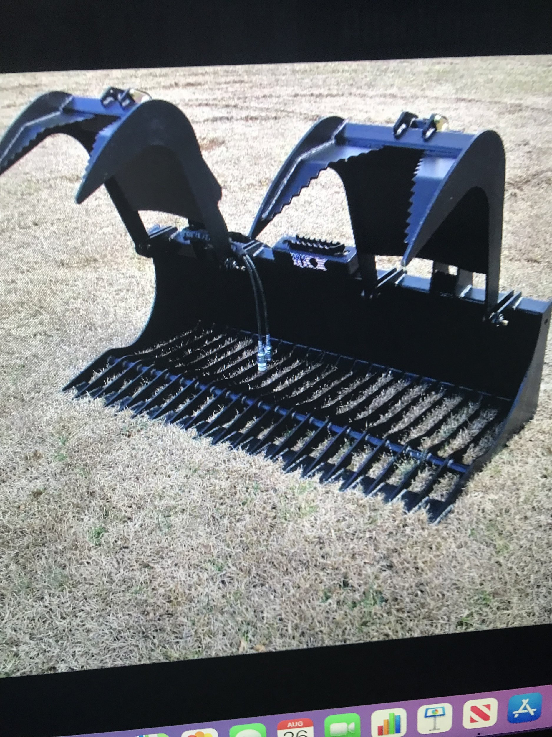

I am currently shopping for a grapple for my 40 hp tractor. I am leaning towards this one.

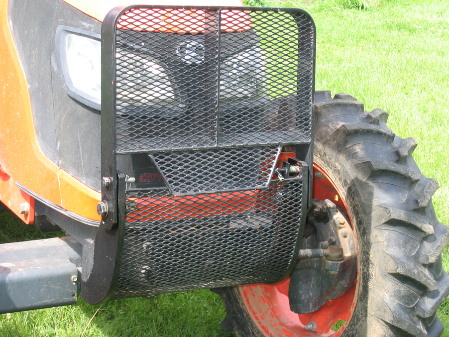

I've had my Land Pride SGC1560 grapple for nine years now. It's an uber HD grapple and has held up well. I can attest to the quality of Land Pride grapples. I use mine to move large rocks and chunks of pine tree trunk. What SmokyDog says/posts about mods to your grill guard is VERY important. Stobs, stick & limbs have a very nasty way of damaging your grill, radiator or battery. This is my grapple and modified grill guard.

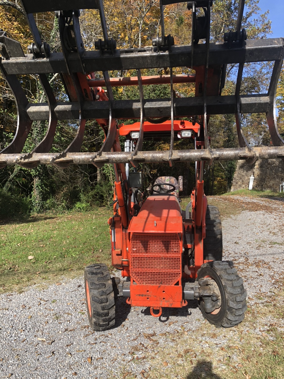

I just got a Titan/Iron Craft 60” for mine. So far it seems to be everything I need. I ran hoses to my rear remotes, so no 3rd function valve.
