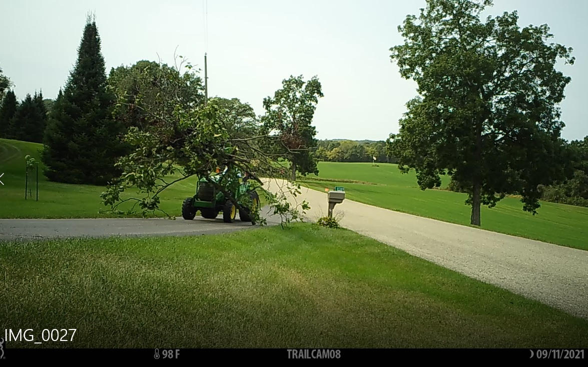

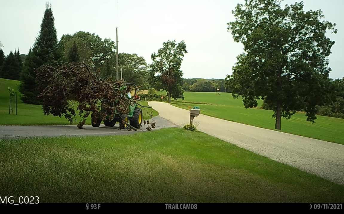

This is a Coke/Pepsi debate...
I have your #2 grapple. It stays on 90% of the time. There isn't anything I have not been able to accomplish efficiently with it, from rooting up invasive buckthorn and multiflora roses to pushing over 10 and 12 inch Maples and pines for field restoration.
And if needed, I can pick up individual sticks with out tearing up the grass
Attributes to consider are:
Weight...(lower the weight of the grapple is more payload you can lift).
Strength of the metal used...(do a quick search of TBN for broken grapple threads, there are some.) I drank the EA "Hardox" kool-aide...with no remorse. I've abused it and it is a beast.
Form Factor...this one is more subtle, but important for me personally.
I bush hog and finish mow fields and woods trails wIth my grapple on. I can curl up the Wicked Root grapple tight to the SSQA, and it barely adds 8 inches beyond the front of the loader, allowing tight maneuvering around trees and corners when mowing, yet it's right there to root out a Buckthorn or Autumn Olive if needed.
I'm not sure the #1 style grapple can be carried as compact to the FEL. It makes a difference in desirability for me.
Likely you will be happy with whatever style you choose, just don't get paralysis trying to make the perfect decision!
Good luck!

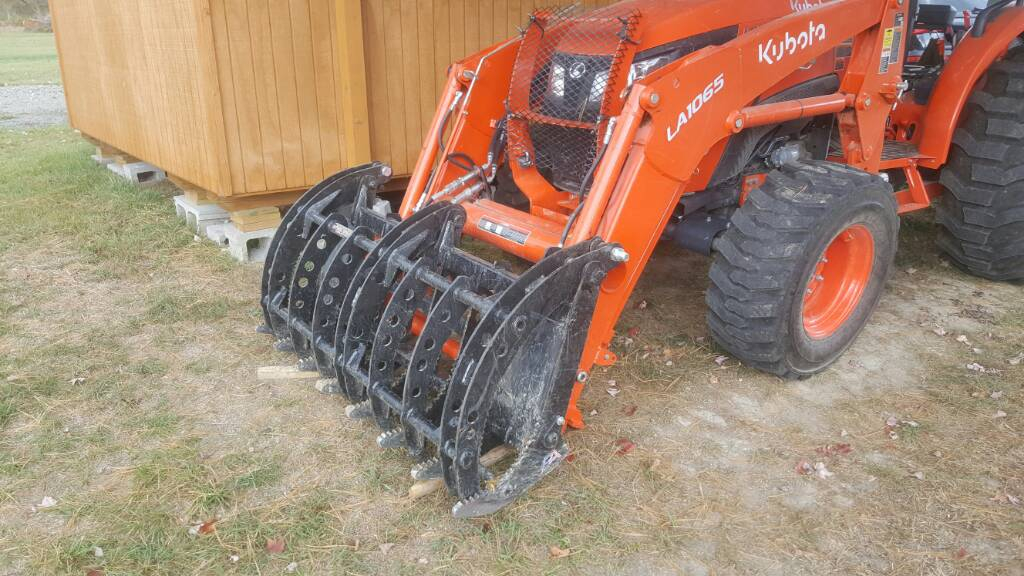

I've had my DK4510 with type 1 since May, have not switched to my bucket yet. Somewhat surprised, since with my old tractor I thought I couldn't live without a bucket. So far I haven't needed it it. The grapple does a lot of things that I used to do with the bucket on my old tractor.
