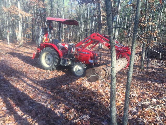

The brush crusher for a smaller tractor like your kioti, will cost much less than that. I paid about 1300 for a smaller set. They can be a pain to hook up, but they handle brush and logs very well. IMG_0906.JPG here is a picture of my set on a 35 hp tractor moving a 20 ft log. The amount of brush you can pick up is impressive and allow for fast cleanup. W Jones
