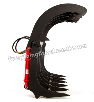

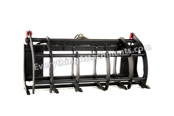

So, I'd be interested in hearing opinions on the vertical tine style vs. the horizontal tine style, like this one: Everything Attachments Compact Utility Root Grapple 50"
One thing that attracted me to the vertical style is that it can be closed down tighter than most of the horizontals, which would be handy for pinching single logs while cutting them with the chainsaw.

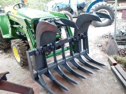

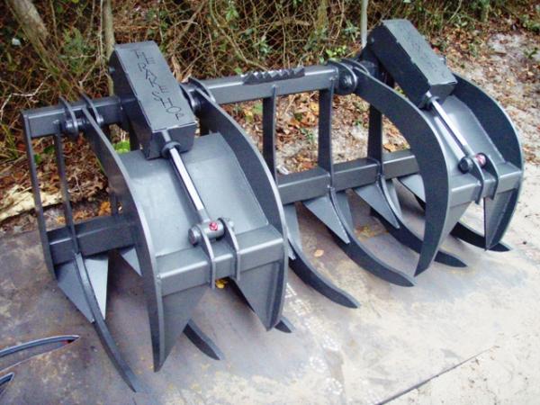

Have you looked at this new vertical style from EA? Everything Attachments Tractor Root Rake Grapple
And the Rake Shop: www.TheRakeShop.com / Root Rakes Grapples Attachments & Skid Steers
LC.Root_Rake_Grapple_Tractor_Attachment.IMG_20120601_083326-405x300.jpg LC.Root_Rake_Grapple_Tractor_Attachment.PB155444-600x450.jpg
