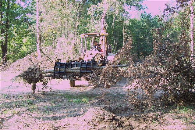

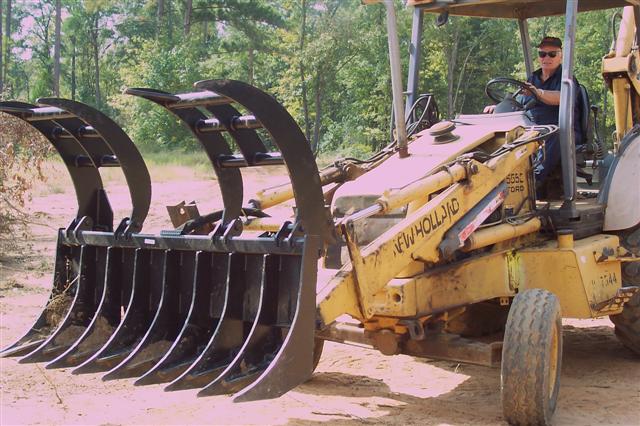

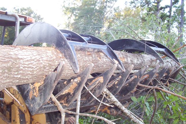

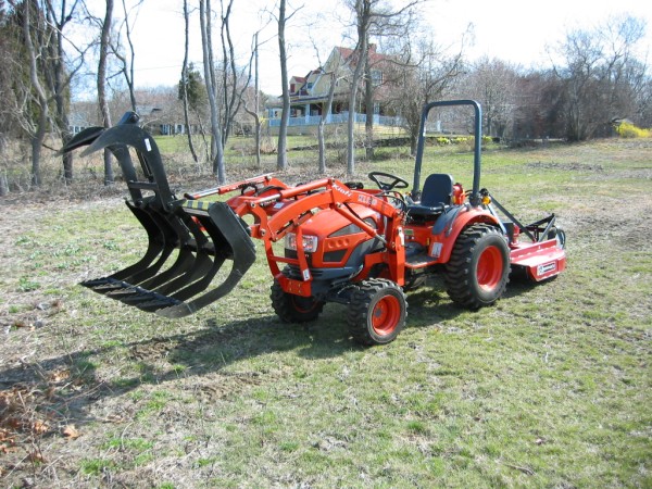

With a clamshell grapple the bottom tines are vertical or close to it and there is no horizontal base for logs to rest on so they can be held in place by gravity. Instead all gripping is "active" and depends on the shape and size of the load.
I'm going to disagree with this statement. I've only used my grapple, so I'm no expert and I can't say one way or another which is better. I can say that with a Rake Grapple, which is what I believe is also being called a "clamshell grapple" that the ability of the grapple to tilt back allows the weight of the load to rest on the grapple. You do not have to carry the log, or whatever you are carrying, in the virticle posting. Just tile the grapple back like you would a load of dirt in your bucket. All the weight is then on the rake grapple, and the grapple itself is just holding it in place.
On mine, I chose the Rake style because I didn't want to have to slide the grapple under what I was picking up. I wanted the ability to just open the grapple and pick up what what there without any pushing or sliding. It doesn't actually work that way because I do a small amout of pushing to add more branches to the load that I'm picking up. If I want to pick up one or just a few things, I can do it that way, but in a big clean up, I'm out to get as much as possible.
On my grapple, I have two arms that lower on either side. They are on the same hydraulic line and when the first one hits something, it stops moving and the second one keeps going. When they both come into contact with the load, they tighten up. This way, I can carry verry uneven loads that do not come loose.
Here are a few pictures of my setup.

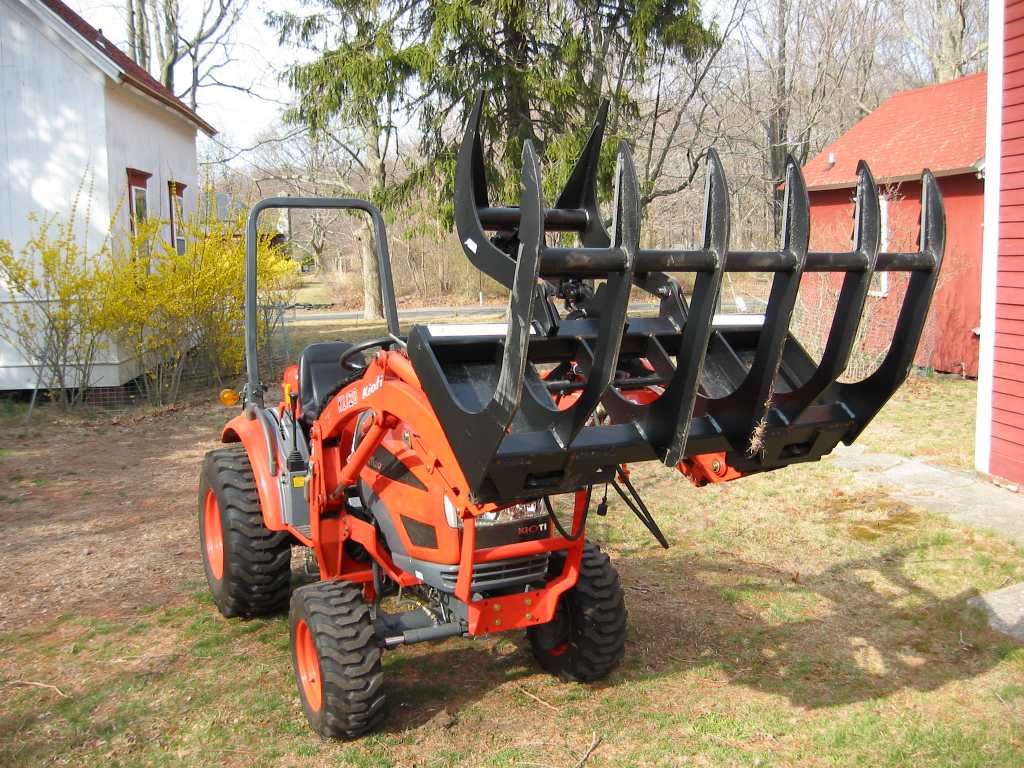

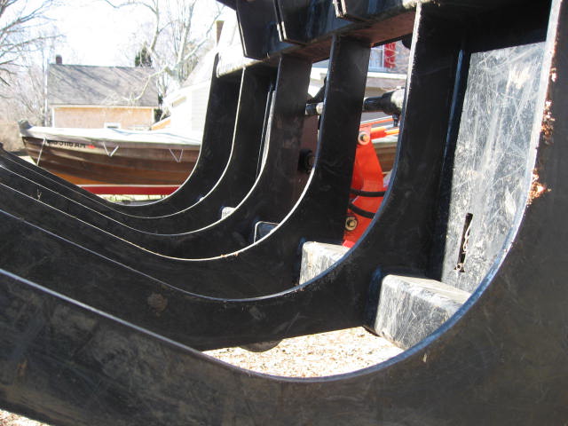

   / Grappling for answers on Grapples #55
Island, do you think the Markham would be as capable as the Millonzi in root raking or are the Markham tins flat configuration a disadvantage for this purpose?
I guess if I had a Markham I would do more picking up and carrying than pushing and raking with a WR Long, but I need to remove stumps and roots.
I had my land logged and now clearing the steep slopes to open the mountain view. I have logs and treetops scattered about. I have been pushing into piles with the loader and burning, but this is a slow process and I can only push down or up due to the steepness.
I have never used a truly flat bottomed grapple but most open bottom grapples are made that way (just like the Markham). My Millonzi has a slight curve to the bottom and I find it useful to get leverage on roots etc. I suspect that any difference in function is pretty small though and I wouldn't hesitate to get a Markham 48 to replace mine if it walked off some day.
I don't know why builders choose the flat bottom other than that they can just start off with flat stock rather than CAD cutting a curved bottom. Maybe that is cost savings enough to justify the flat bottom. For some uses like picking up construction debris the flat bottom is probably preferred. I wonder if Markham has the CAD equipment to do a "rocker" bottom grapple though. They do build them one at a time so it is essentially a semi custom shop anyway.

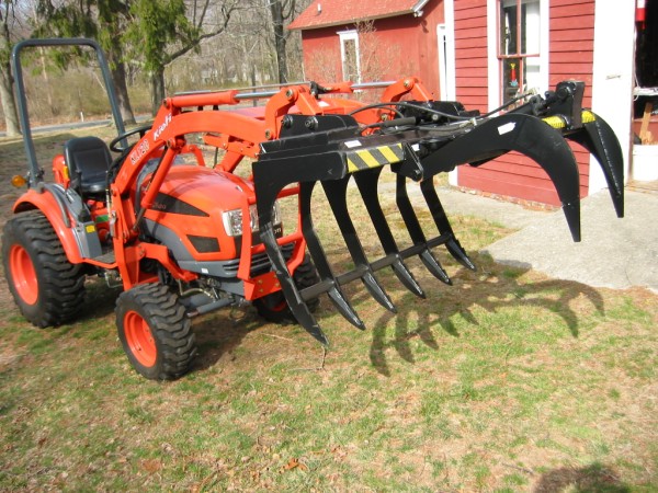

I'm going to disagree with this statement. I've only used my grapple, so I'm no expert and I can't say one way or another which is better. I can say that with a Rake Grapple, which is what I believe is also being called a "clamshell grapple" that the ability of the grapple to tilt back allows the weight of the load to rest on the grapple. You do not have to carry the log, or whatever you are carrying, in the virticle posting. Just tile the grapple back like you would a load of dirt in your bucket. All the weight is then on the rake grapple, and the grapple itself is just holding it in place.......Eddie
Yep, I see what you are talking about on your first photo. Here are the equivalent grapple positions achieveable with a open bottom grapple. There does seem to be a lot more room for a load that is held in place by gravity alone with the open bottom style but as your photo clearly shows you can also do that with the clamshell.
