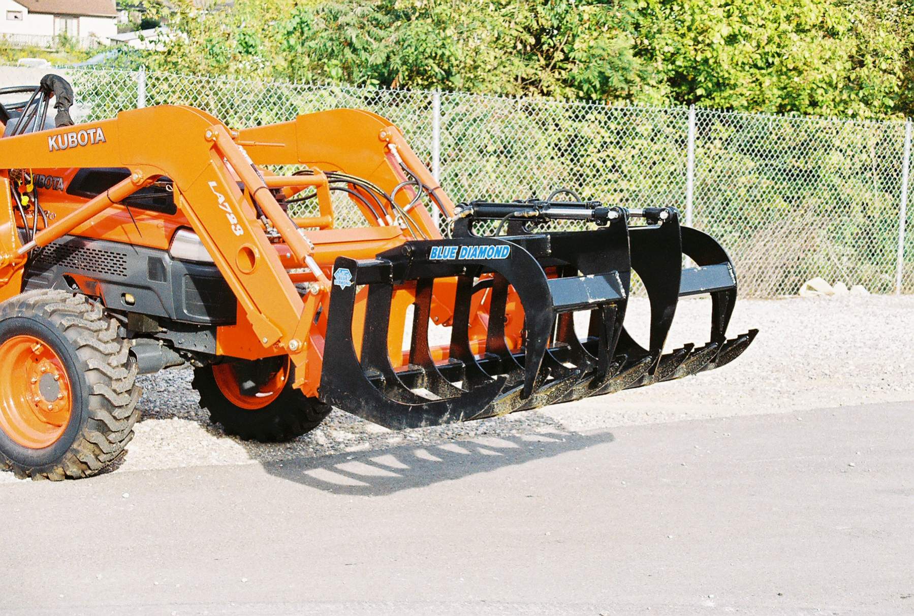

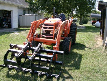

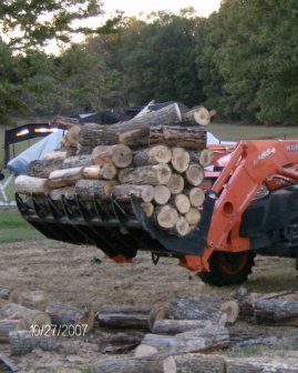

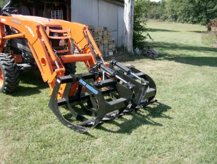

Not sure if you have purchase your grapple yet. I have a L5240 with the same loader and QA you have. I purchase a Blue Diamond grapple made here in the Knoxville area. Photo attached. I have used it quite a lot over the last year or so to move logs and brush, etc. I have been very pleased with the quality and durability.

That is a nice looking grapple. What width and weight is that? It reminds me of the design Island talks about with the rocker shaped lower teeth. I have committed to a grapple from Markham Welding. I decided to go with one that was 60" about 450 lbs and a single 30" top tine. The Markham in 60 or 48" single tine is $900 plus shipping. I plan to pick mine up since they are about an hour away. I went back and forth on whether to get two top tines. They would be about 15" or 16" wide and set about 20" apart. On the Markham that would add about a 100lbs and $350. It is interesting the way the cyclinders are mounted on the ends of the tines. Does that grapple sell for roughly $1000, $1500 or $2000 if you don't mind sharing.
As Samandothers noted, the bottom of your grapple is a dead ringer for the Millonzi.
The two upper jaws are unusual in that the hydraulic cylinder is offset medially and not centered on the jaw. For brush I don't think that would be an issue but I would be a little concerned about twisting the upper jaw if I were, for example, clamping down on an asymmetric item like a boulder where the outside of the grapple arm edge stopped closing on a high spot and the hydraulic powered inside edge continued to close. That might twist the mount. Have you noticed anything like that happening?

Island,
I have used it for quite a few different applications including lifting odd-shaped items. I haven't noticed any problems at this point. It seems very well-built.
Samandothers,

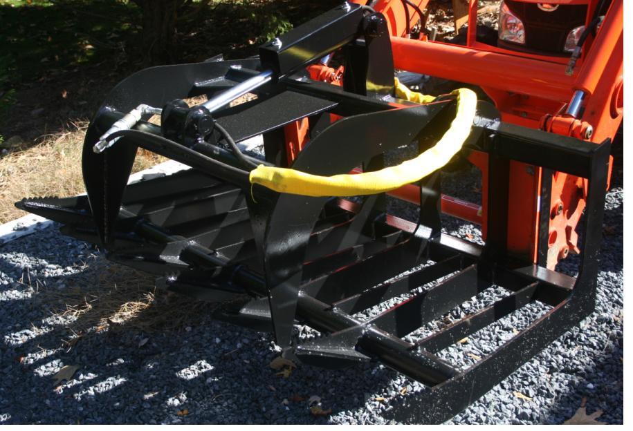

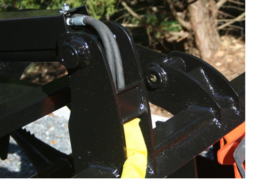

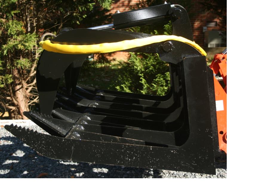

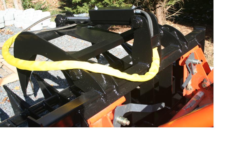

The grapple is a 66" model. It weighs a little over 500 lbs, but I don't recall the exact weight and was unable to locate my spec sheet to confirm for you. The grapple was around $1,500 when I purchased it. I am attaching another photo that the manufacturer had provided me with. It is a little closer view.

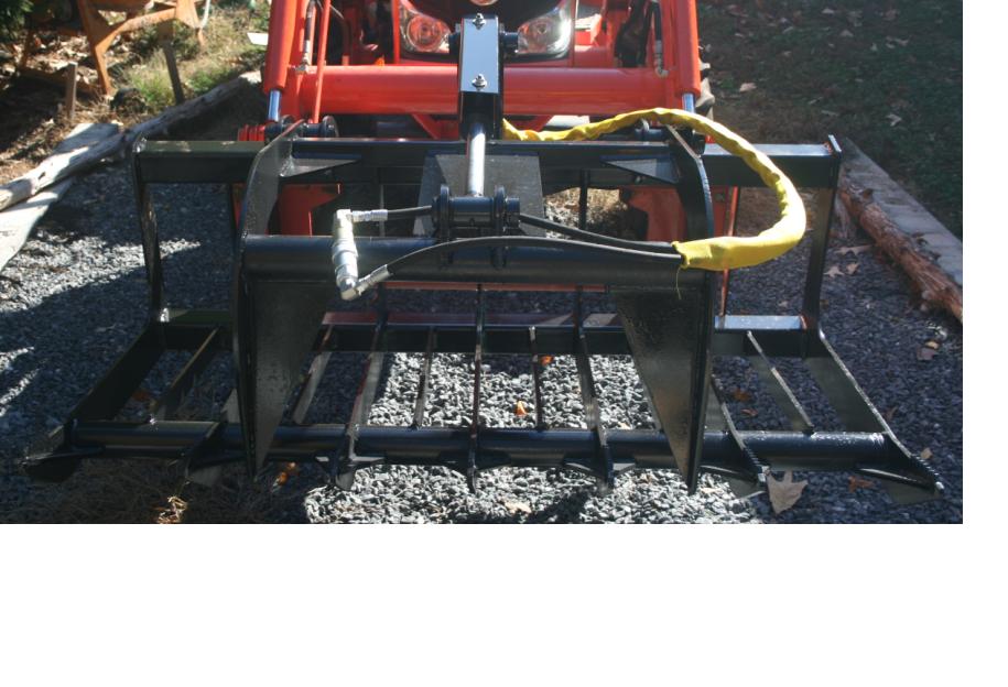

I picked up my Markham grapple yesterday. I attached it to the tractor and removed the pallet. Backed up far enough to take a few pictures. I still need to have the 3rd function valve installed. I hope to get that done this week. I had to opportunity to meet Allan Markham when I picked up the grapple. I enjoyed conversation with him and looked at few pieces of his skid steer attachments. They were very nice. There was on device that looked like it would be handy, what he called a stump grapple. It was made like a stump bucket but had a top tine attached. You can dig out the stump/tree and grab it with the grapple. It was 1/2 steel like his heavier grapples and more designed for skid steer use.
Here are a few pictures of the 60" grapple with 30" top tine. I had him add spacers in the bottom to narrow the gap between the teeth from 9 " to 4.5". This grapple is 3/8" steel and weighs some where around 480 to 500 lbs. While it is heavier than my square back bucket with tooth bar I don't think it will 'rob' too much of my loader capacity. I look forward to getting the hydraulics installed so I can play with it.

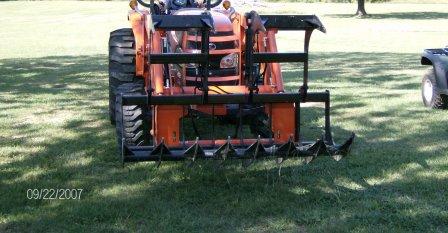

#70

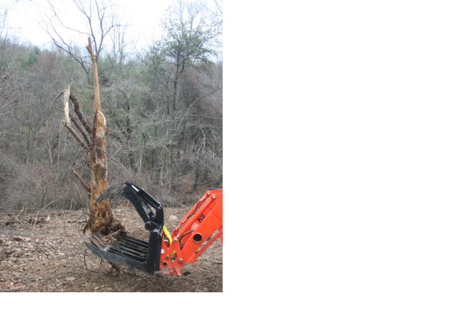

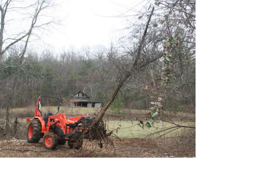

Got the WR Long valve installed and had a chance to play with the grapple over Thanksgiving. Man this is a great tool for clearing brush. Anybody that has land to clear should have one of these. Some of the trees with shallow roots I was able to pop out of the ground. Some of the larger ones I dug out with the backhoe and then carried off with the grapple.
I also moved some rock with it. The rock took a bit of practice to pick up. The top tine is 30" wide and with smaller rock I had to position to get one tine on the rock or roll it over into the grapple. I like having the open bottom design (like a fork lift vs clam shell). For what I am doing carrying brush and rock it works great. I could see where if I was ripping roots this would not be the best design as it would put a lot pressure on the loader.
I appreciate the input from you folk. The input helped with the decision and the design selected. The Markham grapple is doing a great job. I would recommend it to those with compact tractors.
