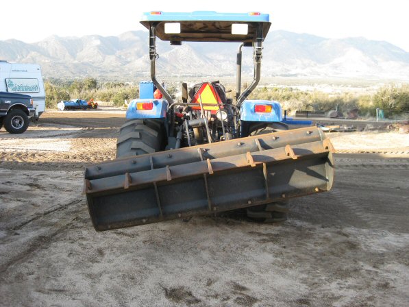

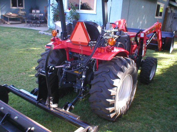

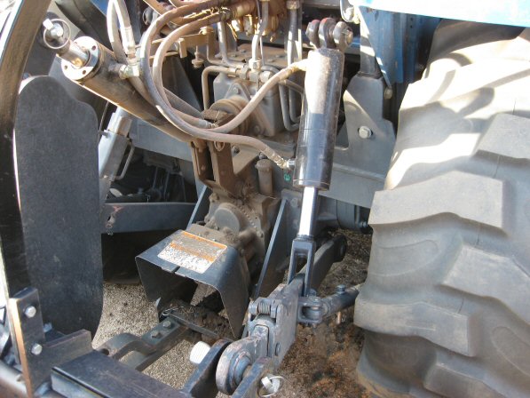

$623 + shipping costs of $75-$100???. :confused3: I would build the links using 3" dia cylinders with 1 1/2" dia rods. Top link would have a working length or 21"-31". Side link is built to be able to get you an equal amount of tilt to both sides. 2 hose kits made with 3/8" hose, with 1/2" male AG quick connect ends. 2 flow restrictors, these allow for slower smoother adjustments of the hydraulic links. Current lead times are putting ship dates into the first part of January.
A few pictures. The maximum tilt is usually between 9 and 13 degrees to each side, depending on the tractor.
Let me know if you are interested. ;)
