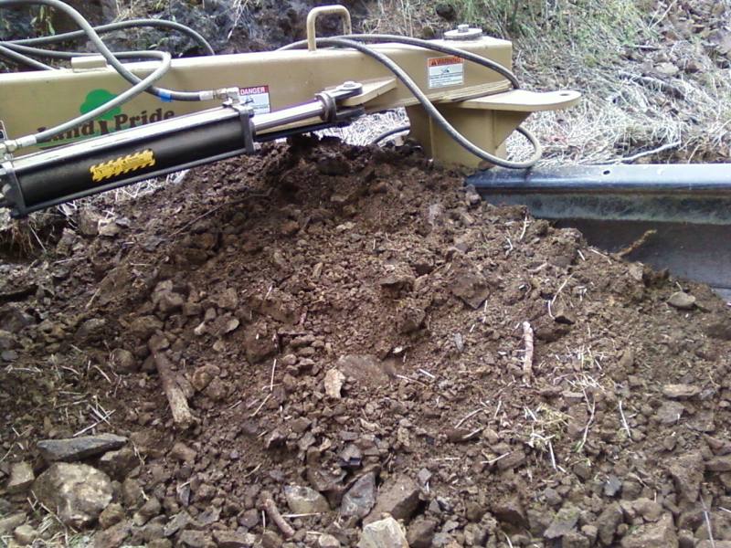

I got my RBT 4596 with full 3 way hydraulics used for less than a new RBT 3584 without hydraulics at all. Look for a used one. The suggestion of going manual now with option to change to hydraulics later is valid as well. As far as only having two remotes in back Landpride makes a solution that I can't think of of the proper name right now but it is basically a diverter kit that allows you to split one remote into two sources. Kind of a hydraulic splitter valve. It is not to bad on cost and allows you to use a three hydraulic system with two rear remotes. You can also do it by yourself using stuff you build from off the shelf.
From a Landpride manual
Hydraulic Selector Valve
Kit Bundle
301-188A . . . . . . . . . HYDRAULIC SELECTOR VALVE
Allows operation of 3 cylinders using 2 duplex outlets.

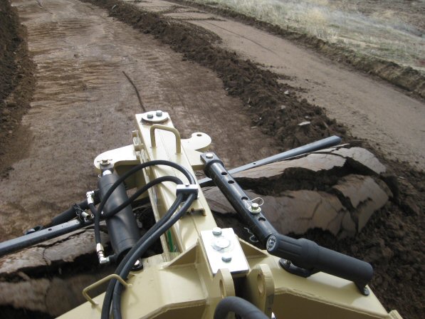

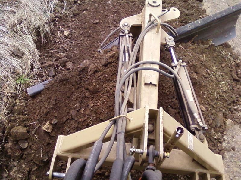

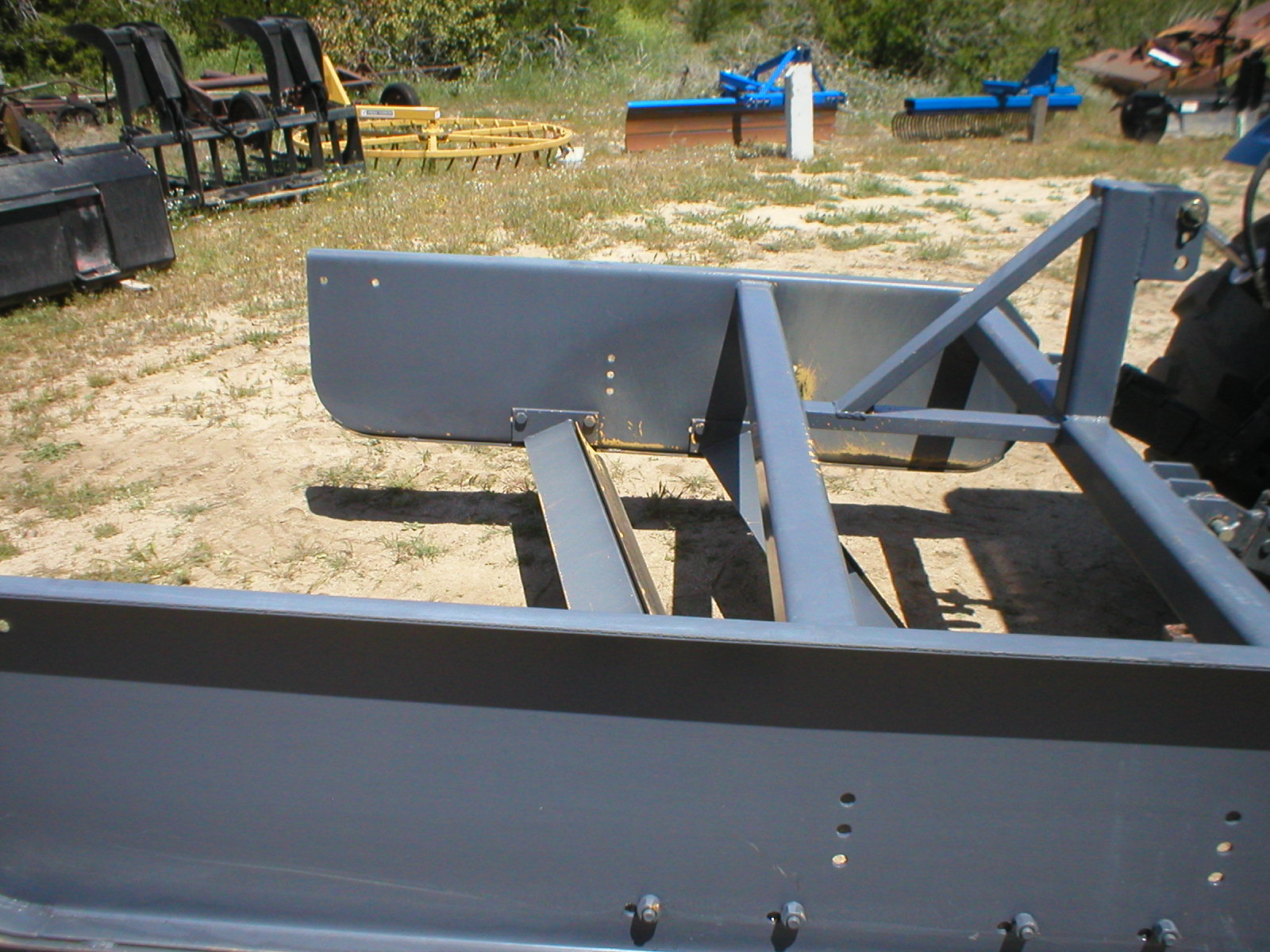

$623 + shipping costs of $75-$100???. :confused3: I would build the links using 3" dia cylinders with 1 1/2" dia rods. Top link would have a working length or 21"-31". Side link is built to be able to get you an equal amount of tilt to both sides. 2 hose kits made with 3/8" hose, with 1/2" male AG quick connect ends. 2 flow restrictors, these allow for slower smoother adjustments of the hydraulic links. Current lead times are putting ship dates into the first part of January.
A few pictures. The maximum tilt is usually between 9 and 13 degrees to each side, depending on the tractor.
Let me know if you are interested. ;)

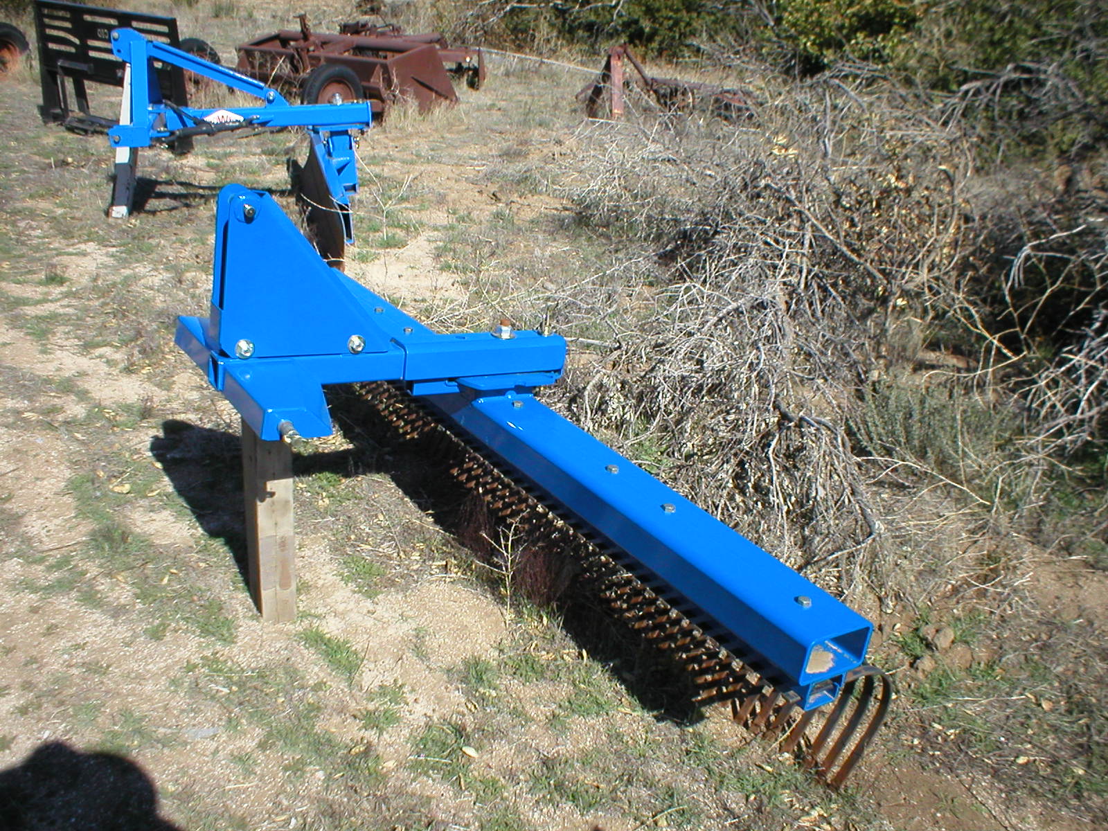

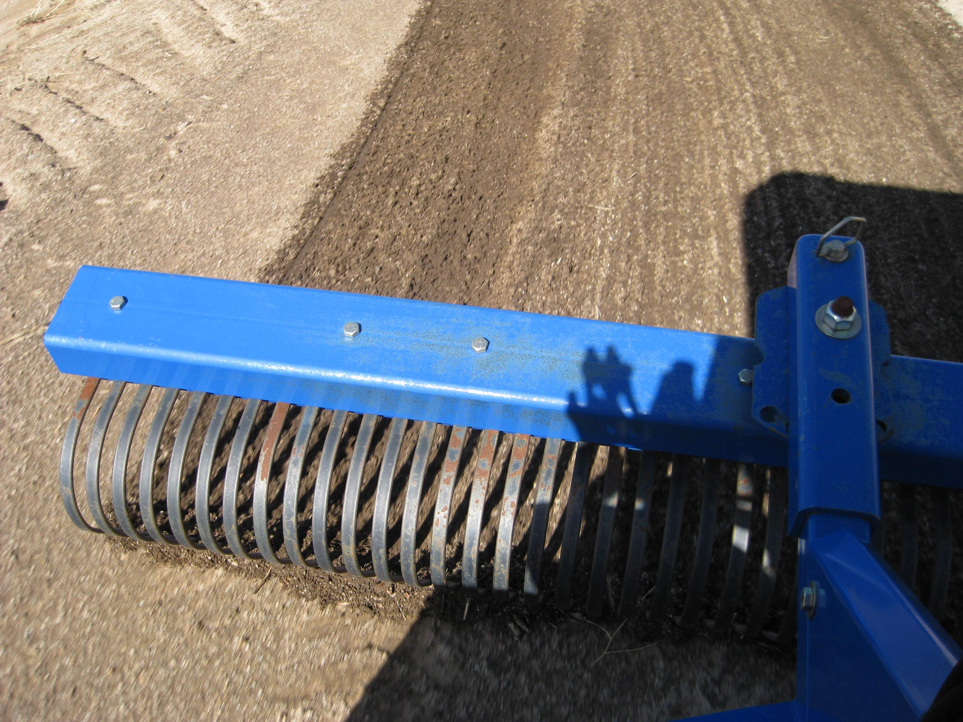

If you have a lot of ditch work to do you are probably on the right track with the rear blade you are looking at. If I going to do over and get one attachment to do multiple jobs in place of blade, box scraper, and rake I would look into getting a TR3 rake. It's pricey but looks like a good replacement for at least 3 attachments. It looks like it would be a great tool for road work.
TR3 Rake - 3pt Tractor Rake - YouTube
   / Gravel and Dirt Work - Which implement? #34
The TR3 is for smaller tractors. I don't think that it would last to long behind his JD. ;)

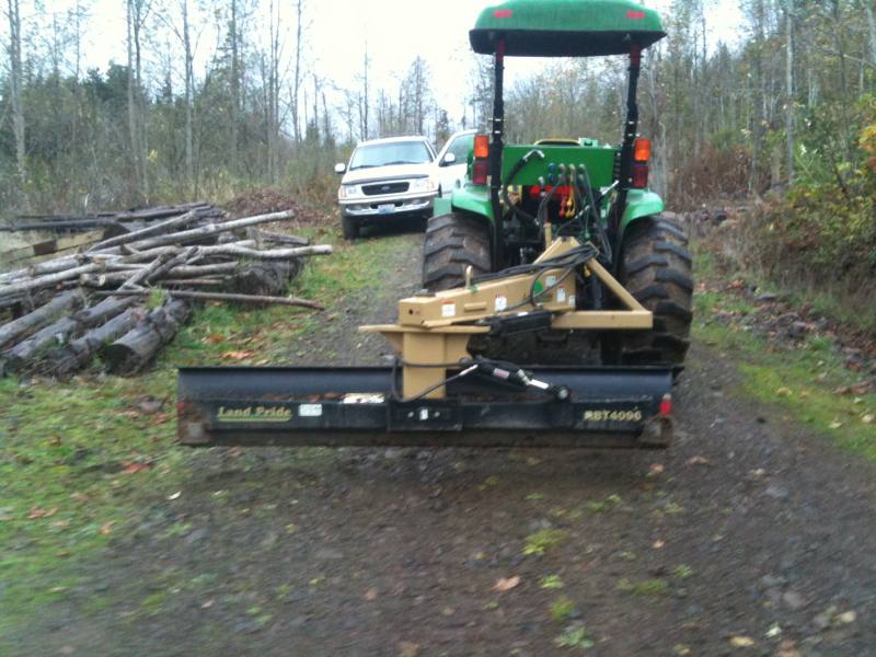

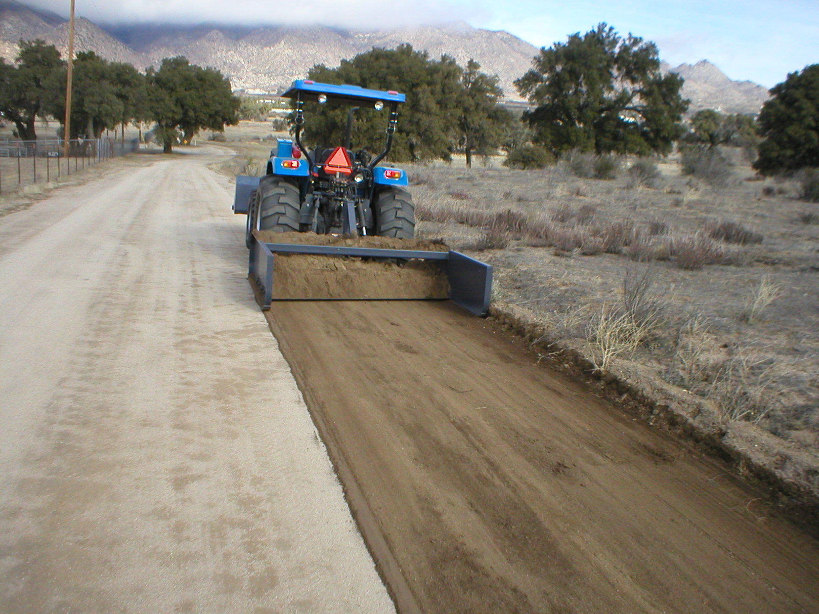

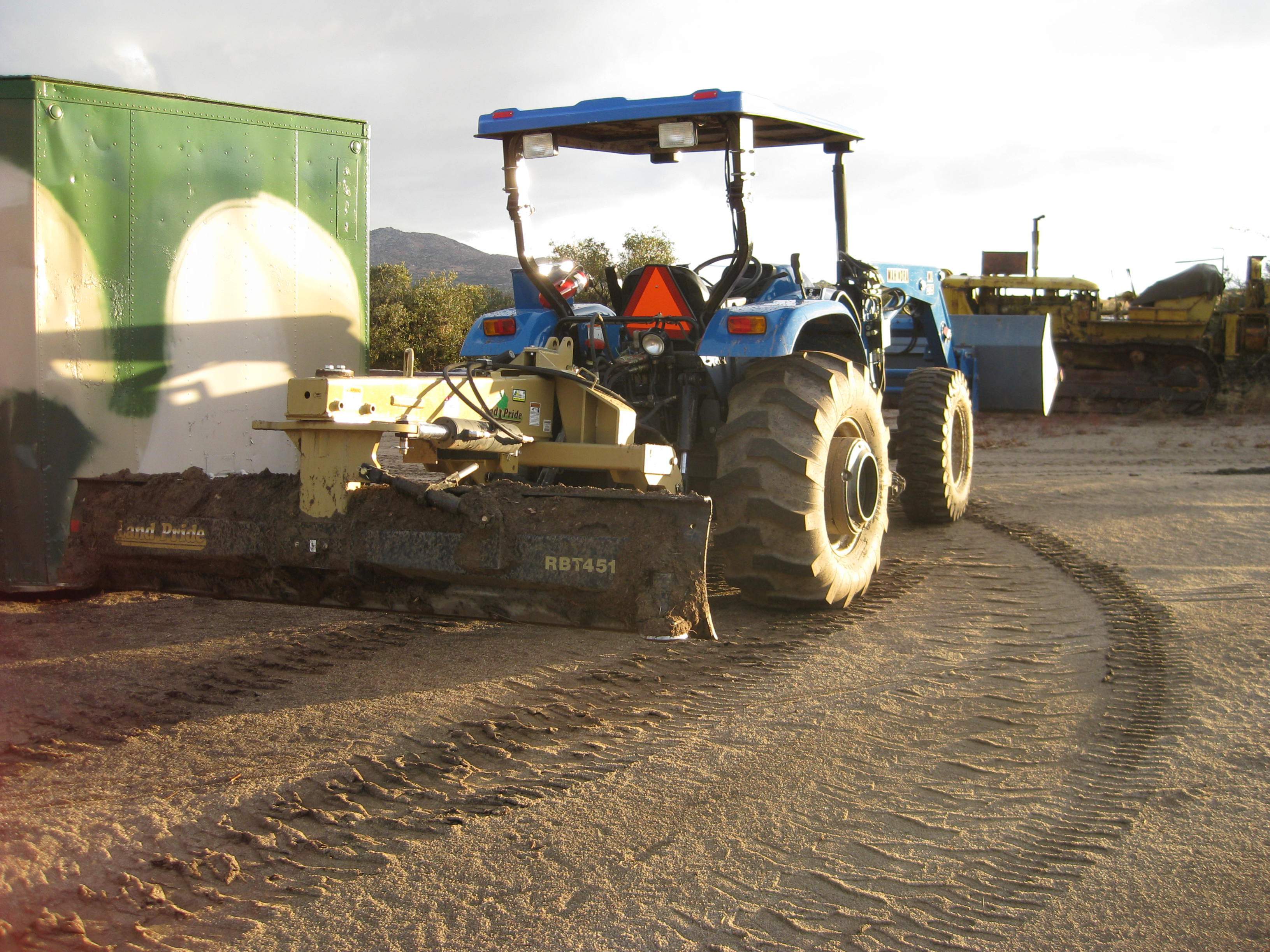

pclausen said:

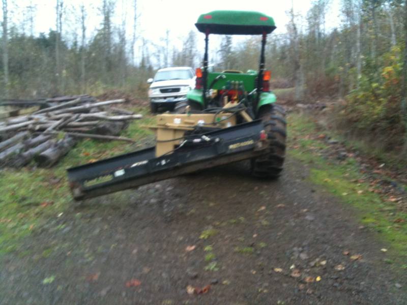

While it's true that a 96" heavy duty all hydraulic blade lists for around $5k, you can pick one up for craigslist if you keep looking. I picked up this one for $1200.
After a little work, it looked like this:
Heck, I'll give you $1300 for it...
Man, you stole it.

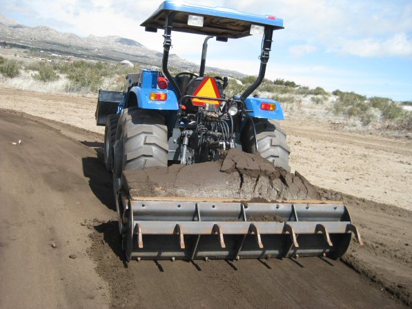

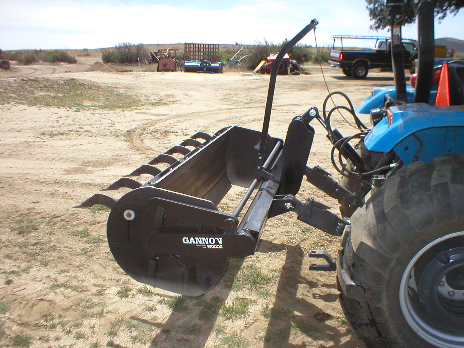

Well it would be pretty difficult to argue that the RO box blades are better, seeing as they have all but been replaced by any and all professionals. If the RO boxes were the best thing going, all the pros would have them and the major implement manufacturers would not have discontinued them. They were not discontinued because they cost more than the current industrial models. So I have to say that the industrial boxes with the floating rear blade and the hydraulic scarifiers are better than the roll overs. ;)
Now with that said, I prefer my Gannon roll over vs ANY std type of box blade. Imangine using a RO vs a std BB with no hydraulic top link or side link or scarifiers. RO easiely wins out in that senario in my eyes. But that may just be me. Different people like different things, I like to be able to rip down 10". You won't be doing that with a std BB. I like to be able to push a cubic yard of dirt in reverse. You will not do that with ANY std BB, industrial or not. A person that has not ever used a RO box blade probably doesn't realize that it takes only a few seconds to roll the box to where you want it. It's not like you have to stop the tractor and get off and set the teeth to the height that you may need or adjust the top link so that you can smooth out the surface that you are working on. They were state of the art in their day and really have only been replaced as top dog by the industrial box blades of today. ;)
Just my :2cents: based on MY experience, others views will vary.:D
