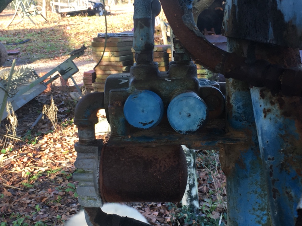

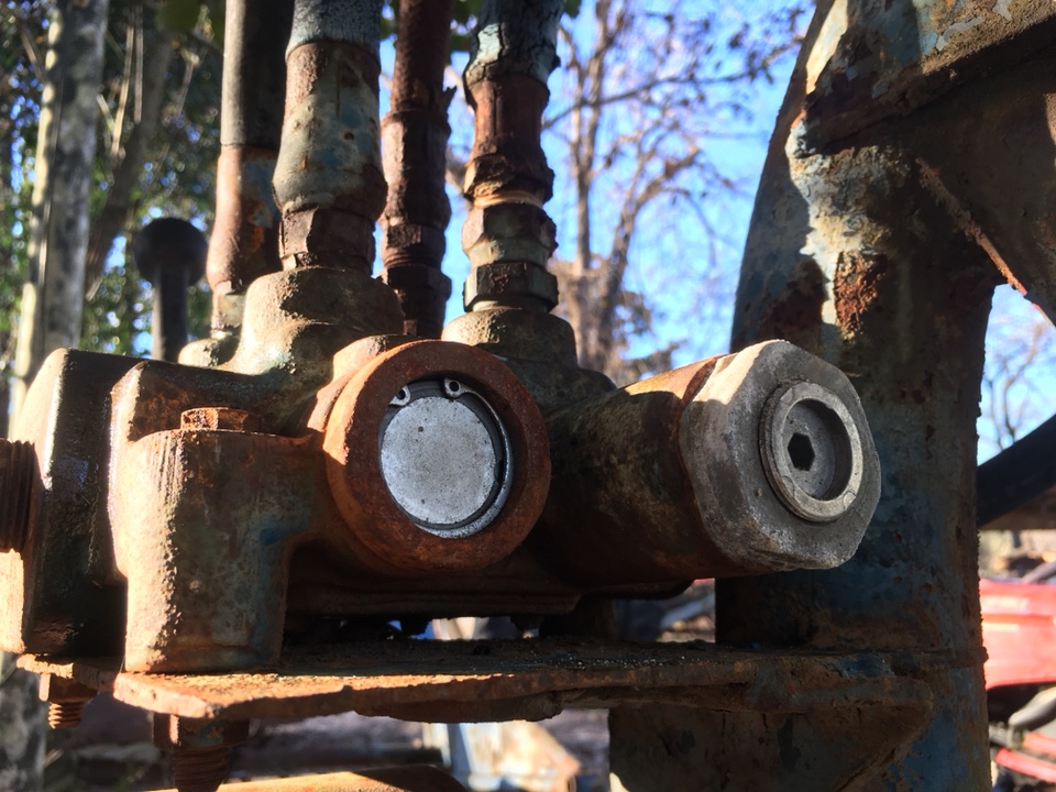

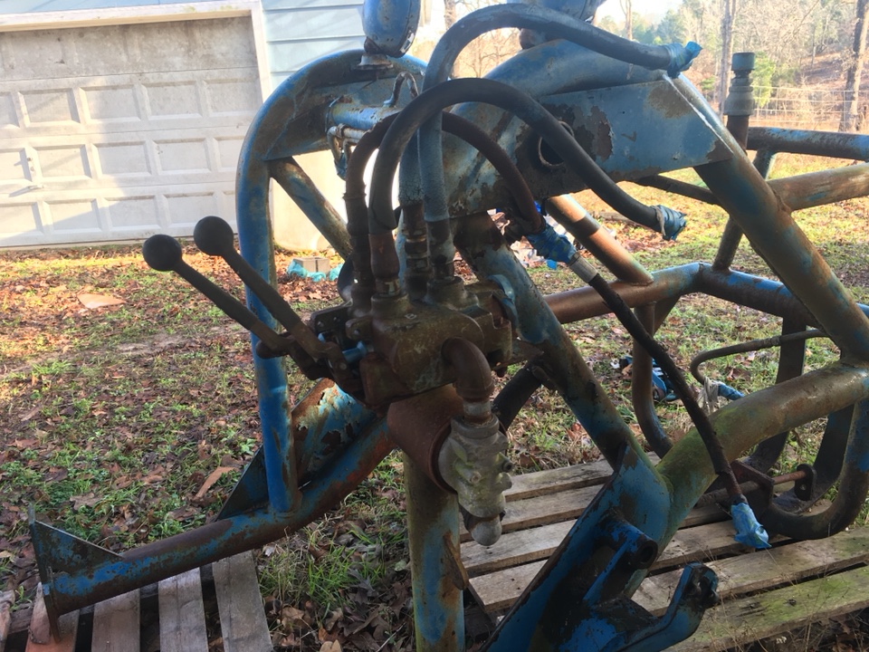

Just trying to find a little information on this hydraulic block. Know very little about hydraulic valves mainly just about cylinders. This was my grandfathers tractor and I’m about to bring it back to life and want to know more about the hydraulic system. It’s a Gresen 2712 M open system due to the gear driven hydraulic pump? Anyway, was curious if it has power beyond and information about adding another valve for a grapple. Thanks for the help. Keep it in English until I’m a hydraulic genius like some of y’all. IMG_1869.jpgIMG_1864.jpgIMG_1865.jpg
/ Gresen 2712 M #2
Is there another port beside the one with the filter? I can't tell from the pictures.
/ Gresen 2712 M #4
I understand. What I was wondering is if there is a port behind the out that might just be plugged. I can't tell from the picture.
If it had a power beyond port it would be in this area and could be stamped with a "y".
None the less, you would have to source a conversion plug and that might be difficult.
I believe Parker bought out Gresen some years back. They might be able to help you find the PB plug if you have the port.
You could use a diverter valve to add third function if you can't add PB.

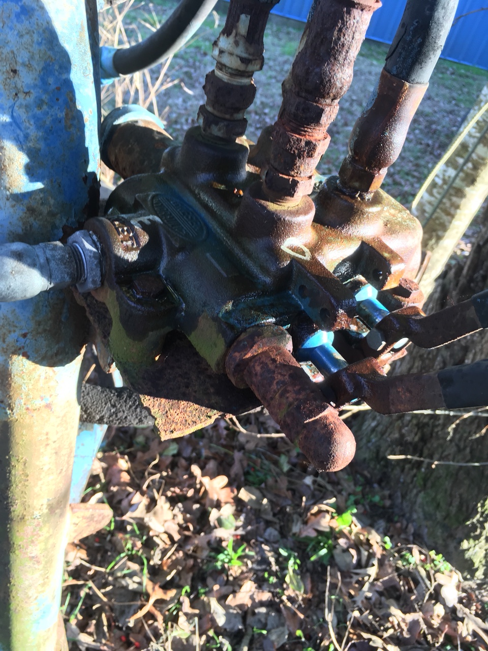

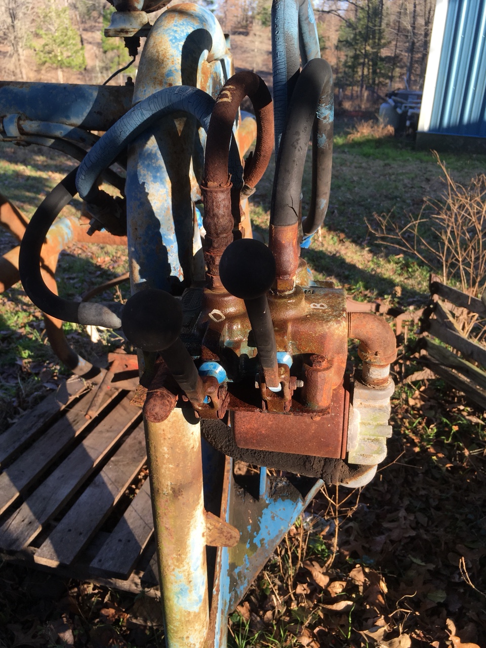

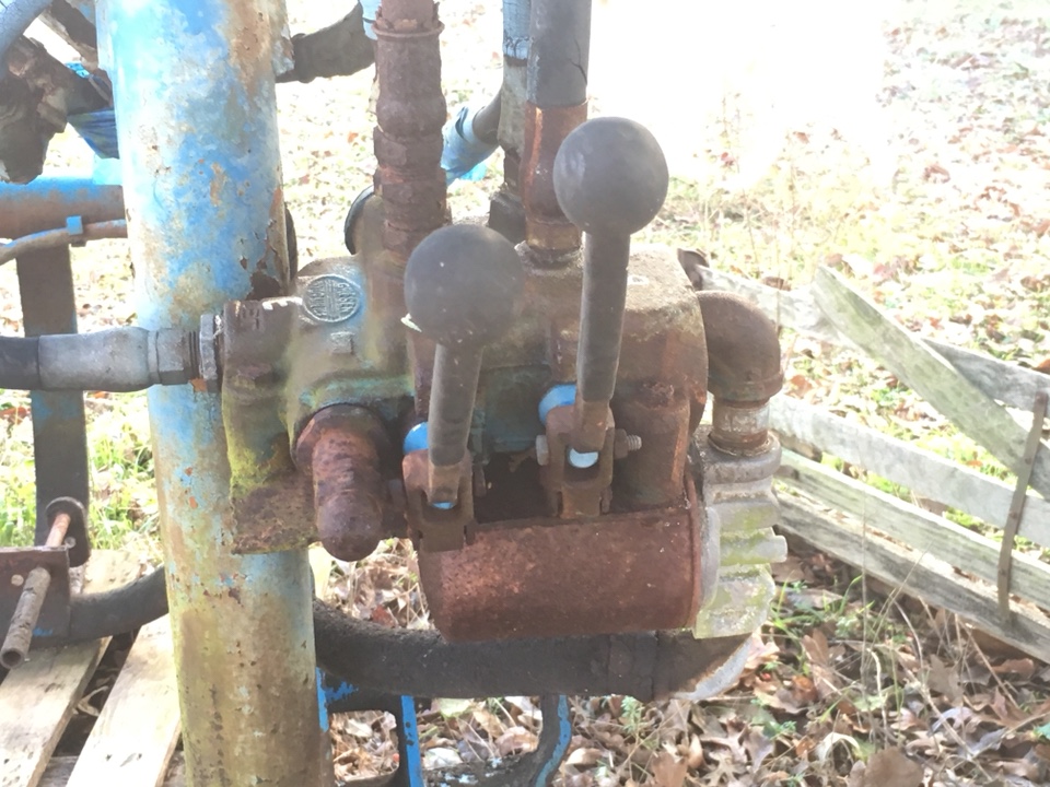

Here’s a few better photos I took this morning. Seems to be only one outlet. IMG_1897.jpgIMG_1898.jpgIMG_1901.jpg
/ Gresen 2712 M #6
The only options left then is a new valve with PB or a electric diverter valve. :thumbsup:
