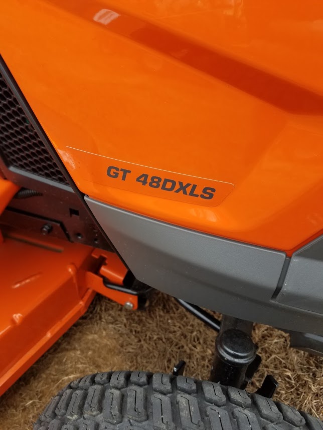

My mother is in need of a new mower, so I've been researching some options in her price range (<$3k). She's rough on equipment and the terrain is pretty hilly around here, so I feel she needs a mower with something >K46. She doesn't need a 48" mowing deck, but that's the price of admission.
I think we've narrowed it down to the two models in the title. It seems that the GT is a mythical creature on these forums, and there's a dealer nearby with a leftover unit still on the lot.

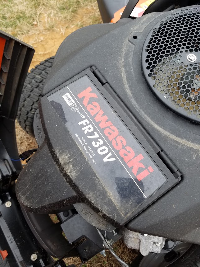

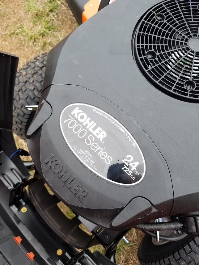

The TS seems like a very similar machine with a couple of differences. Tires (classic Harry-homeowner style vs "professional" turf tires), engine (Kohler 7000 vs Kawasaki FR), and some styling differences. Both models have the fabricated 48" deck, ~24hp, and K66 with electronic locker.
The TS is a new model and so the ones on the lots are brand new. It's spring time, and local dealers are holding deals close to the vest for now. Best offer is for $2899+tax ($100 off).

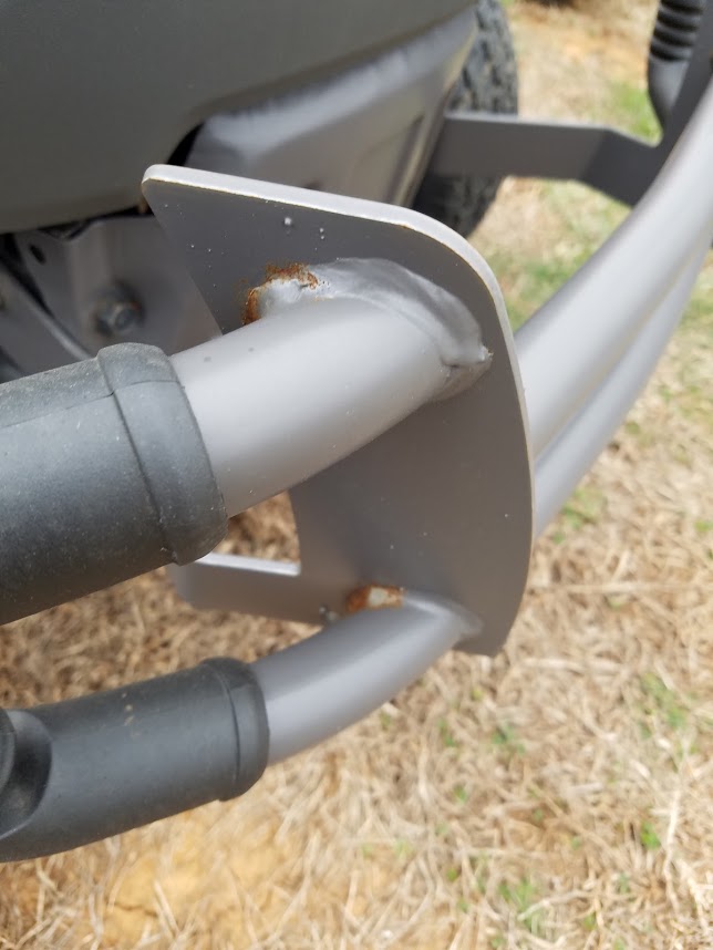

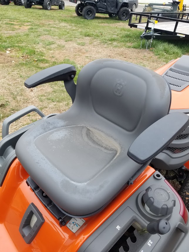

The GT has been on the lot for nearly a year. It shows. Sun damage to the seat, dusty/dirty, and some surface rust starting to show here and there. The dealer isn't budging on price. $2999+tax.
If it weren't for all the accolades heaped onto the GT, it would be a no brainer...so I'm strongly leaning TS (cheaper, "newer", and similarly equipped).
Change my mind.

I don't see a TS 348D either, but that doesn't mean it doesn't exist. It could easily be a limited, regional, or new model that hasn't made it to the website. I like the seat, but question the locking differential - if it's an auto-locking differential, I'd avoid it. If it has a rocker switch on the dash (like the GT48DXLS), and it's a K66, the Kohler would be fine - even though the Kawasaki is smoother and easier to maintain than the Kohler Commands I've owned, both of which were excellent, trouble-free motors.

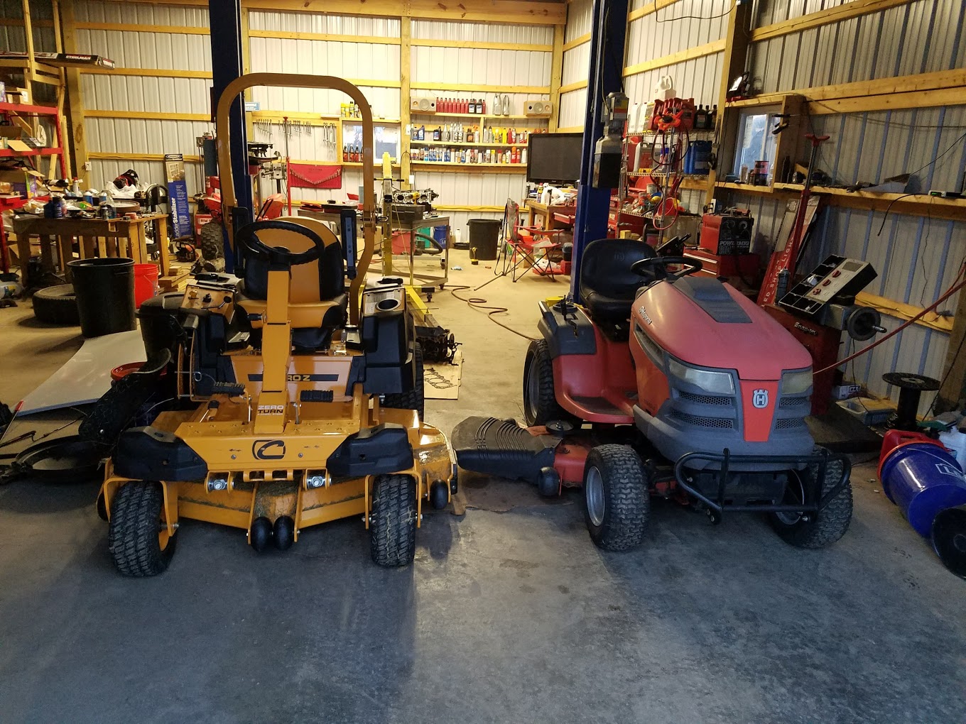

Up until last spring, I had a 2754GLS that I bought new in 2008. It had a K66 (no locker) - filled the tires with fluid to increase traction. I changed the fluid in the K66 once and had no issues in 500 hours. I'm sure the K66 is still going strong.
It was a fine mower, but I did have to replace the sump gasket twice.
I replaced it with a Cub Cadet ProZ 154S last year. Same deck size, but I now cut my grass in half the time.

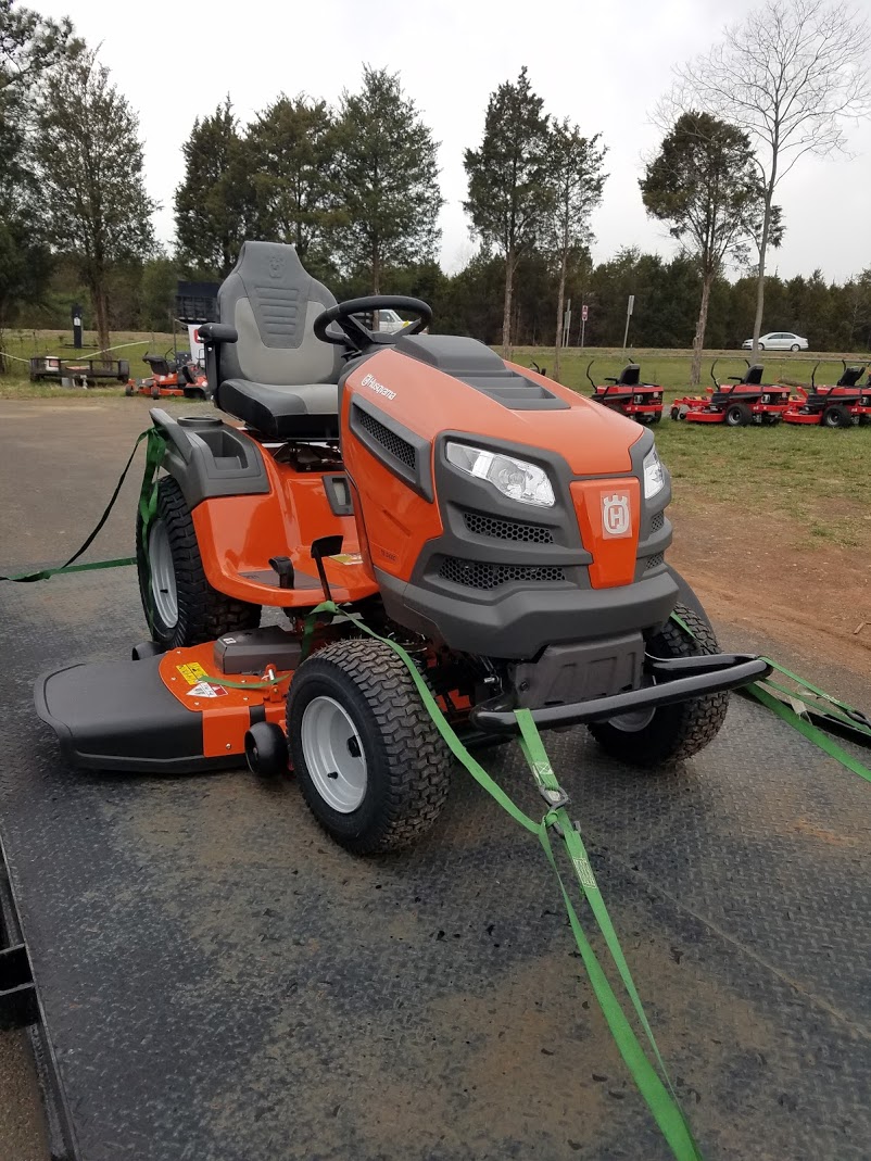

Picked it up this morning. I'll get it home this afternoon and post up some more pictures, for those interested.

Looks sweet! One thing I notice is that they have the tires way over aired, those fronts look like balloon tires! Better check all 4.
Also make sure that the deck is level left/right and the rear should be sloped upwards compared to the front. Your cutting is done at the front, and supposedly you get a better cut and more mowing power by having the rear up a bit. You'll have to see how adjustable the mounting system is....

Yep, the tires are way overfilled for normal use. They do it for shipping, supposedly.
