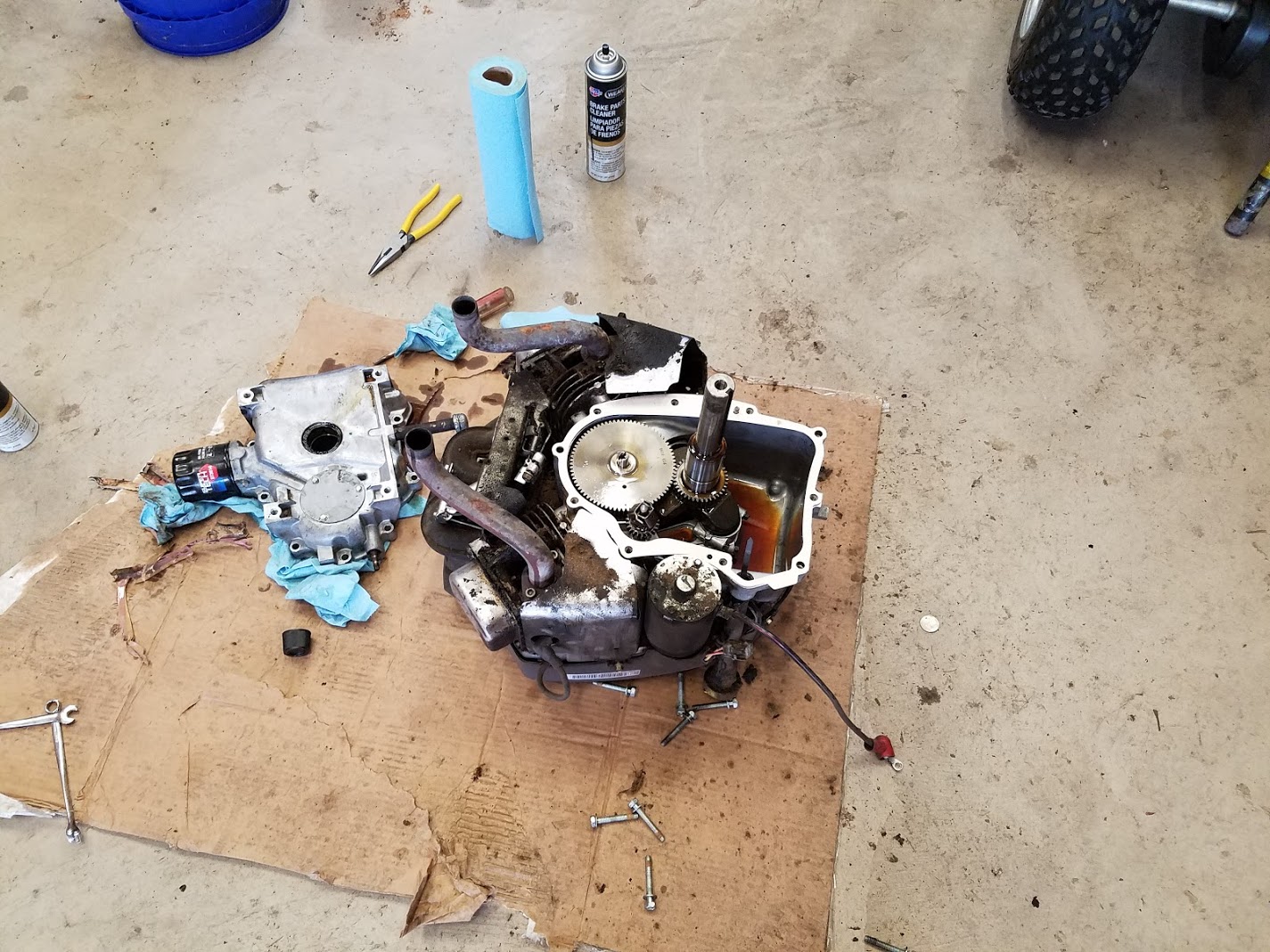

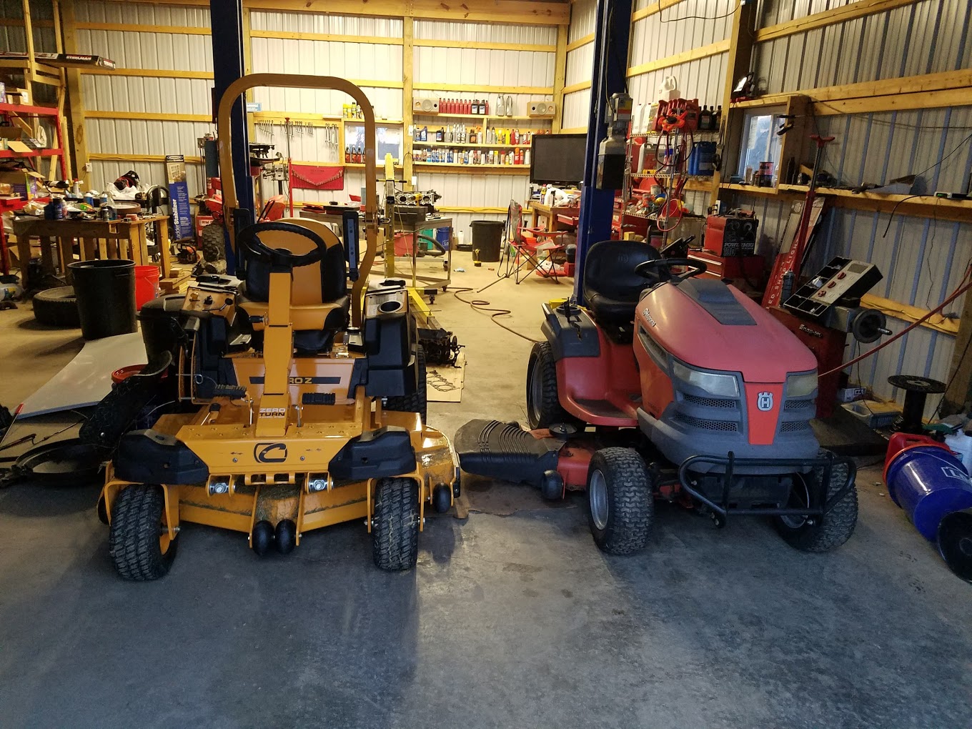

Up until last spring, I had a 2754GLS that I bought new in 2008. It had a K66 (no locker) - filled the tires with fluid to increase traction. I changed the fluid in the K66 once and had no issues in 500 hours. I'm sure the K66 is still going strong.
It was a fine mower, but I did have to replace the sump gasket twice.
I replaced it with a Cub Cadet ProZ 154S last year. Same deck size, but I now cut my grass in half the time.

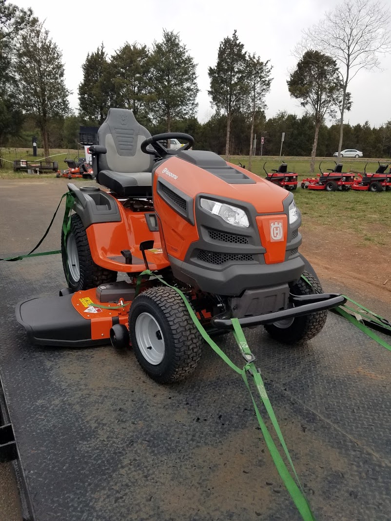

Picked it up this morning. I'll get it home this afternoon and post up some more pictures, for those interested.

Looks sweet! One thing I notice is that they have the tires way over aired, those fronts look like balloon tires! Better check all 4.
Also make sure that the deck is level left/right and the rear should be sloped upwards compared to the front. Your cutting is done at the front, and supposedly you get a better cut and more mowing power by having the rear up a bit. You'll have to see how adjustable the mounting system is....

Yep, the tires are way overfilled for normal use. They do it for shipping, supposedly.
So thoughtful of you, Peter. :)
Hopefully it's the last mower my mother ever has to buy. She is not well off by any definition (we were actually pretty poor when I was growing up), so this is a *big* purchase for her.
