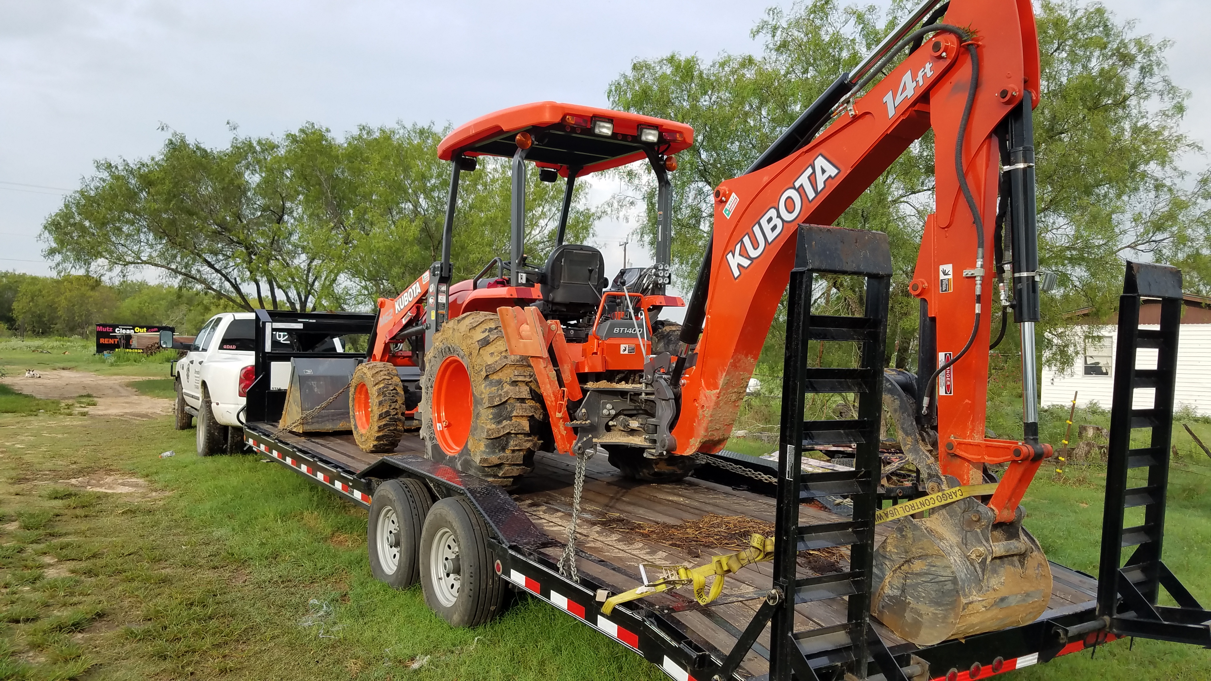

Is everyone following this? Keeping 2 sets to rear tires :)
My 13 year old L39 is laughing really hard.

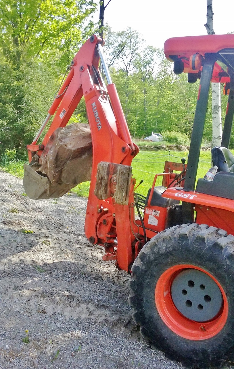

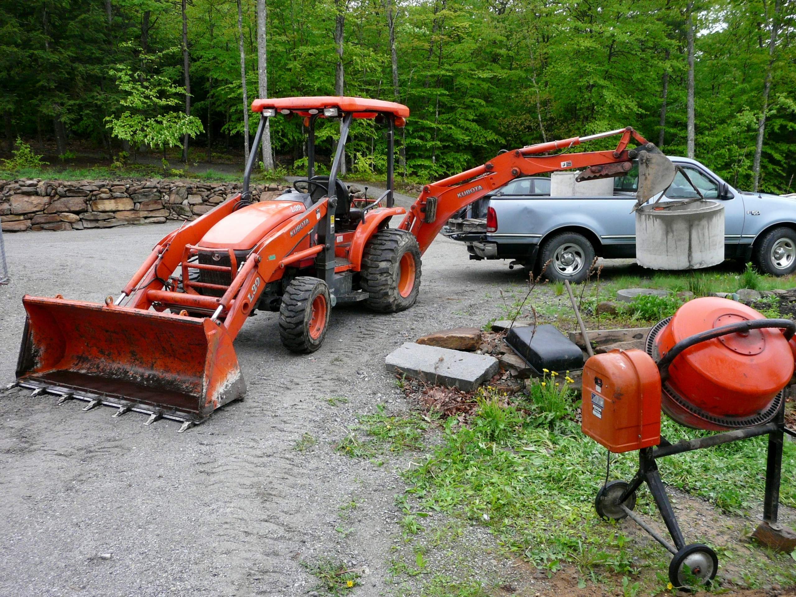

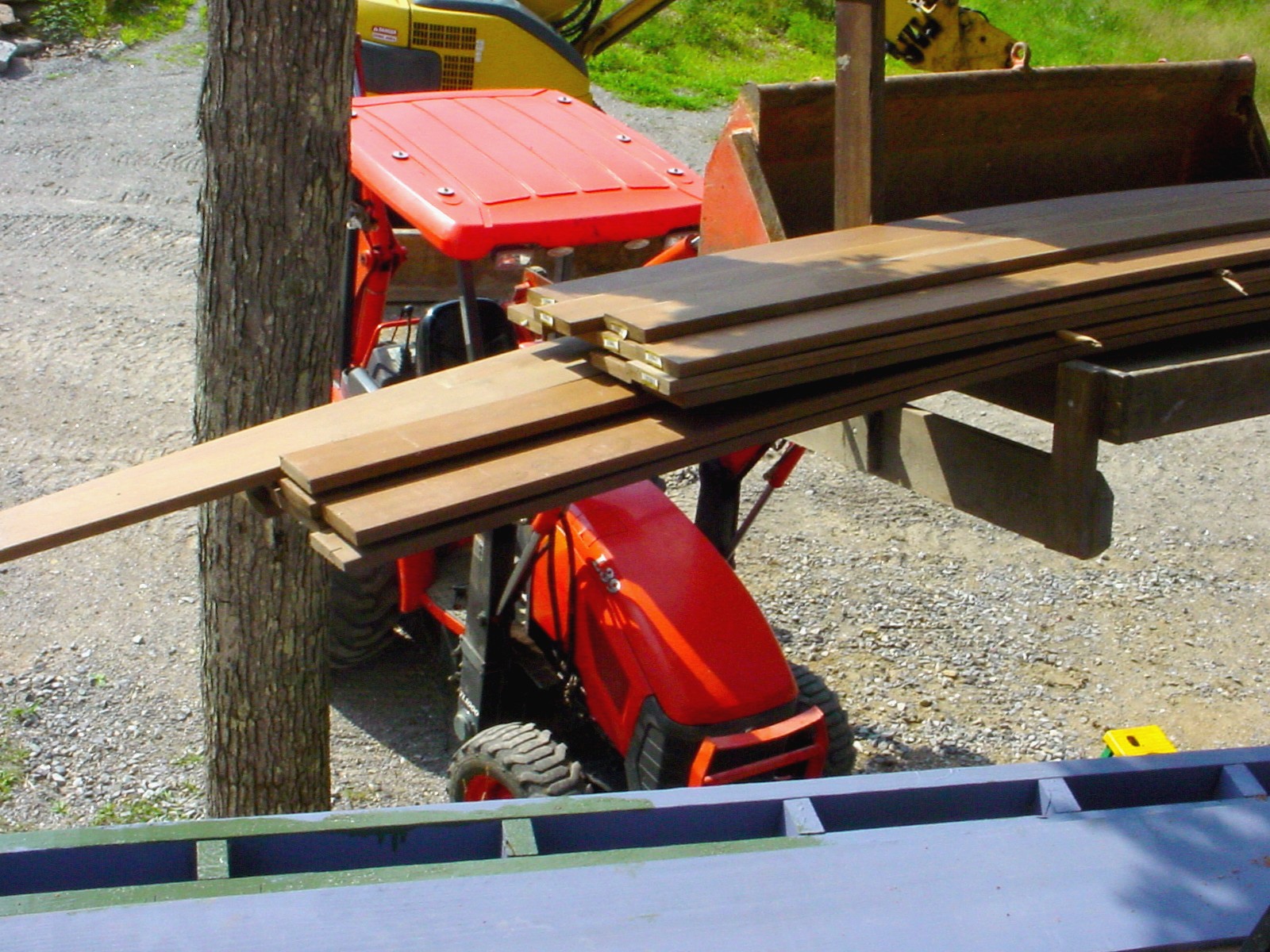

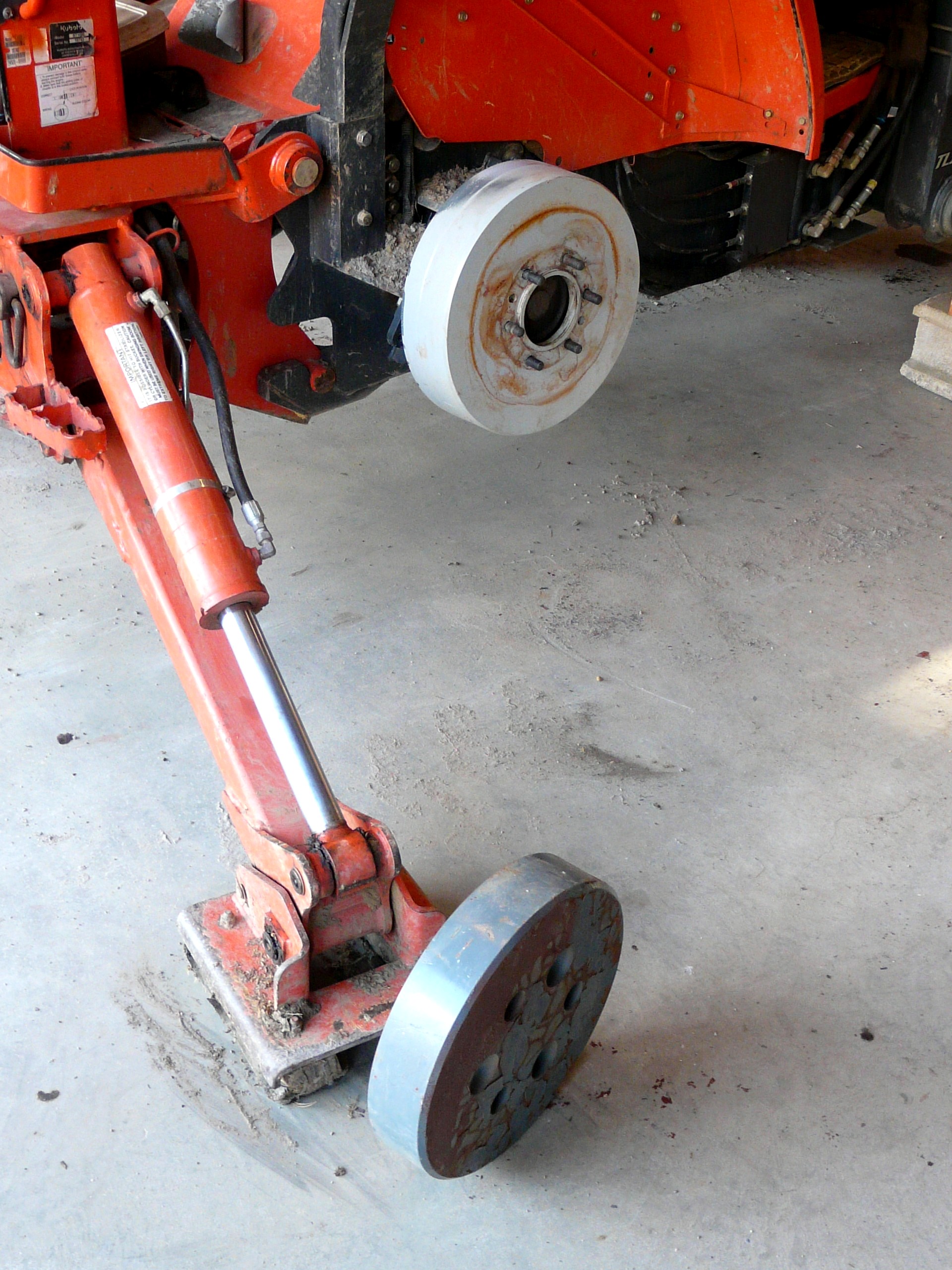

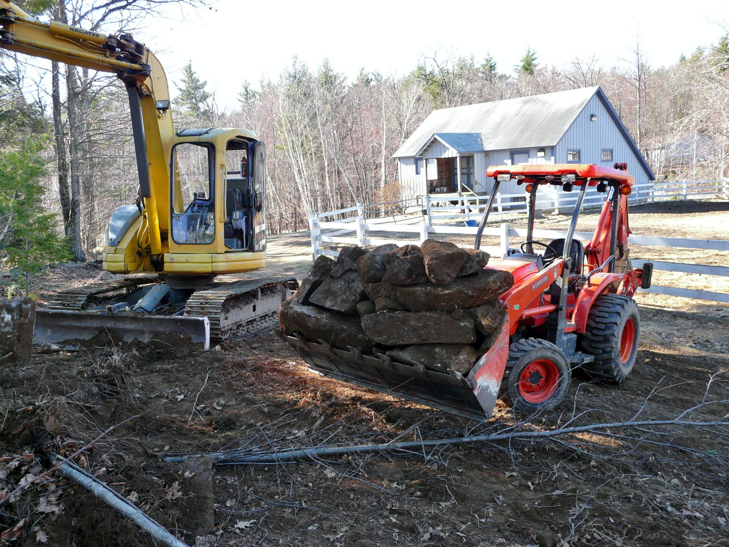

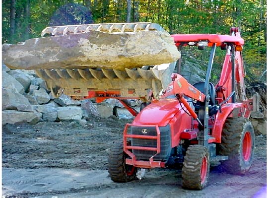

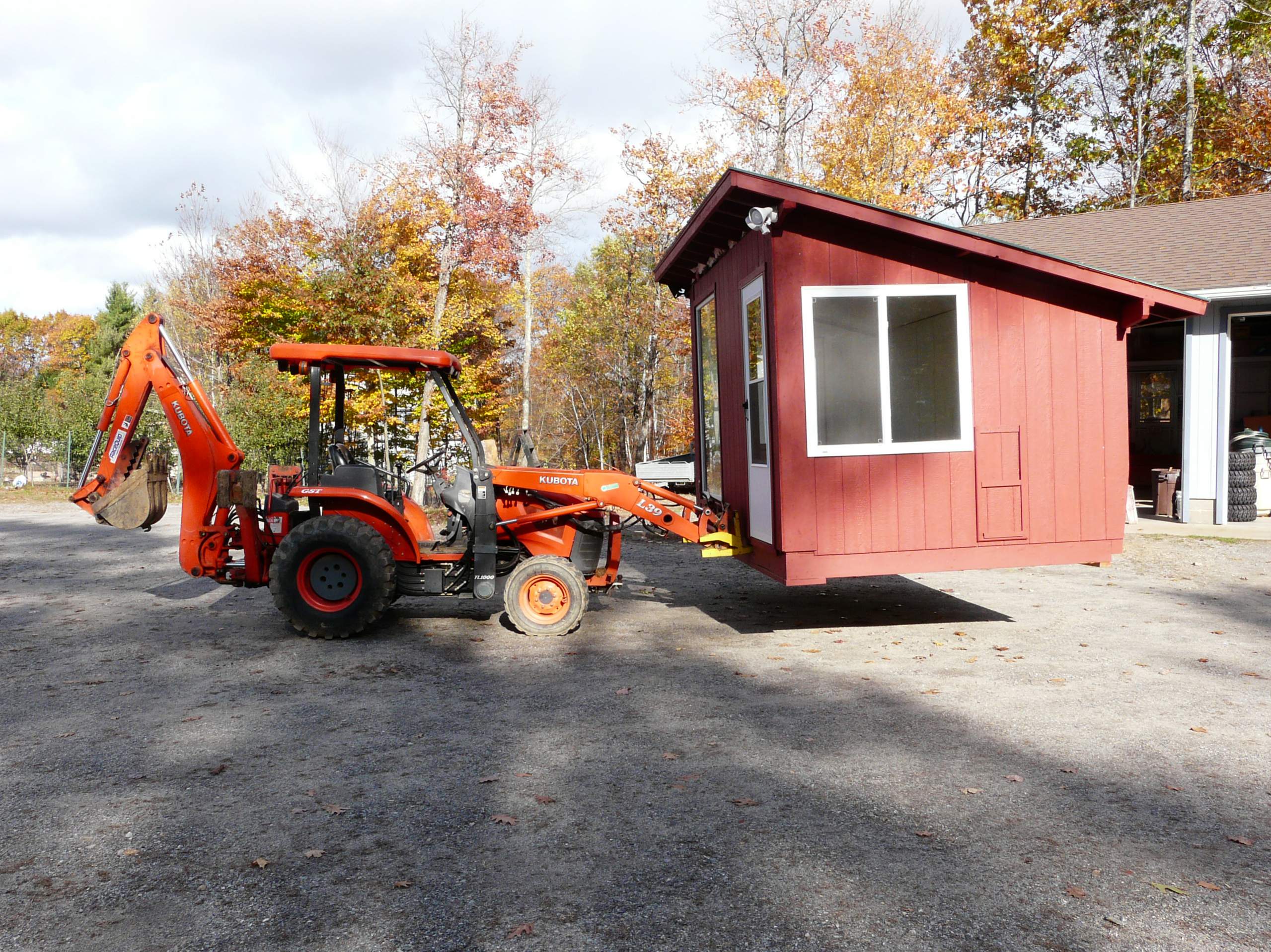

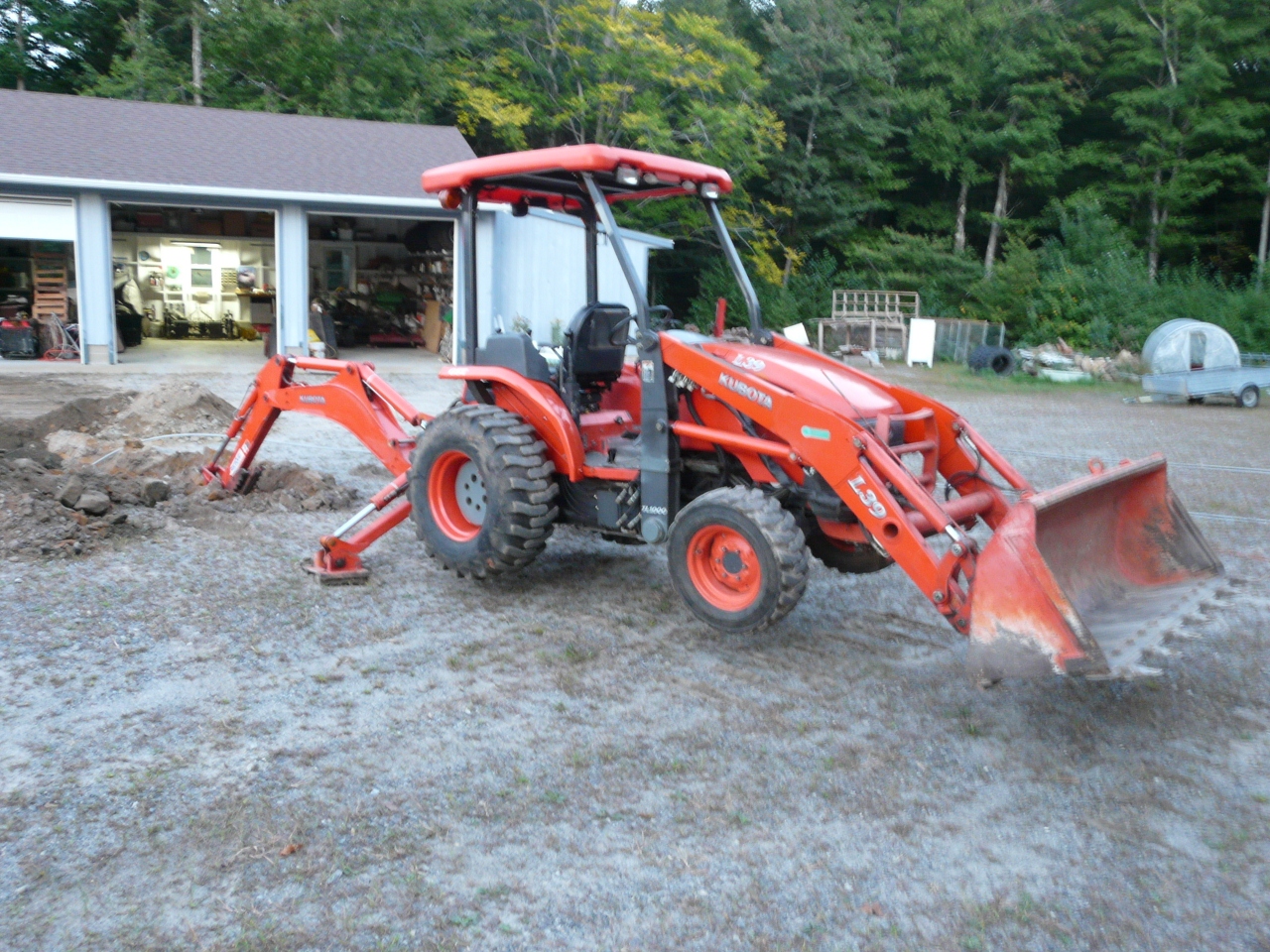

Wheel weights and the back hoe have been on machine for near ten years. Unless you need to keep the machine light weight, just ADD as much weight as you can.
I have 750 Lbs if inner and out wheel weights on my little tractor, plus around 500 Lbs of other stuff welded or bolted on. Just about the right weight to suit the machines capacity.
