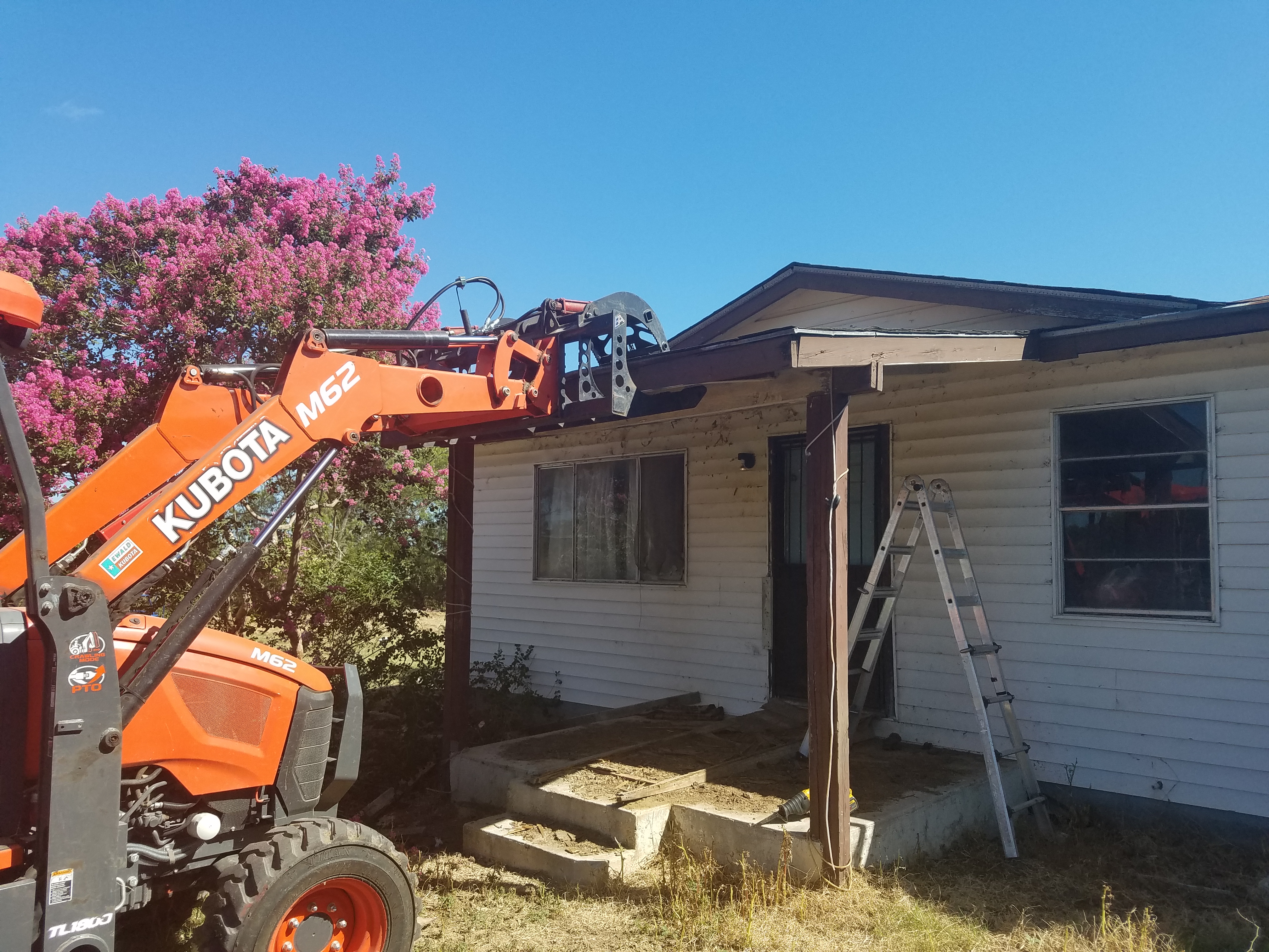

Doing some remodeling.

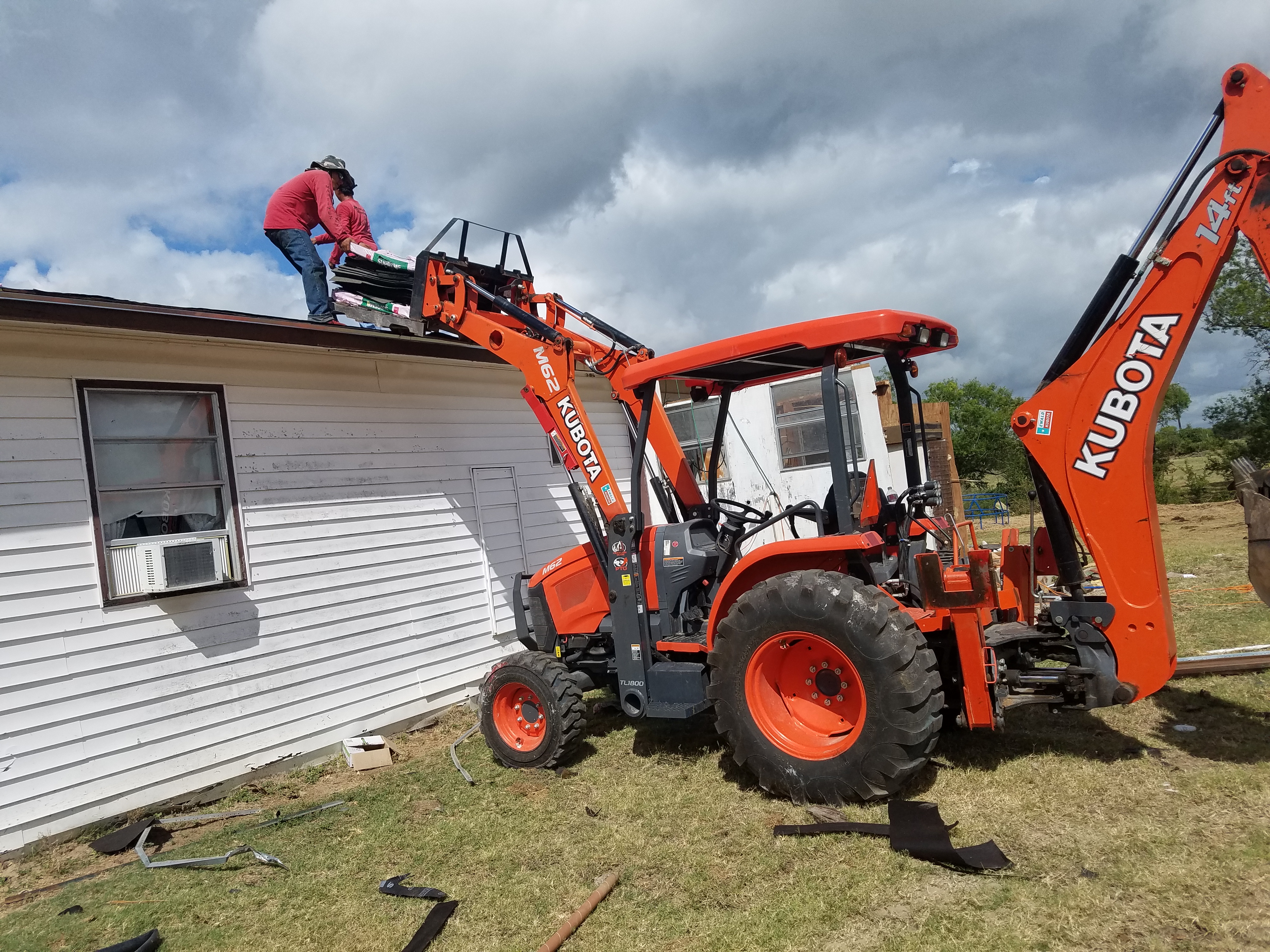

Handing the roofer shingles with the M62. Dont want them having any reason to come off that roof.
