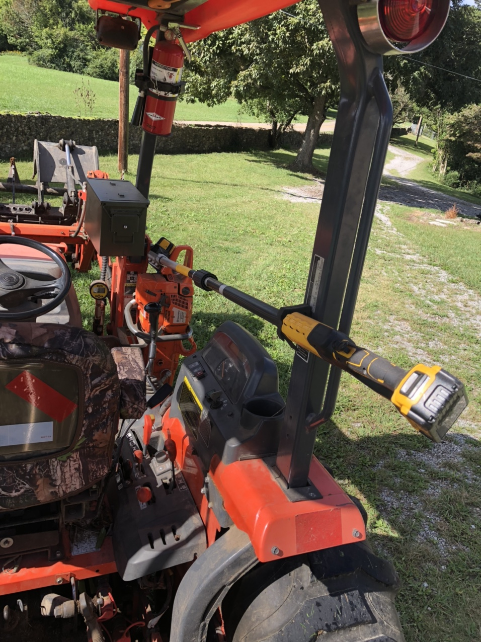

Who sez you can't teach an old dog new tricks? I'll put that one away in my toolbox for the next time... 👍
I don't think I have ever seen a tool box long enough to hold a 20V pole saw.:ROFLMAO:

Use a rubber tool grip to secure the polesaw. The M59/62 platform helps carry the tools needed when working on our piece of paradise. Moving several big limbs and tree from recent rains from the driveway. Love our winding green tunnel thru the woods but does require work. Kinda fun work at times.
