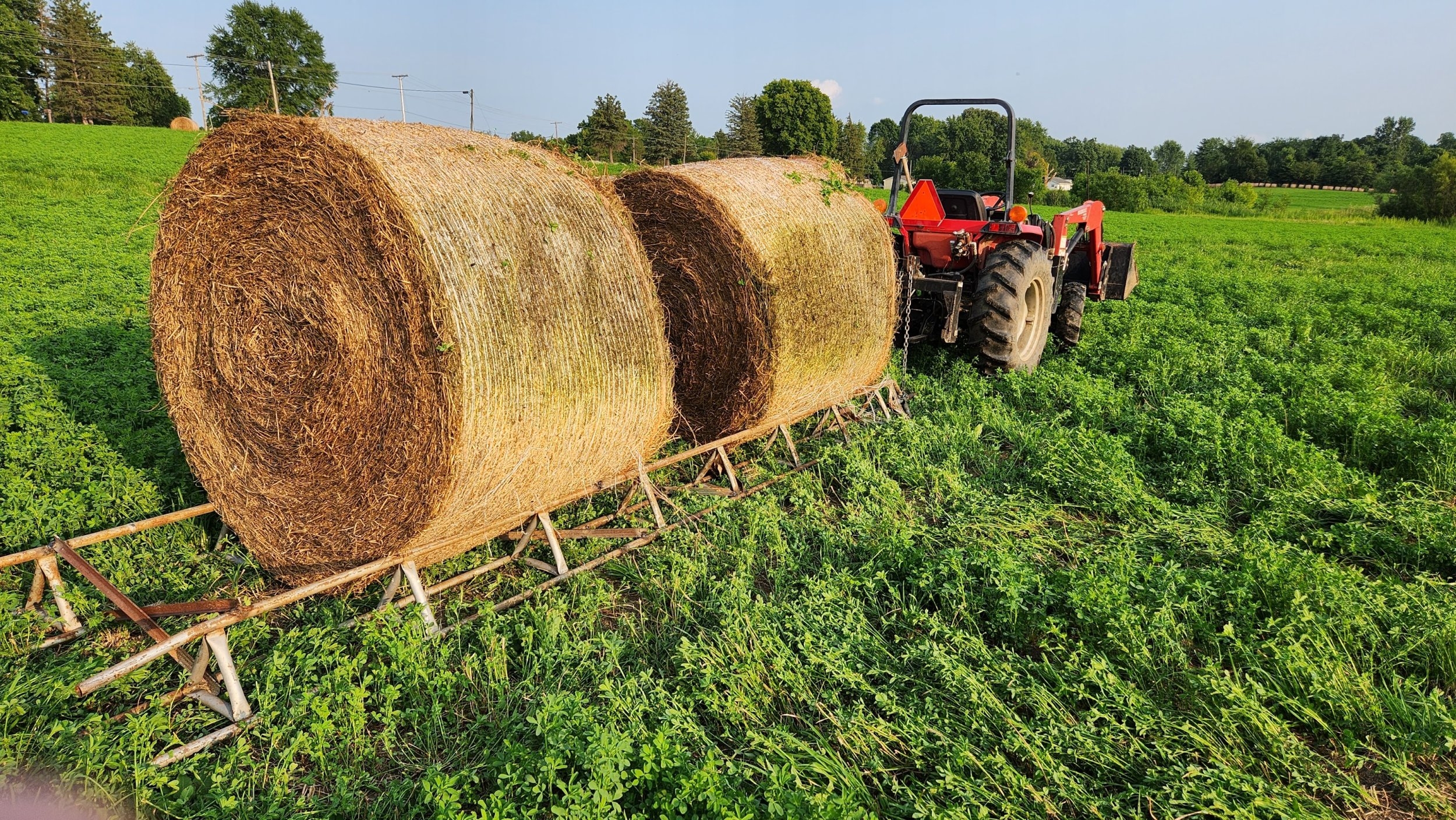

I built a prototype hay sled to move round bales that are too heavy for my MF1250. I'm having a 3rd year engineering class engineer something that should hold up much better. There is a local student run high school fabrication business that I plan on talking to about listing them as a product. If interested, you would be buying from them, I'm just facilitating the project.
The sled worked well for me. It didn't tear up the field and reduced my number of trips. I expect the final sled to carry 4 bales. How many folks are in my position with one tractor that is just a bit too small for hay?
Any thoughts on requirements that I should give the student engineers? How many bales? I'm targeting a 30 hp tractor. The hitch point should be high enough to use the 3 point hook without dismounting. Light enough to put on a trailer with a couple of guys. Short enough to trailer on a car hauler (maybe it's two sled chained together?). Maybe a rear set of wheels so it would work as a poor man's low boy.

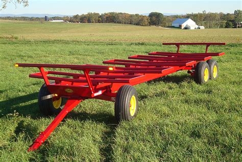

I'm confused how a sled (skids laying on the ground) is less stable than a wagon. That wagon in your picture is huge. Around here we mostly use smaller wooden bed wagons for squares and 5th wheel trailers for rounds. I'm using rounds, but not taking them on the road (just moving them across the field to the barn). In addition, what's dangerous about having kids design and manufacture a sled? There aren't any bales in the metal shop.
A bale is large. The center of gravity is out there. I assume that a "2515" is TYM 2515. A 2115 will not lift a 5x6 bale. My tractor is 2,700 + 1,000 bs FEL + 800 lbs filled tires and it is not stable with bales in FEL; I'd rather roll them onto the sled or use the forks on the 3 point. I can't load a wagon with the 3 point.

I use the 3 point to move heavy bales at home. I can't load a trailer with the 3 point.
The sled is much less expensive than a wagon, is easier to load, does less damage to the field, is safer (I had assumed, since it can't roll away on it's own and the bales are closer to the ground, but Torvy seems to disagree).
Yeah, I can see the usefulness of a hay sled if you don't have a FEL, or the FEL can't lift the bale. And it doesn't have tires to go flat!
I would add a rigid tongue to it so it doesn't slide into the back of the tires down a hill, or if you jam on the brakes.
I like your design with old TV towers, seems like a perfect use for them.

Your engineering partners probably have access to CAD with a stress evaluation package. Tell them to see if the runners are strong enough when you pull it thru a dip where it's only supported at each end. As I understand it, that's how long ships can fail in a storm- bow and stern each supported by a wave crest; middle of the ship sags.
Yah. As Junior year engineering students, they should be able to address these sorts of static and dynamic design issues. My tv tower based sled did not fail when only supported at the ends, but I didn't bounce it through a gully.
I have a couple of ideas of things for them to consider:
  • Who is the customer? (small hobby farmers)
  • What size tractor should it be designed for? (< 40 hp with a lightweight FEL, I'm imaging an 8n or at least bigger than a sub-compact.)
  • How long is it?
  • Does it need "skis"? How big are they?
  • Would a train of flat bottom sleds do less field damage (I'm imagining 3 car hoods chained together)?
  • Is one long sled better than two linked sleds?
  • How can the attachment work so that the operator doesn't need to get off the tractor?
  • What materials should be used?
  • What fabrication methods? (weld, bolt, baling wire?)
  • longitudinal or transverse loading?
  • What about adding wheels at the rear end for use on the road?
  • Consider the effects of stiction. (I haven't had any trouble with my 30 hp 3,000 lbs tractor and ton of hay, but beyond that is untested.)

I do see that sled destroying a lot of alfalfa plants however.
This is one of my concerns. I'll report back with pictures after my next few uses.
The first time I used it, it was less destructive than the tractor tires. It pushed the plants down, but did not tear them up and they stood up quicker where only the sled was than where the tractor tires were (it was hard to measure, since for most of the trip the sled followed the tractor tires). I assume it's related to ground pressure. The ground pressure for a sled is a lot less than the tractor, even less than the ground pressure of a bale. One test is not conclusive though.
