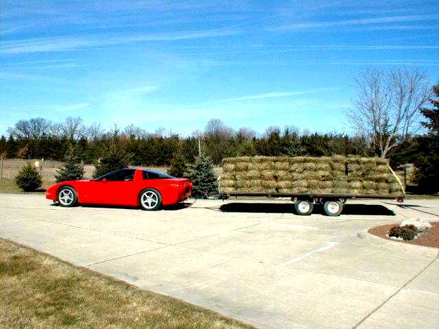

I have used a 4 place snowmobile trailer for that very purpose. Easily put 100+ bales on it with someone stacking them. The trailer is a 'deck-over' type so its one flat 8 x 16' surface. We used a backstop just in case. The nice part of it was being able to hook up a truck immediately afterwards to deliver the fresh hay, although we once took my red car with a load to Southfield for a special customer.
60 bales is a nice load: 2 double rows of 25 with 10 down the center. 2 cross straps and two end straps keeps things together. The double axle keeps the tongue load on my 14T to a light level. Only concern is very tight turns. I did not want to tear off an axle. The 14T has a center hitch option that is necessary. The trailer's low load floor means that the rear chute clears the trailer at all times with good overhang. Even backing up both the baler and the trailer together is a cinch, especially with separate L/R tractor brakes.
