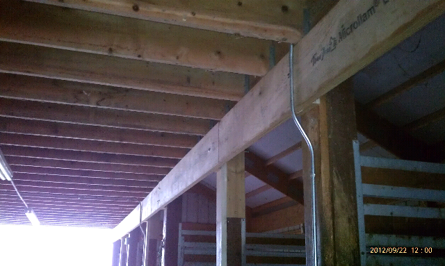

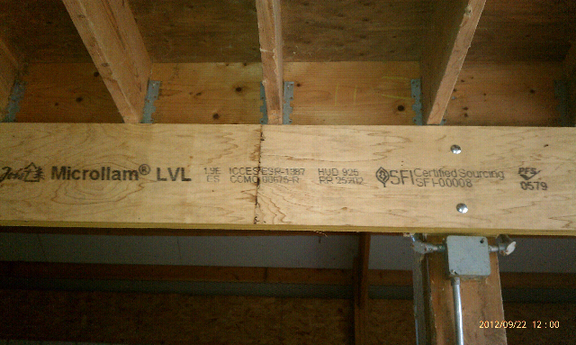

I stopped by my daughters horse barn last weekend. Here's Levi's repairs.
